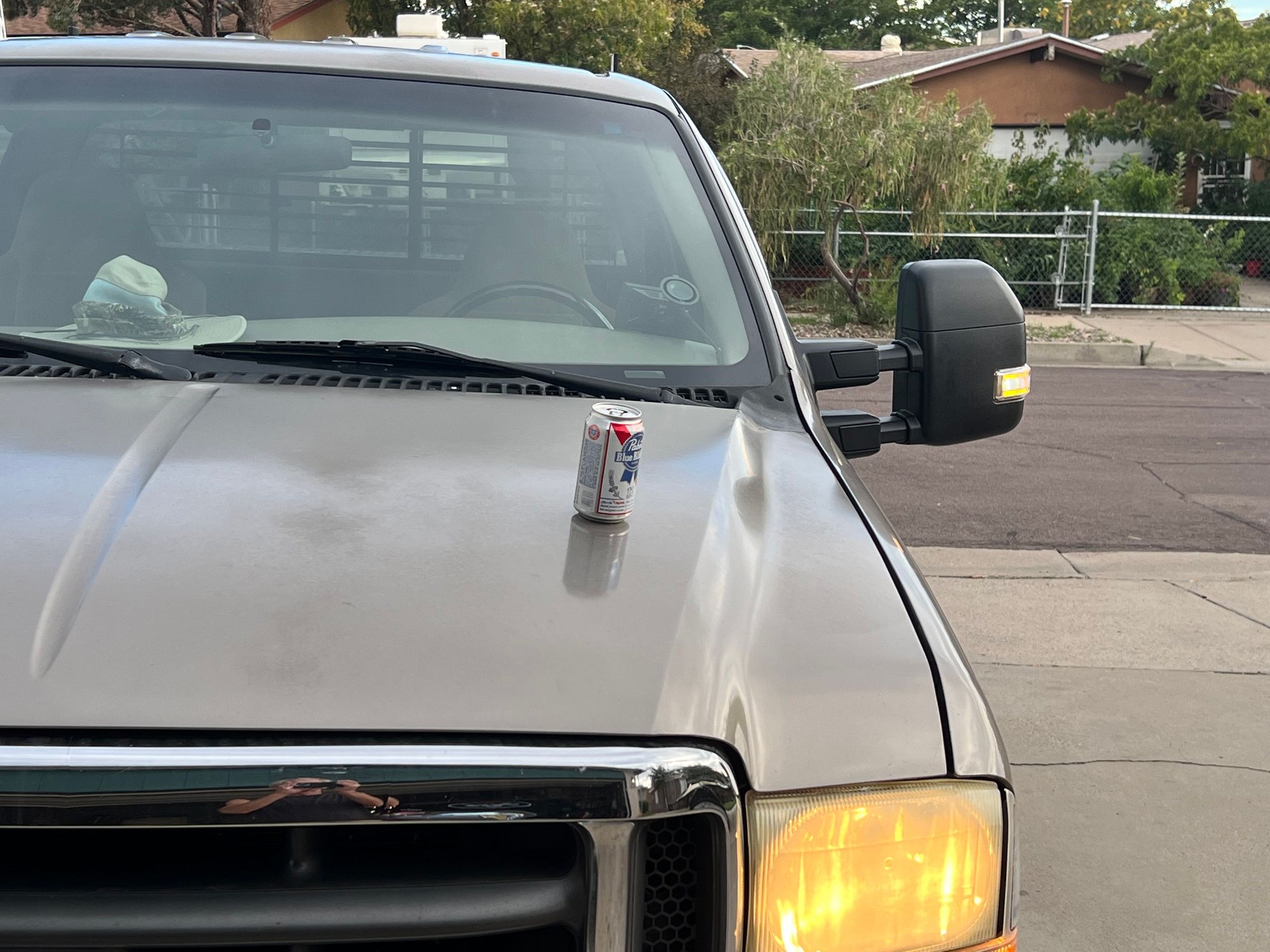

So i am playing with the idea of being able to turn on the markers and puddle lights with my fog light, now i am sure i will need to run this through a relay to keep from back feeding!?
So help me out here, what do i need to do to make this work

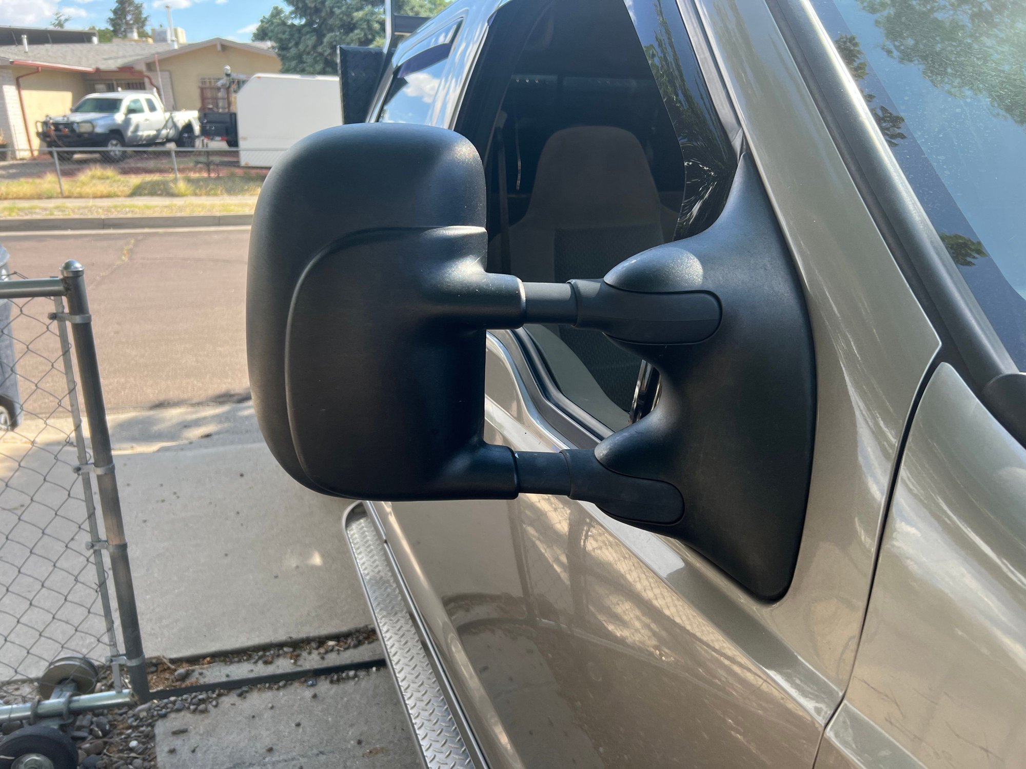

I wired the puddles to the door courtesy lights so they come on when you unlock the truck with the FOB...they're already on a timer. Do those new mirrors stick out anymore than the old ones from the truck?

Yes i did the same thing, and yes they do stick out farther great visibility
what i would like to do is wire the puddle and marker lights to come on with my fogs also, just not sure about how to do that, i would imagine that i need to inset a relay into the line ??

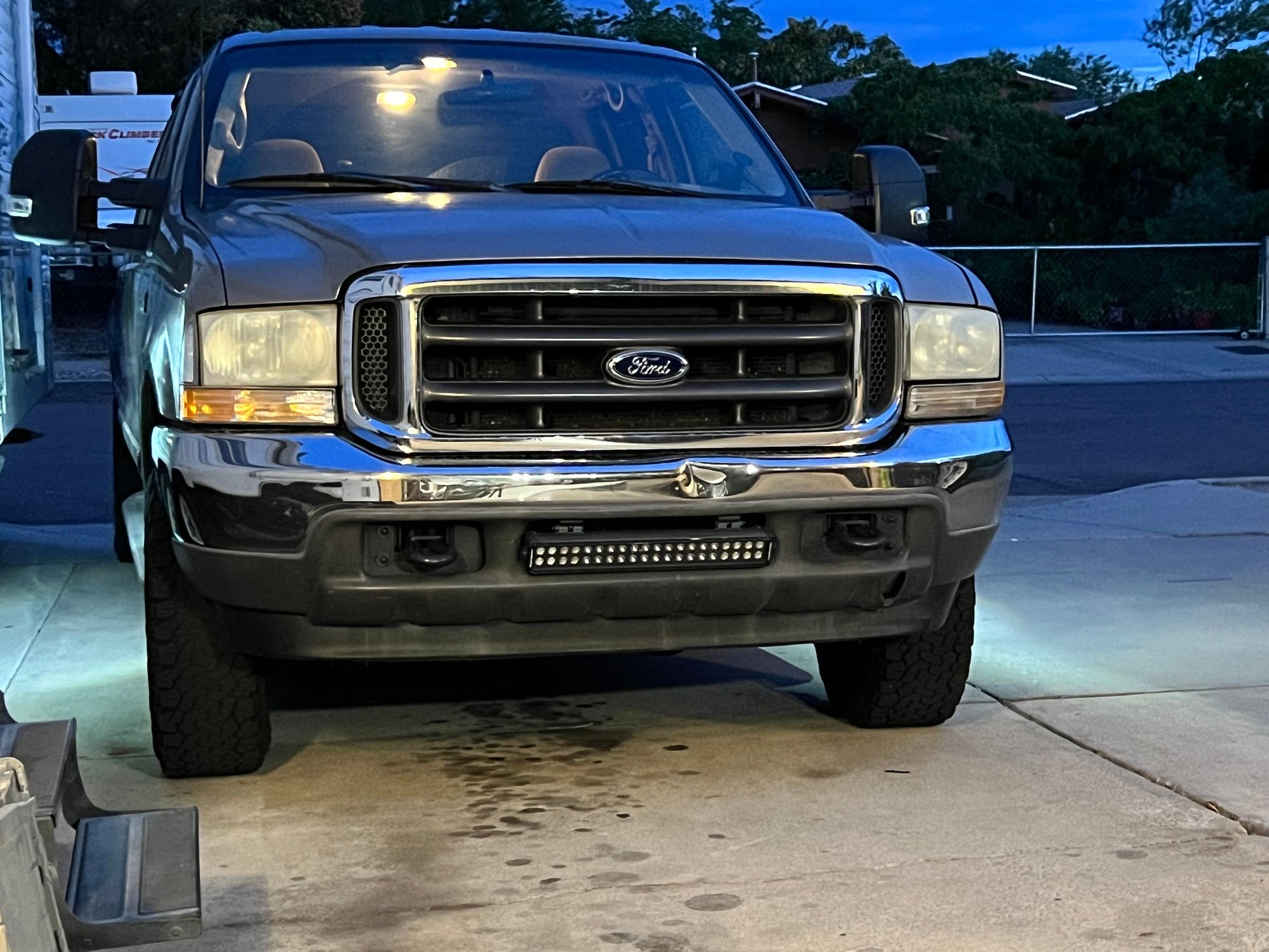

Same here, was surprised how bright they are, was sitting in the garage with the remote in hand!
Lights on, lights off, like a kid with a new toy! LOL

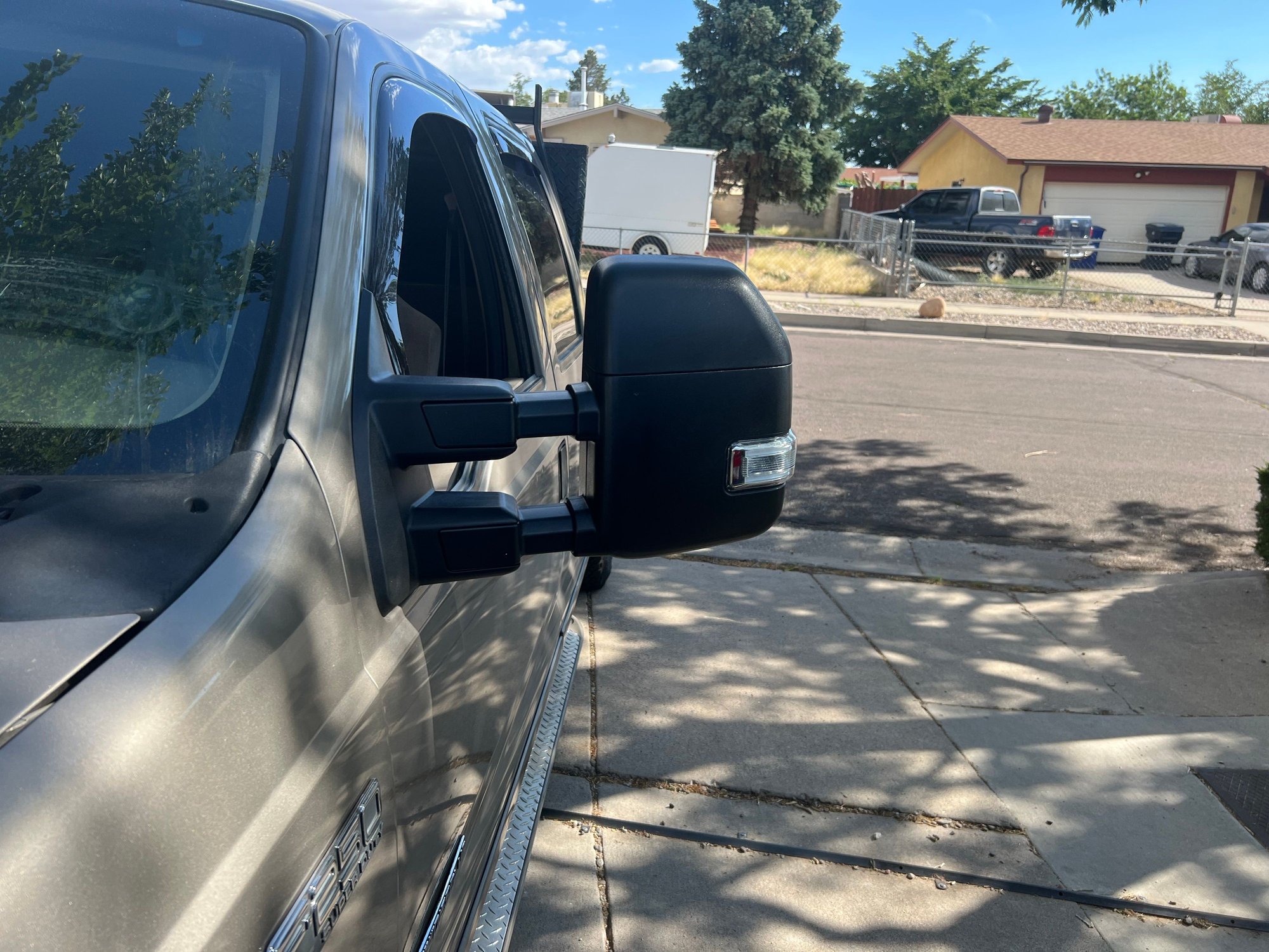

Do your mirrors have the aux white light that shines forward in the turn signal light also? There pretty bright also. I can see them shining in the ditch on mine.
I hooked them to a switchback led controller. So they are on all the time the lights are. Then when I put either turn signal on that side the white light turns off and the turn signal blinks yellow. Then goes back off and white aux light comes back on after turn signal is off.
So i have them hooked up so they come one with the headlights ATM, i have not watched them as to what they do when the turnsignal comes on, i would imagine they stay on, since i have done nothing special to any of it yet
