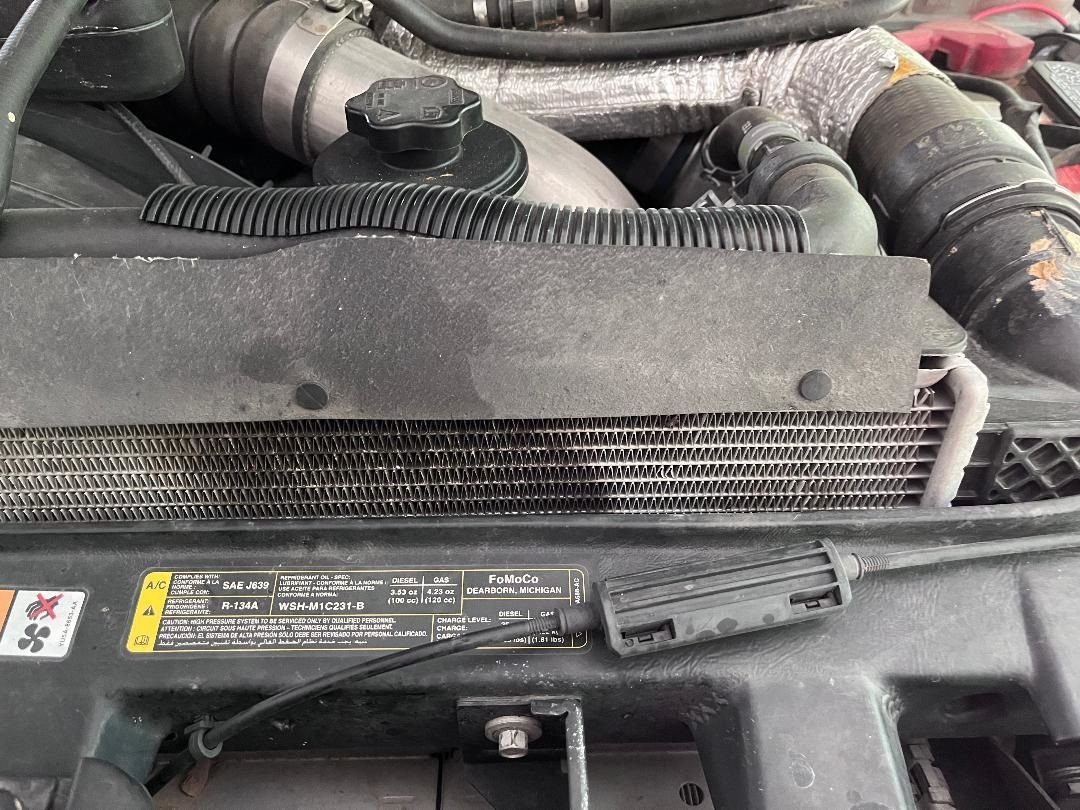

The third picture shows a stain on the radiator. Not sure what it is but I'm sure I've seen it before. The radiator was replaced new (Motorcraft) back in late 2018 by the Ford dealership.

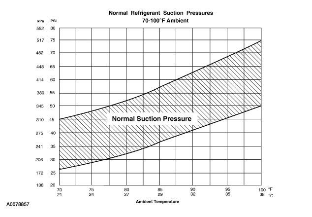

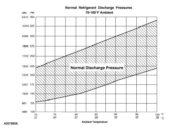

Pressure temperature charts for 7.3L F250.

A stain on the radiator if it's near a AC hose you have a leak. I can't view the photos. It might be my VPN don't know.Turmed off my VPN and ya your condenser is leaking. You will need to replace that and the dryer. You need to have a shop do this unless you have all the tools. You will need to pull a vacuum test because you don't want to have anymore leaks.

Looking at the graphs I think I misread it. Based on the outside temp I believe the suction pressure should be higher. to at least 40 psi. Maybe I should add some refrigerant.
