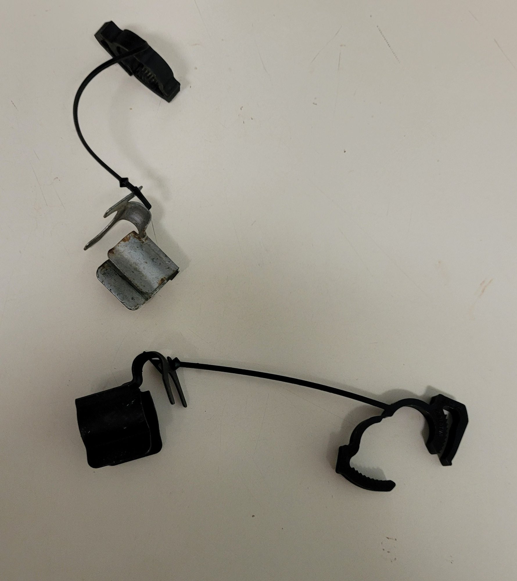

On my way to work this morning just cruising truck just shut down and I had to coast into a parking lot. There was a strong smell of gas and I found the blue fuel line in the pic had popped off. I put it back together but worried it might happen again. Is this connection supposed to have an outer lock on it to prevent such a thing? Made me buy a small fire extinguisher also.

It is supposed to have a keeper on it. Don't remember the part number off the top of my head but I am pretty sure I have one laying around.

Here's a couple pics for reference... 1996 351w
Edit, I see he beat me to it...

E7AZ-9A317-B
F6TZ-9A317-BA

It is a spring lock connector. The same type used on air conditioning hoses. I would have to say that the hose was either not fully seated or the spring tabs on the fitting are weak/damaged. Those clips shown in post #3 don’t hold the hoses together. If they did, you wouldn’t need to use a disconnect tool to separate the hoses.

Thanks for the replies. Going to order one, Ford put them there for a reason.
