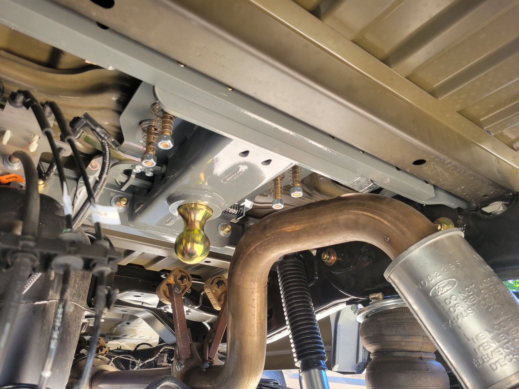

I have towed a lot of miles with shortbeds. Off road too. Never a problem. Use the Ford factory fifth wheel hitch.
The blue '22 has airbags. The white '21 doesn't.

I really like the B&W setup. It's not a slider, but they make them too. Installed myself in the driveway, took the spare out, drove up on 6" or so of boards, and installed right in the driveway. Couple bolts were hard to reach by myself, but took probably 4 hours.
