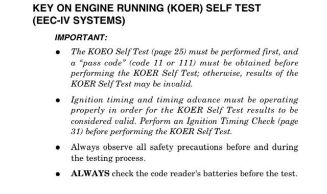

Throw those test results in the trash. It appears that you only ran the KOER (engine running) test? If not, what did you get from the KOEO (engine off) test? What did you do to repair the codes in the KOEO test and did you erase the codes to get rid of the stored codes? You need to repair any KOEO odds before moving on to the KOER test.
From the Innova 3145 owner’s manual:
The tests we ran were Key on, Engine off, so I am not sure how your comment applies here. I don't own the code reader in question, so I had to rely on the fact that my friend said he knew what he was doing. I have my own code reader on the way from Amazon now, so I guess I will read the manual and start the process over when it arrives.

Understood, but My4Fordtrucks post #3, was straight from the Innova book/manual, and 2 of those codes were KOER codes (12- throttle goose, and 67 -Neutral Drive Switch (NDS) circuit open; A/C or Defrost on (Manual) during test (operator error), was why suggested clearing codes and drive then retest, sorry for the confusion.

I said that because you posted engine running codes. You wouldn’t have received those during an engine off test. The there is a section in the code reader manual that states how to clear the codes.
