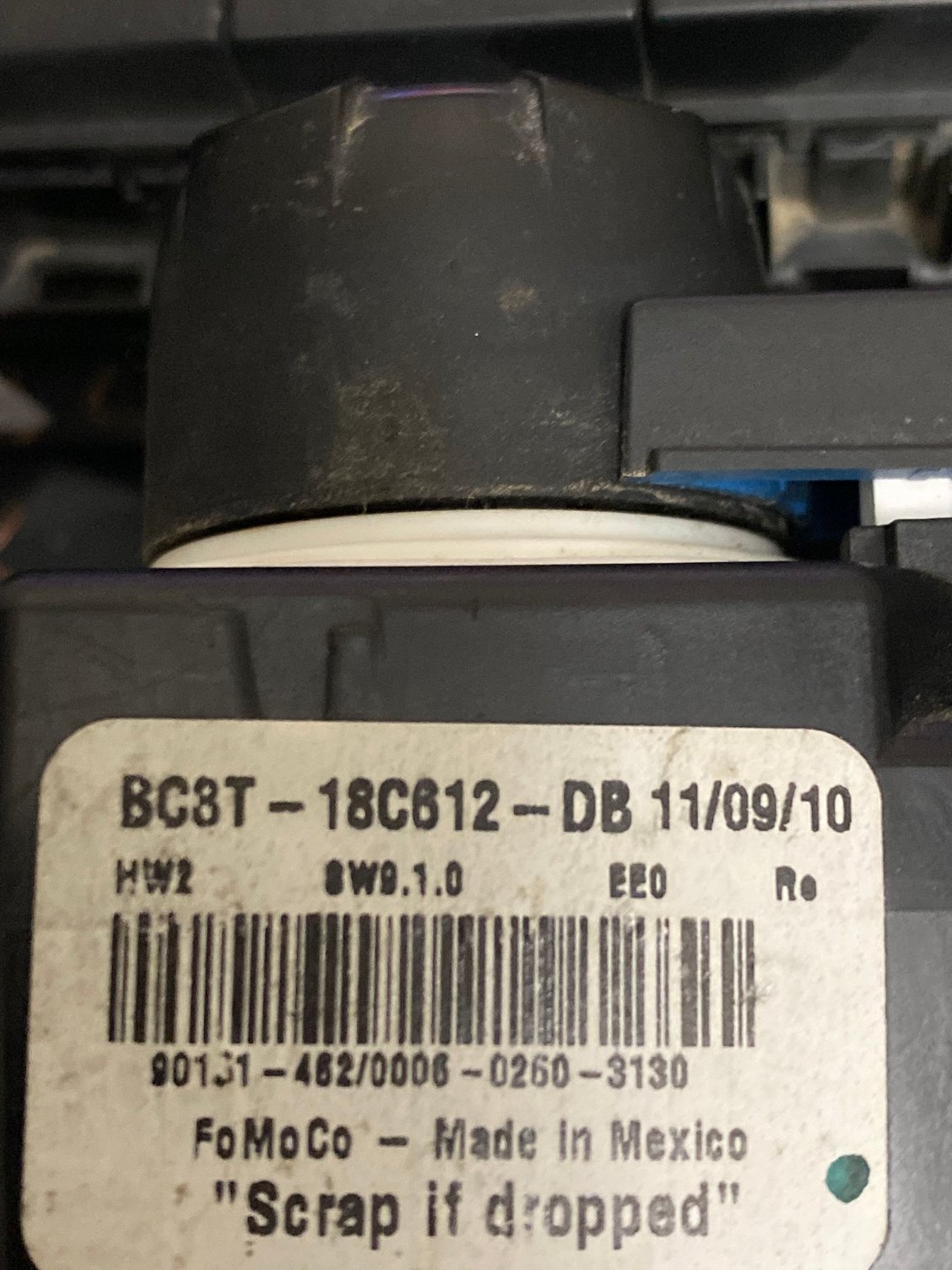

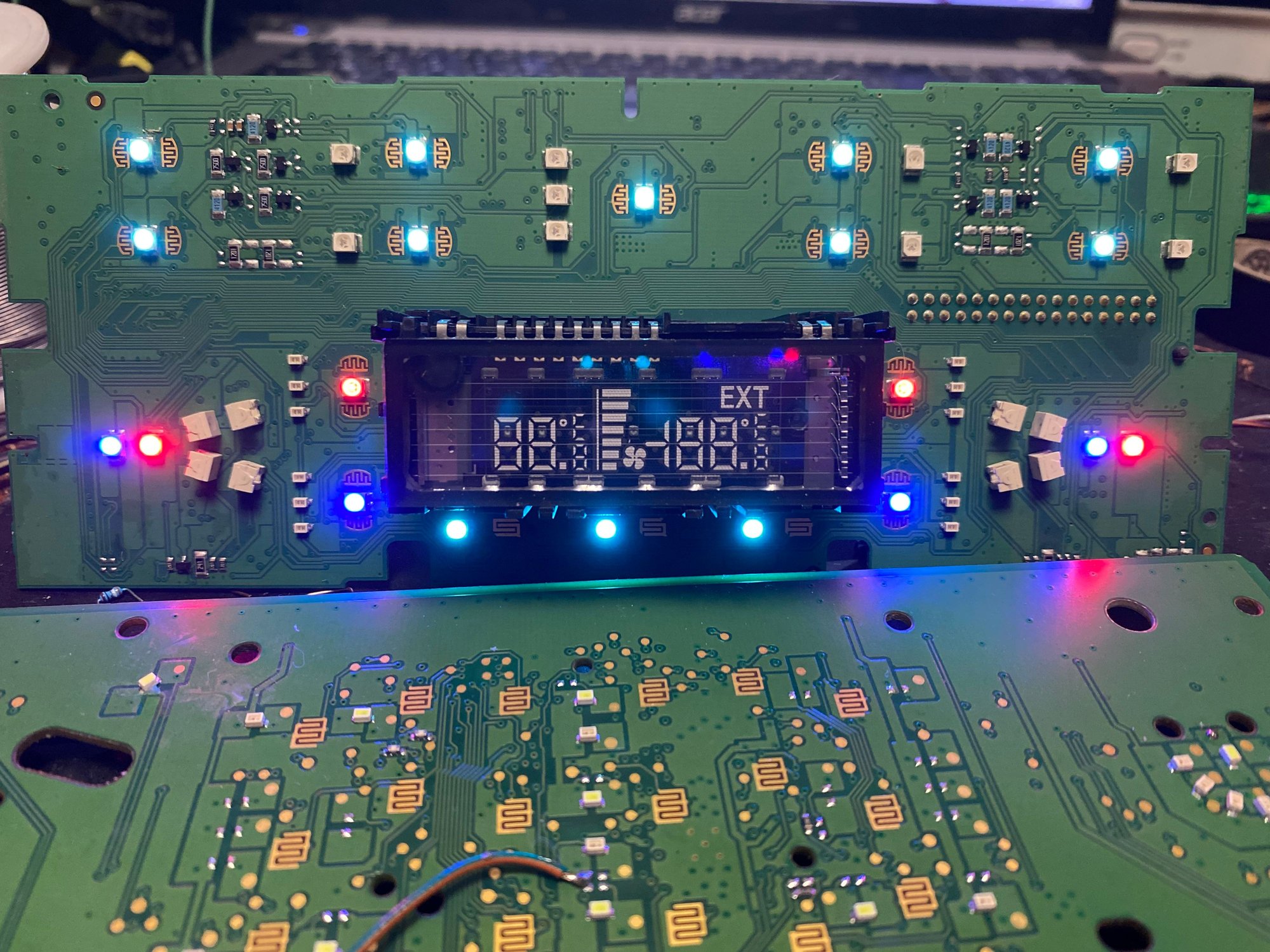

Is it possible to replace just the display piece on here? It is very hot to the touch and has melted my display cover for it. Can anyone guide me on where to get this? I can’t seem to find any HVAC modules that have what I have. it’s a 2012 F250 lariat, any search I make the display is always missing something. Thanks in advance

The screens are not user replaceable, they are soldered in and your HVAC controls has something else wrong with it making the heater wires in the screen glow. Even if you could find a new screen and swapped it, you have to figure out what failed that cause this fault.
Your best option is to replace the HVAC controls. Unfortunately these appear to be expensive units from what I could find $800-$1200 on eBay.
