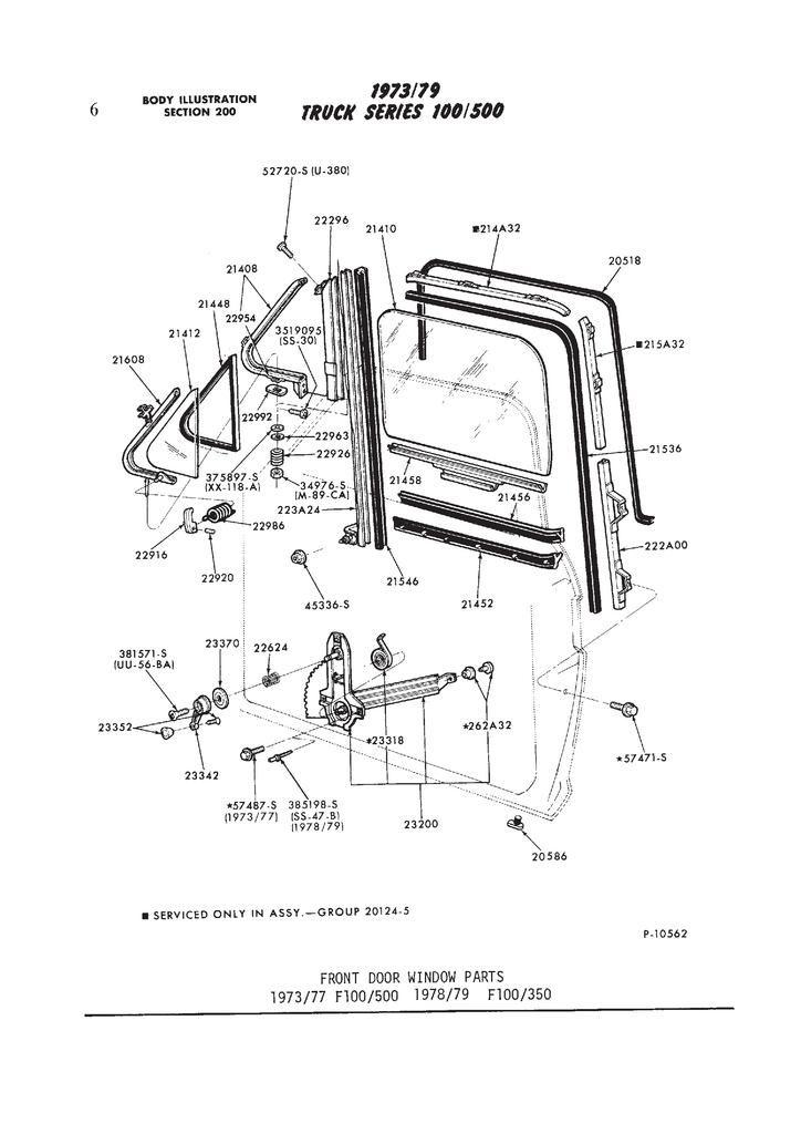

I konw part compatibility between 73-79 is wide. I have been searching for some doors but out of all the yards around me there is only a 1974 F100 supercab. Would I be able to rob those foors for my 77 F150? Or are F100 / F150 / F250 body components different enough.

All 73-79 doors interchange.
Other than the header panel for the square headlights there isn't much of any sheet metal that won't interchange. with the moving around of emblems and such you may have to drill or fill holes but everything fits.

X2 on 73-79 F100, F150, F250, F350 door are all the same. Even 73-79 500/F750 are the same, except for the thumb push button door handle. Instead of a lift up. And 78/79 Bronco doors will work along with all the front doors and all fwd sheetmetal.
