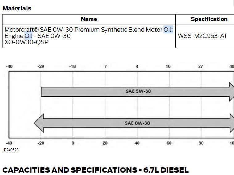

Haha, search for oil, and tell me out of the 2000+ posts that contain the word oil are the ones you're looking for? I found this one that way. Trying to remember why the manual says use 5-40, why I have two partial jugs of 10-40, obviously from my last two changes, and why the parts store wants to sold me 15W40, and if its ok to use the partial jugs to top off after I change the oil.

From the manual which is quicker than a search sometimes. Why you have 2 partial 10-40, didn't look at the manual?

I have 2 partial 10W-30 from previous changes. My question was more of why the parts store gave me 15-40, and said that was what is recommended. I guess according to the manual, it is correct. It doesn't get below 20 degrees around here any time soon, but could get to low teens a very few times, usually around February.
My point was about using the search, that was the struggle.
But yeah, search for oil, pages and pages of hits, most which where the back and forth about what brand/syntetiic, back and forths, lol.
I searched my manual for oil, and after clicking through the links that came up, finnally found the right spot. lolol. Don't see an issue with mis-interpreting this as being NOT for the Diesel, even though it says it in great big letters right under the image. hahaha. Yeah, I caught it, but damn, they really could have made a better manual. Like keep which engine you're talking about right above the image. If I made this mistake, I'd be qualified to work at a dealership, lol.

The chart your showing is for a gas engine, 5w30.
