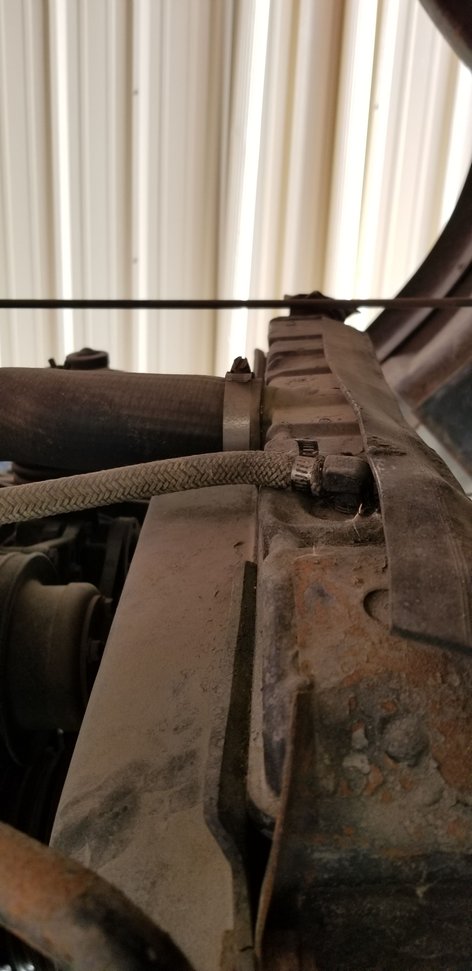

Hey Brother, first off I would say that you do NOT have the OEM radiator in your little truck. I have every shop manual for them from their inception in '57 to the last 8000 model and they ALL used a remote tank to facilitate service thru the "hood" located behind the passengers side seat back. The capped of 1/4 pipe is the balance hose that runs from the top of the radiator to the res'tank. That tank is also the expansion tank as you want to keep it no more than 1'2 full to allow for heat expansion of the coolant. The balance hose allows for the ease of fluid to rise and fall in the system. Yours not having that would push coolant in to the tank but it would have a hard time returning to the system until cooling contracti0on drew it back in. you "burped" a little fluid is all and I doubt you have a real issue. IF the radiator cap neck has the overflow tube sticking out of the side you can connect THAT tube to your capped fitting and you would be good to go. I have attached a couple of pics as to what the OEM setup is like.

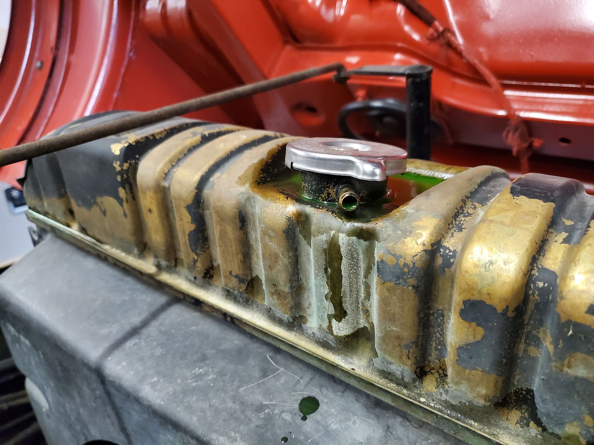

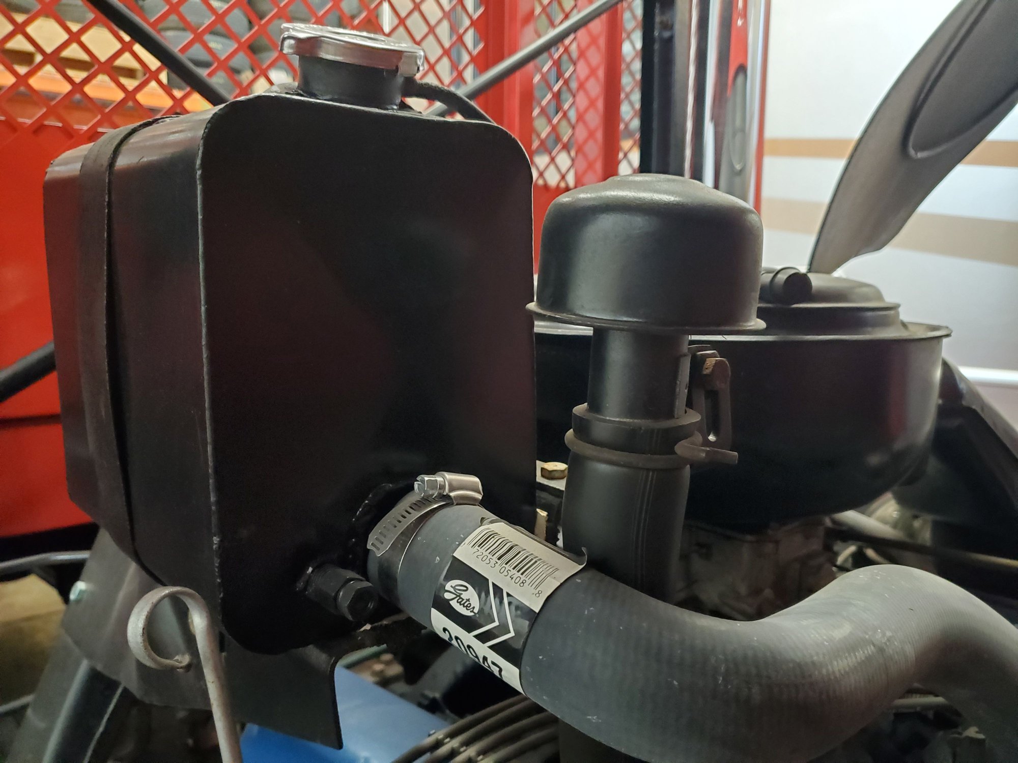

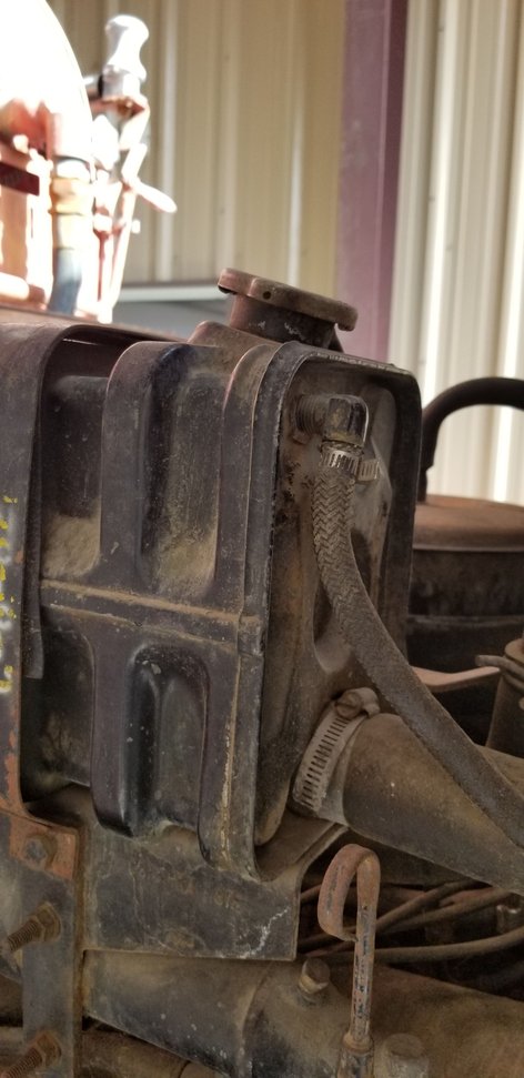

AallynnP, You may be correct that I do not have the OEM radiator in my "little" truck. It seems to fit correctly with no obvious modifications, which at first made me think it was the correct radiator. In looking at the service manual again, I am wondering if the original radiator might have been replaced with one from a F series that doesn't use the supply tank. You are probably also correct that I do not have a real problem. This is not a truck that will be driven a lot of miles, I just don't want it puking coolant on the floor, where the cat might get into it. The capped fitting on the supply tank is near the bottom, not near the top like yours. I wonder if that would be an issue, if I plumbed that to the overflow fitting on the radiator. I will probably just try the recovery tank and see what happens.
I will try to post some pics of my radiator and supply tank.
