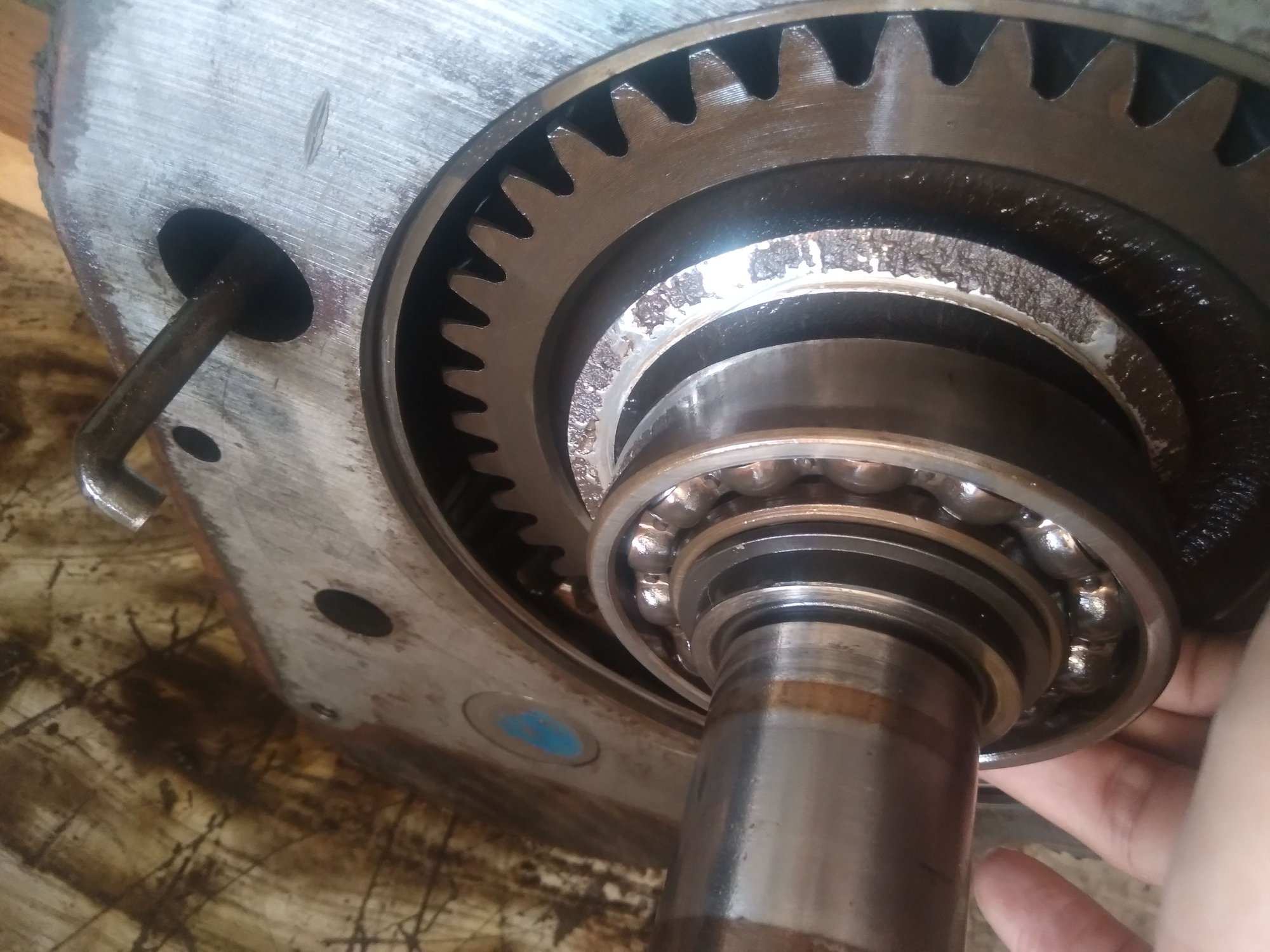

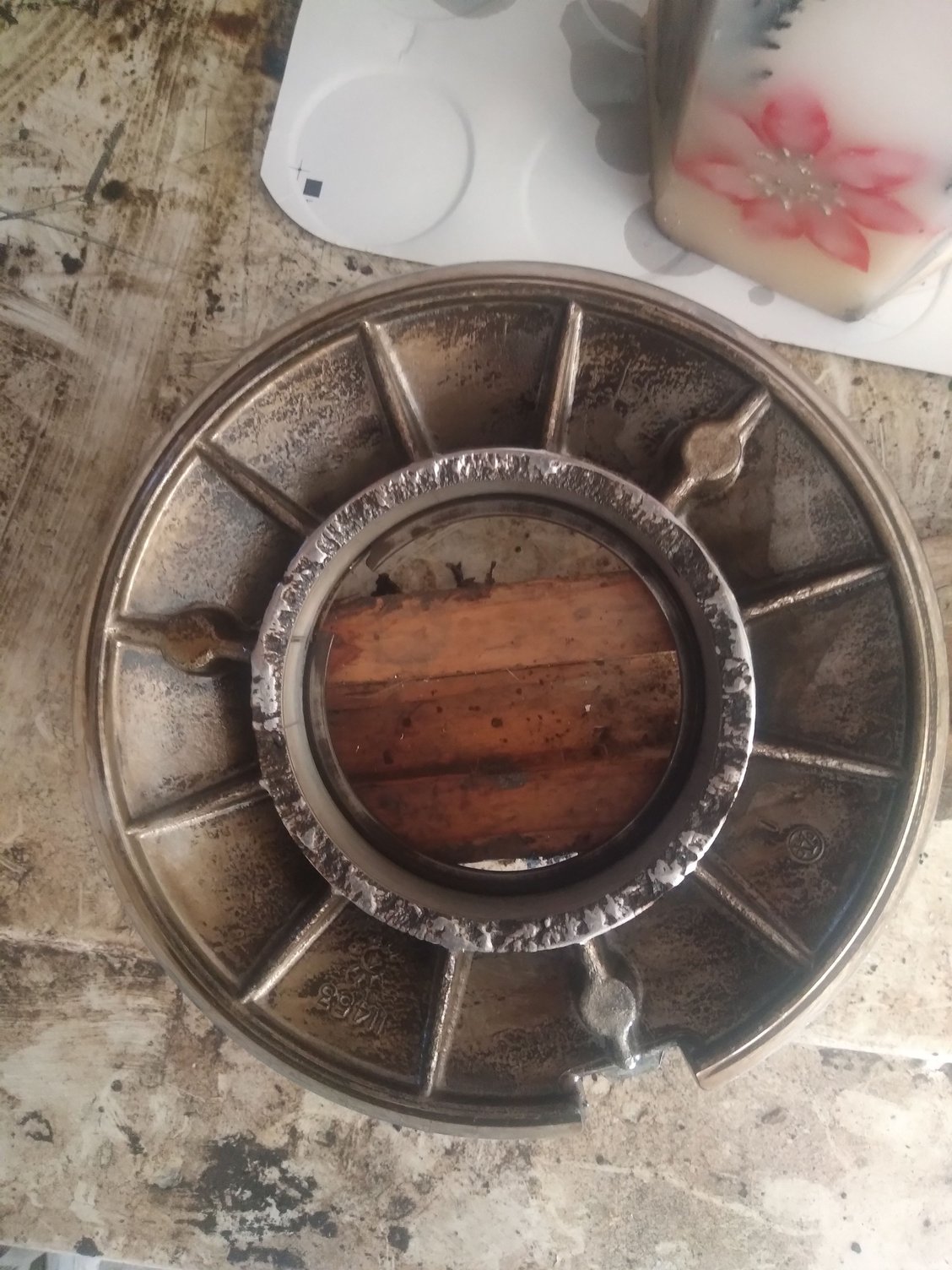

Well the aluminum bearing suppost between the range box and the chain box has broken the ring off. At a loss for ideas right now

So my intermediate shaft support is broken, any ideas im not finding anything in stock
