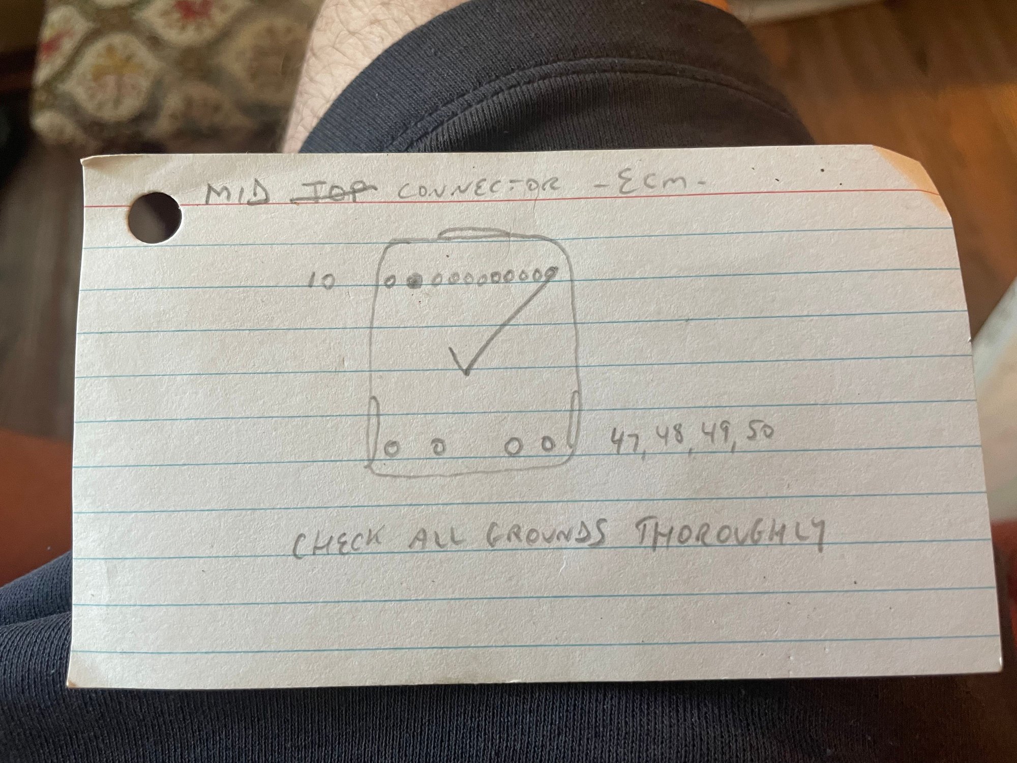

okay one last experiment today was testing all the grounds.
i looked at all the connectors for the pcm in the book and i found 5 of interest. because how could the pcm create a ground? it cant, it has to create continuity to a physical ground. so that is what its not doing for the ac relay. i went ahead and tested all of them and unfortunately they all passed!

A PCM ground won't cause your specific issue, it would cause widespread problems.
Go back to post #8. Did you check that circuit between the PCM and the relay socket? If you have continuity there, I'd conclude the PCM's output driver has failed.

"Did you check that circuit between the PCM and the relay socket?"
very much so. great continuity.
"If you have continuity there, I'd conclude the PCM's output driver has failed."
yeah.
