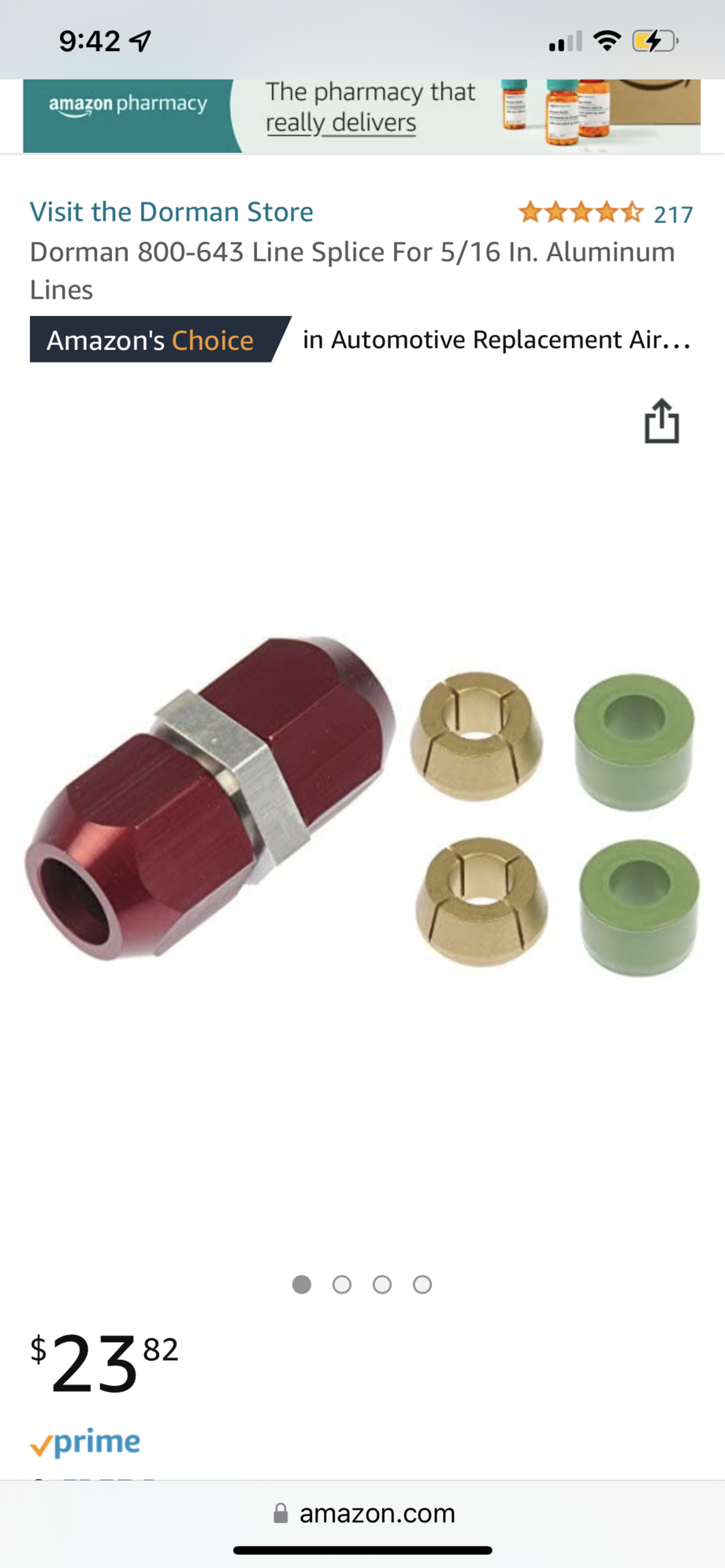

Rockauto has the lines or look for the Dorman repair compression fitting in the dize needed

Yea. Saw those on Rock Auto. Just wasn’t sure if they were the correct ones. Need the 3/8” line. Maybe I missed it but I didn’t see the size listed? Thanks all
on rockautos website they are listed in catagogries of "Suction Line low Pressure compressor to evaperator " and "Liquid Line condensor to evaperator"
the" Suction Line Low Pressure compressor to Evaperator " is the larger diameter line. ( a little confusing because the flow direction of that line is evaporator to the compressor )
the "Liquid line" is the high pressure smaller diameter line that goes from the condensor to the evaperator

Thank you. That’s what I thought on the line sizes but wasn’t sure. Just had a friend of mine text me about an ac shop within 3 miles of mile that I didn’t know existed. Said he had them make up a set of lines for his and they did it fairly reasonably. Going to stop by there tomorrow and see what they say.
