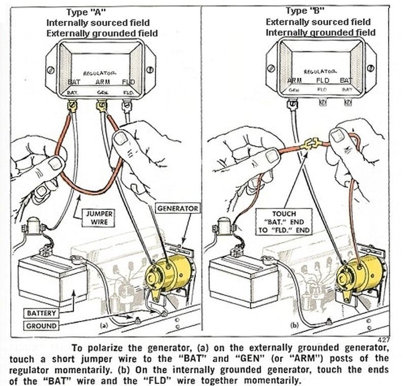

One mentioned one thing though I am curious about is how you polarized your generator with the wires at your voltage regulator. If that was not done correctly your voltage regulator could of been damaged and the contact points inside of it are no longer making good contact. Normally on these Fords to polorize them you remove the battery and the field wires from the regulator to isolate the regulator out of circuit and just touch those wires together. You should get a small spark and then you are done.
Heres a handy diagram, use the one on the right.
Use the one for type B
