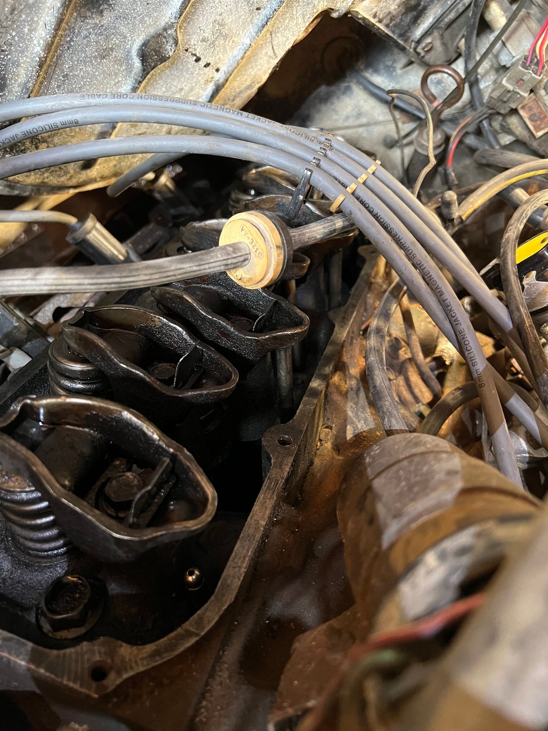

New to me 1979 f150 with a 351m. Just pulled the valve covers to find 2 dropped push rods on #1. Gonna pull the rockers and try to fish them out. Assuming they’re not bent, is a valve job my next step?

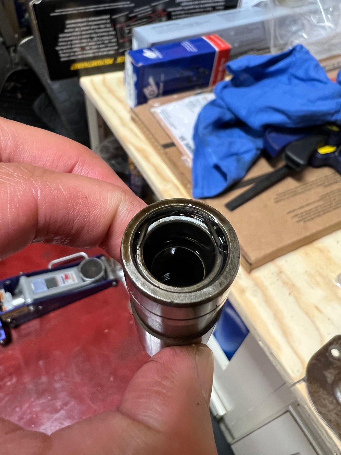

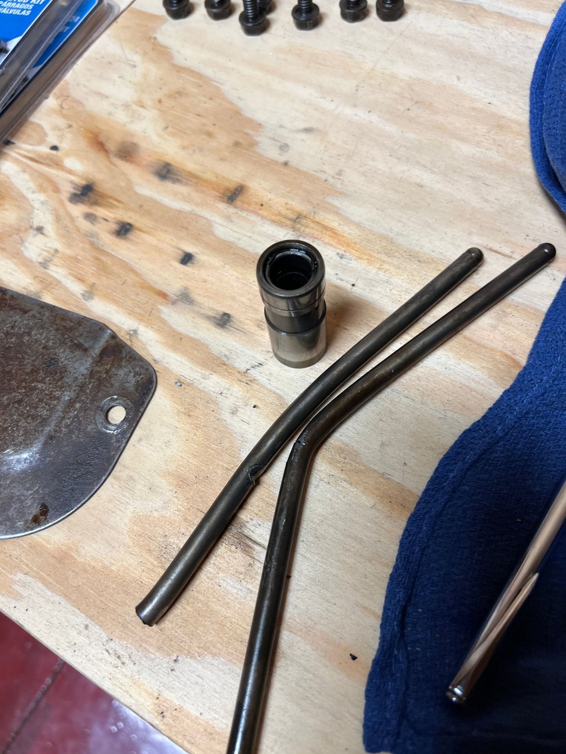

Found those pushrods I was looking for. Fished out both with a magnet and the exhaust lifter. Looks like the top of the lifter is missing somewhere, as is about 2” of one of the push rods. I tried fishing around with a magnet but didn’t find any other pieces. Looks like the intake is coming off.

That's extreme. check the valves, I'd figure on pull the head.

I would think more like they were floated and the piston hit them, if that's possible with your pistons. even if your lifter locked internally fully extended it wouldn't cause any damage . it's possible the lifter came apart and the push rod got in the wrong place and was destroyed causing damage to the other in the process.
One thing is for sure, to destroy push rods like that it came up solid on both ends.
