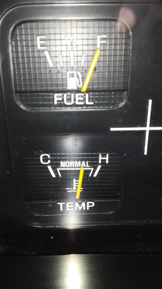

Ok, This morning I swapped out the clutch fan for another new one and the one I took off was under warranty. Soon as I started the truck the fan had that sound we all love to hear when it is working. I did not put a different gauge on it so sorry Dave. I waited until the heat of the day to go for a test drive. I went on a 50 mile round trip test drive so if it was going to over heat it would have way before this with the old fan on. I took the two picture as soon as I got home and open the hood with it still running. So the bad new clutch fan was the problem. I want to thank all of you for your help. You too Dave

1949, looks like you got it dialed in! When your guage is pointing to the A you are A-OK!
I dont like the needle being that high, between the R & M is where I like it.
You may want to replace the sender to see if it will drop the needle.
To throw sand in your face my 300 needle runs just to the left of N on the cold line.
If I sit for say 15 min with the AC on and it is in the mid 90's it will climb a little just below the middle of the gauge.
But once I start moving it will drop right back down.
I need to check the wire connection if clean & tight, the sender is new.
Dave ----
Well yeah, check your connections for sure. If loose you will read a little cooler. Mine on the 6.9 diesel points straight up tween the R and the M. But I have seen it head up to the A when pulling a grade on a hot day. I'd say that running the AC on a hot day that hitting the A is probably not out of the normal range. But he did measure the temperature at 190 so it does seem like his guage reads high perhaps. But calibrated now so he should be able to get good info from his guage. He also knows where 200 sits as well. Adequate cockpit info, no?

Dave, You are right. It wouldn't hurt for me to change the sending unit. It is the original one. But I now know that when it's pointing there the temp is only 190 degrees.
You are certainly making progress, but I still think the indication is the majority of the issue. The new cooling fan clutch helped a little but only lowered the coolant temperature by 10 degrees. Even slightly warmer at 200F, the engine would not have been overheating. The needle should have never pegged high.
Was the gauge showing an overheat? Seems to be. 200F would normally be about right in the middle, with the needle pointing straight up. For 190F, expect to see the needle pointing a little to the left, usually around the O in NORMAL.
The gauge itself is generally quite robust. If the oil pressure and fuel level gauges seem accurate, most likely you're looking at a bad temperature sensor. Spring for a genuine Motorcraft brand sensor, part #SW-2328. It's a whopping $15 at RockAuto:
