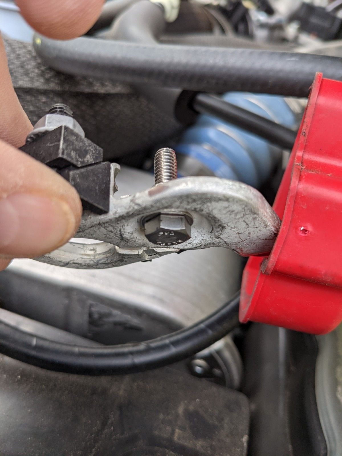

Do you have a link or picture to this? I feel like this is something that I wish existed but I never really researched it.
Hope this is what you were looking for. Came from another thread.

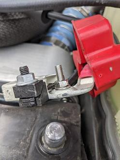

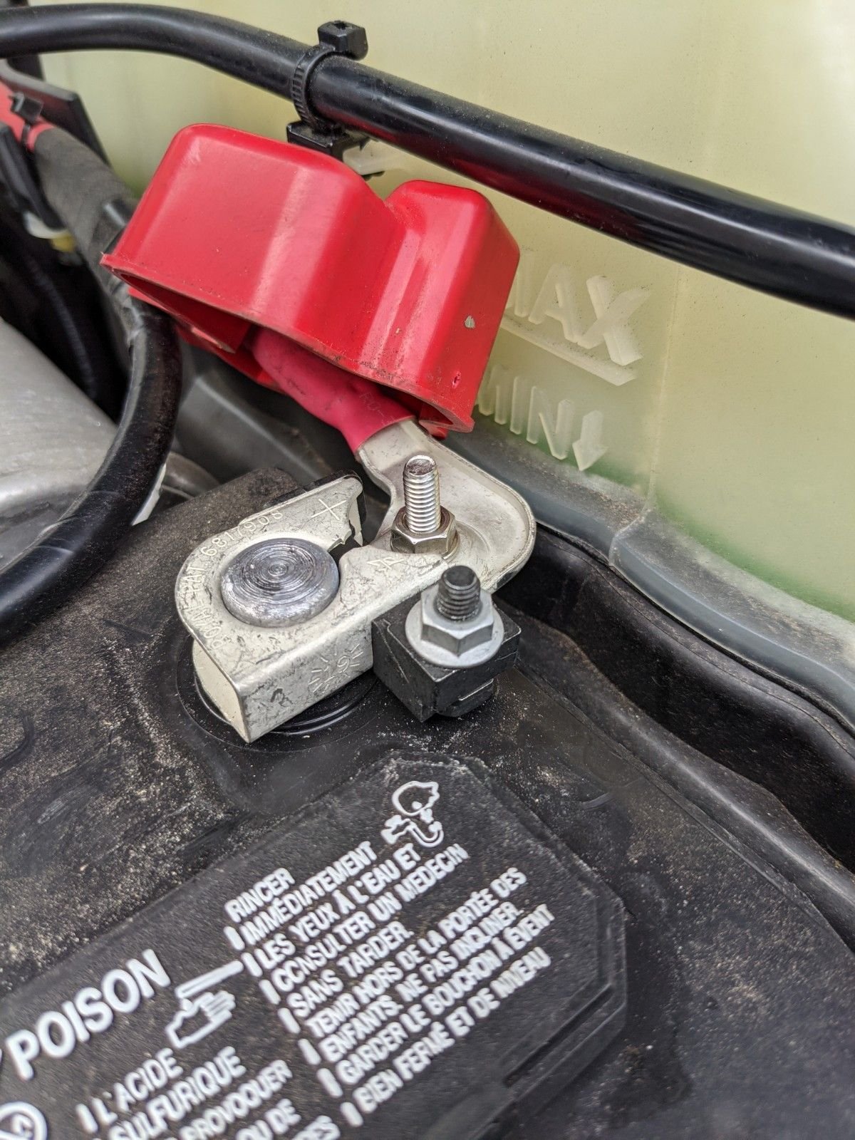

This is how I did it. I used a 6mm stainless bolt and I have connected a 1/0 welding cable to the driver's side battery.
