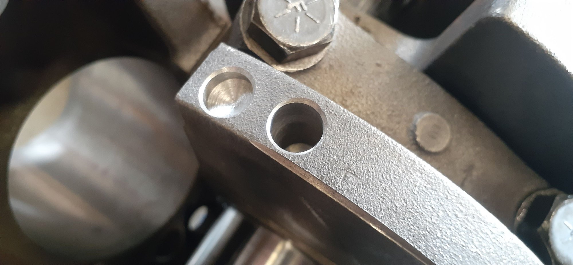

340 pistons came in. Some preliminary math says that:
1. 340 piston weight is 27 grams heavier than 360 piston. Going to use a 352 crankshaft as those counterweights have less weight removed as 352 pistons are 50g heavier than 360 pistons. This gives more material to be removed (or don't have to try to add to the 360 crank...expensive).
2. Piston skirts clear crank counterweights.
3. Decking block and heads .010" will give 0.012" deck clearance. Math says that's 1/8th of the deck clearance of the 360.
4. Wrist pin bores on rods are 1.040" and there is plenty of material to open up the bushings an extra .009".

Regarding crankshaft. Look at the factory applications:
https://www.ford-trucks.com/forums/1...l#post16971160
A 330 piston is only 3.875" vs. the 4.05" for the 360, yet they use the same crank.
I think as long as your pistons are all the same weight, you should be "safe".

Already pulled a C4AE-something 352 crank out of another engine to compare to the 70's 360 crank. There were a couple of extra drill holes in the 360 crank that the 352 crank didn't have so I'll use the 352 crank as there's more material to remove (if need be) for the slightly heavier pistons.

The weight of the piston matters 1/2 as much as mass that's rotating. I don't know what the typical variability on the rods is in a 352 or 360 but from set to set it wouldn't surprise me to see 30-50 grams of total difference so that in itself could swamp out any real difference caused by using a piston that's a little heavier or lighter. The amount of weight that is available to remove from the crank is pretty much impossible to tell by looking at the existing holes in the counter weights. Cranks vary a lot when it comes to where their weight is distributed with some having throws or counterweights which are heavier or lighter.
Many times when I'm working on a balancing job and I have to add a little weight say 15 - 20 grams I'll just weld inside of one of the existing holes. It isn't a big deal and it doesn't add to the cost.

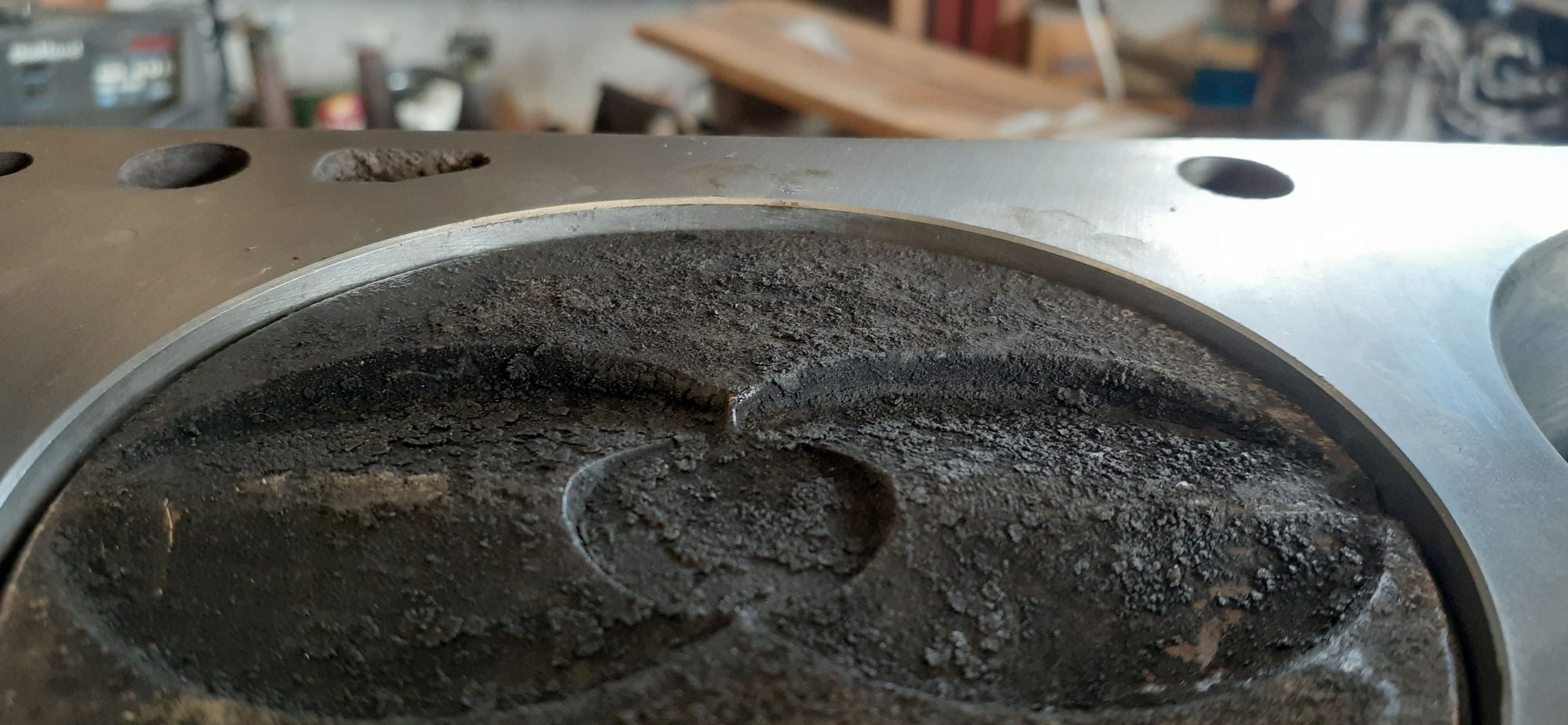

I got the rotating and reciprocating parts back today.
The pistons sit .028" in the hole while the 360 pistons are now at .112 " after decking so I lost .084" of wasted space for combustion. It's not super-tight, but it's way better for the same money spent!
Pics if you care....

It'll be interesting to see how your valve reliefs work out or if they will even be necessary.
Old Aug 15, 2022 | 01:17 PM
cleatus12r's Avatar
cleatus12r
Butt-Head
Joined: Apr 2004
Posts: 9,448
Likes: 2,934
From: Reed Point, MT
Well.....
If a 390 4V is any indication, the valve reliefs in these pistons is a bit overkill. I'm twice the deck clearance than the 390 and the reliefs are bigger with these. I probably could have gotten away with flat tops since I'm running a stock cam.....but I couldn't find any.
352 pistons have shallow reliefs and about .012" less deck height and they do ok with certain cams in the .512"-.533" lift range.
