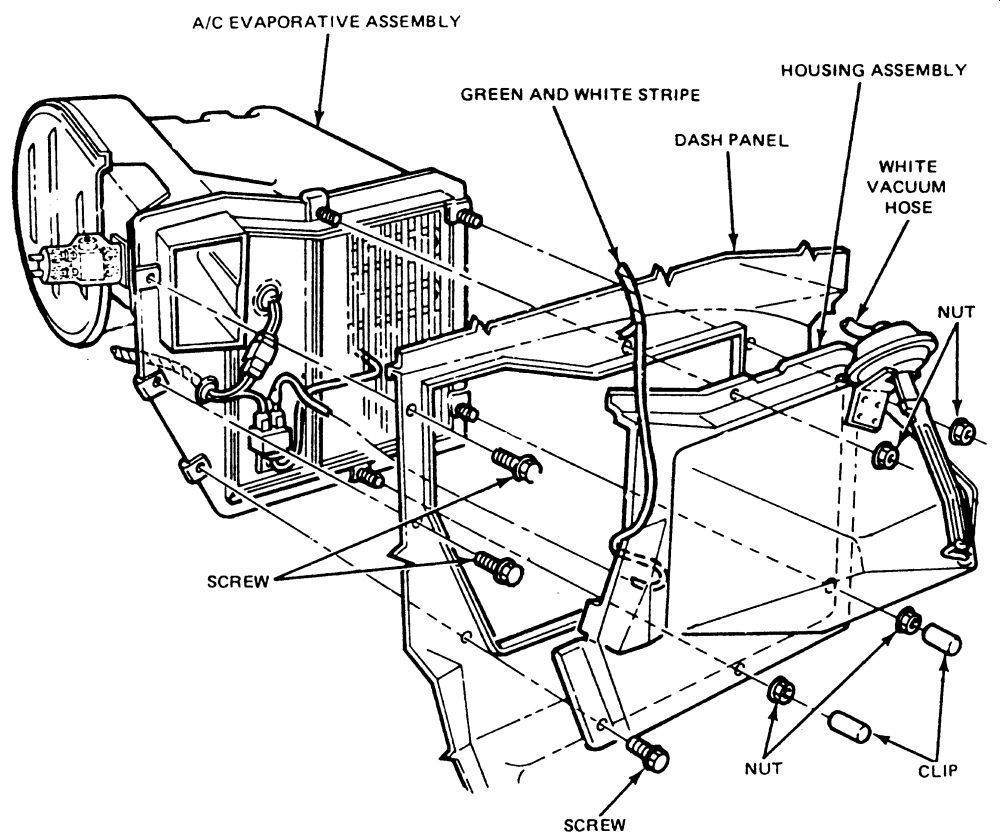

X2 on flex extension, wobble socket, short extension, or short socket and an couple is universals. Patience and more tools put together, that is the A/C Evaporator Assembly in the way. And yes it does also have a heater core in there. And yes it is a PITA.
