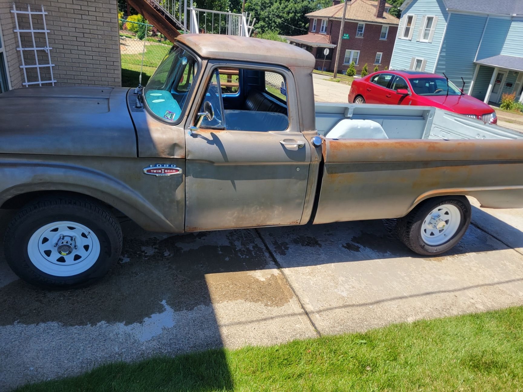

Craig Keto's Avatar
Craig Keto
Joined: Oct 2020
Posts: 123
From: Just east of Pittsburgh
I just did this last year. Got 4 16x7 US Wheels from Summit. 5 x 5.5 in. Bolt Circle, 4 in. Backspace. U.S. Wheel 70-7755 U.S. Wheel 70 Series White 8-Spoke Wheels | Summit Racing
I had the blue and red stripes removed with enamel reducer. I wanted them all white.
I'm running General Tire Grabber UHP summer tires, 255/65R16. They have an aggressive tread. Zero traction problems in light snow and even mud, and I have an open diff. I have 3 inch spacers in the rear and no spacers in front. They're about 29 inches tall, and I believe my speedo is about 3 MPH slow.
Here's how she looks. You can get your hand between the rear tires and the fender, even with a 1,250 pound load. I have no clearance issues there, even over potholes, etc. I have a rebuilt suspension with new 950 pound leaf springs in the back and new coils up front, plus new shocks, so she doesn't move up and down much.
