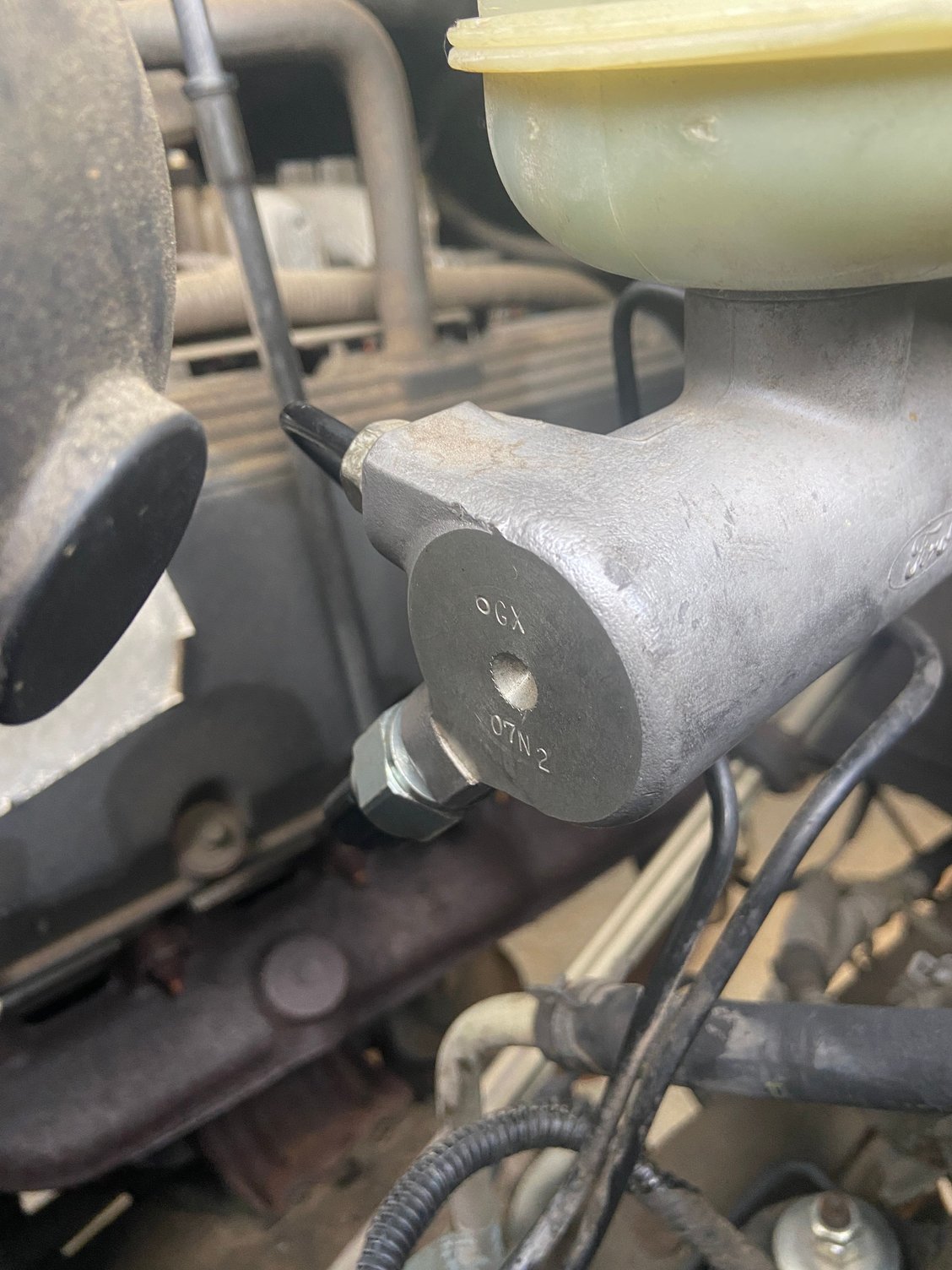

Unplug the SCDS on the brake master cylinder anyway and see if the issue resolves temporarily. You will lose cruise control in this configuration. Examine the switch and harness connectors for brake fluid.
Old Jun 21, 2022 | 06:16 PM
rhenson23's Avatar
rhenson23
5th Gear
Joined: Apr 2022
Posts: 5
Is this the one you mean for me to disconnect?
