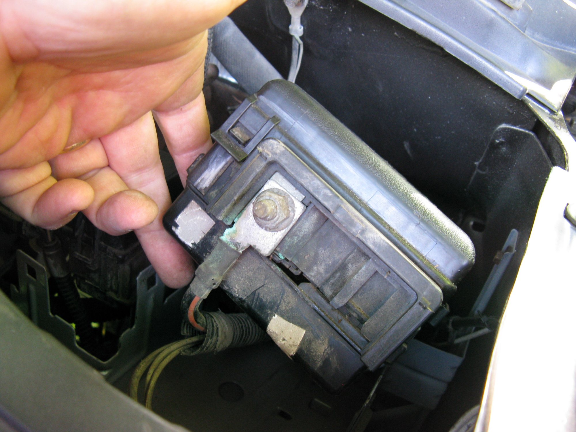

Lots of chatter on this subject however can't seem to locate a definitive answer or solution. My truck 2000 F250 7.3 powerstroke ZF6 4x4. The issue started with a dimly lit "wait to start light", however the engine would start. This progressed to no wait to start light and a rapid clicking noise from fuse panel under hood (driver side), engine cranks fine. Also the truck has two new Motorcraft batteries. Go to solution seems to be, unplug heater in bottom of filter housing, and check #30 fuse under dash. I did both of these. Unplugged and verified the fuse is good with a meter. Also replaced the relay in underhood fuse box (the one that was clicking). No change.............. Another suggestion I found was to verify the power feed to underhood fuse box (see pics). I removed the wire, cleaned connection and reattached + verified with a meter 12 volt reading at the fuse. Again no change............ Am Iooking at a new computer or are there other checks to perform? Grounds?

Relay clicking is usually caused by weak batteries and/or poor electrical connections. Check and clean your grounds and connections. And it looks to me like there is corrosion in the wire to connector connection in that fuse box feed line. Voltage is one thing but amps is another. Do you have a way to see how many amps are coming through the eye connector? Check your connections through the starter solenoid on the passenger's side fender. Your fuse boxes run through that.

I cleaned the connection at the box, photo was before cleaning. Relay on pass fender is also new. Wondering about underhood fuse box. Possibly disassemble it check for additional corrosion? What about grounds?
Look where that connector on the end connects to the wire. Do you see that green stuff? It indicates corrosion inside of the sheathing.

Yes, I also noticed that however only way I know to remove / eliminate that would be cutting off the factory wire end and replacing it. I sprayed it with battery terminal cleaner (stuff that turns color indicating acid leak), after spraying and drying with a cloth I covered it with dielectric grease and reinstalled. Tested with meter before disassembly and after reassembly and both indicated 12 volts at the wire and one side of fuse connection.
