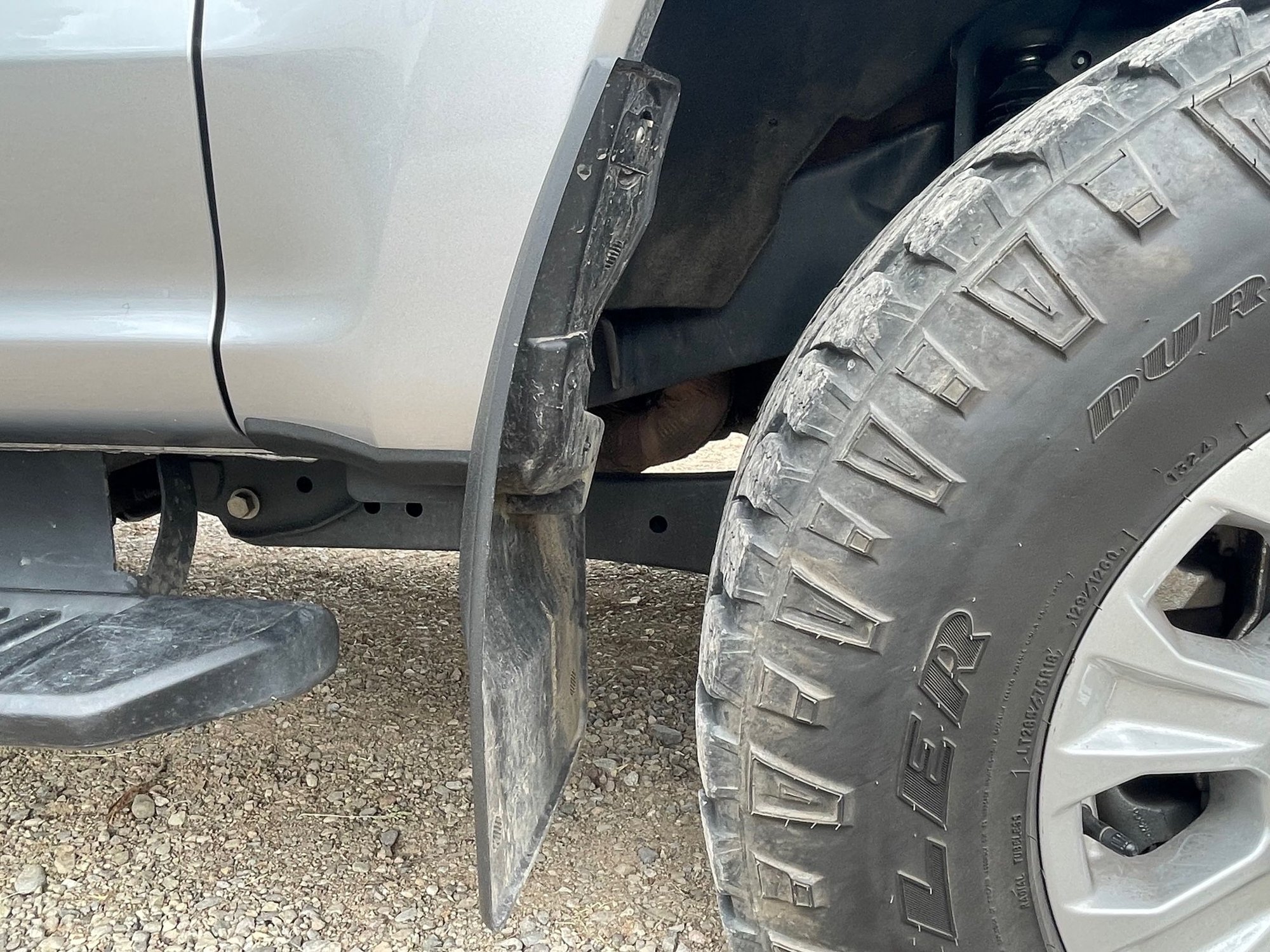

Just following up in case it helps anyone... pocs don't even do it justice. I went with a 1.5 inch level (block under spring perch) and 295/65r20 ridge grapplers. Zero issues rubbing including ford mudflaps. I'm still teakeing the drag link to get the sterring wheel perfect, but it drives absolutley no different than stock. Didn't use caster shims or adjustable track bar. 1.5 inch seems to be a great option for anyone wanting a slightly more aggressive stance without sacrificing ride quality.
