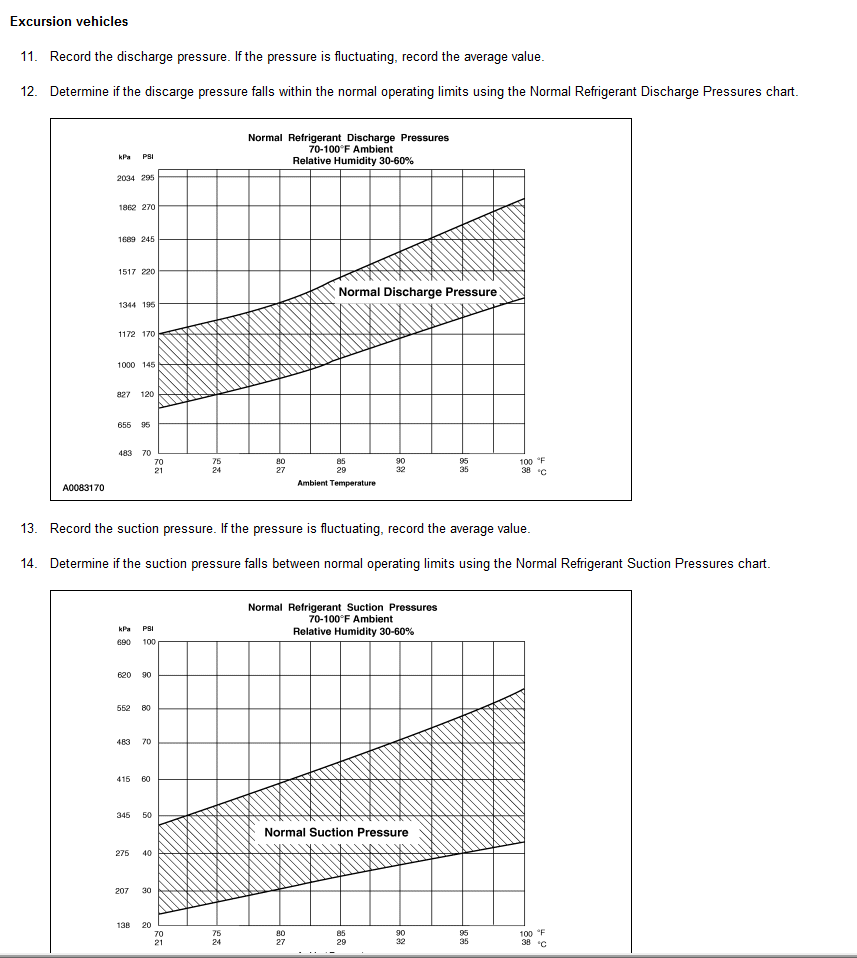

Old May 27, 2022 | 08:01 AM
Theboneskes's Avatar
Theboneskes
Joined: Mar 2019
Posts: 947
Likes: 144
From: Columbus Ohio
here is the chart
Old May 27, 2022 | 08:08 AM
yzf450motoxrider's Avatar
yzf450motoxrider
Joined: May 2017
Posts: 90
@Theboneskes That chart appears off, this is direct from the FSM. My system is within specification.
