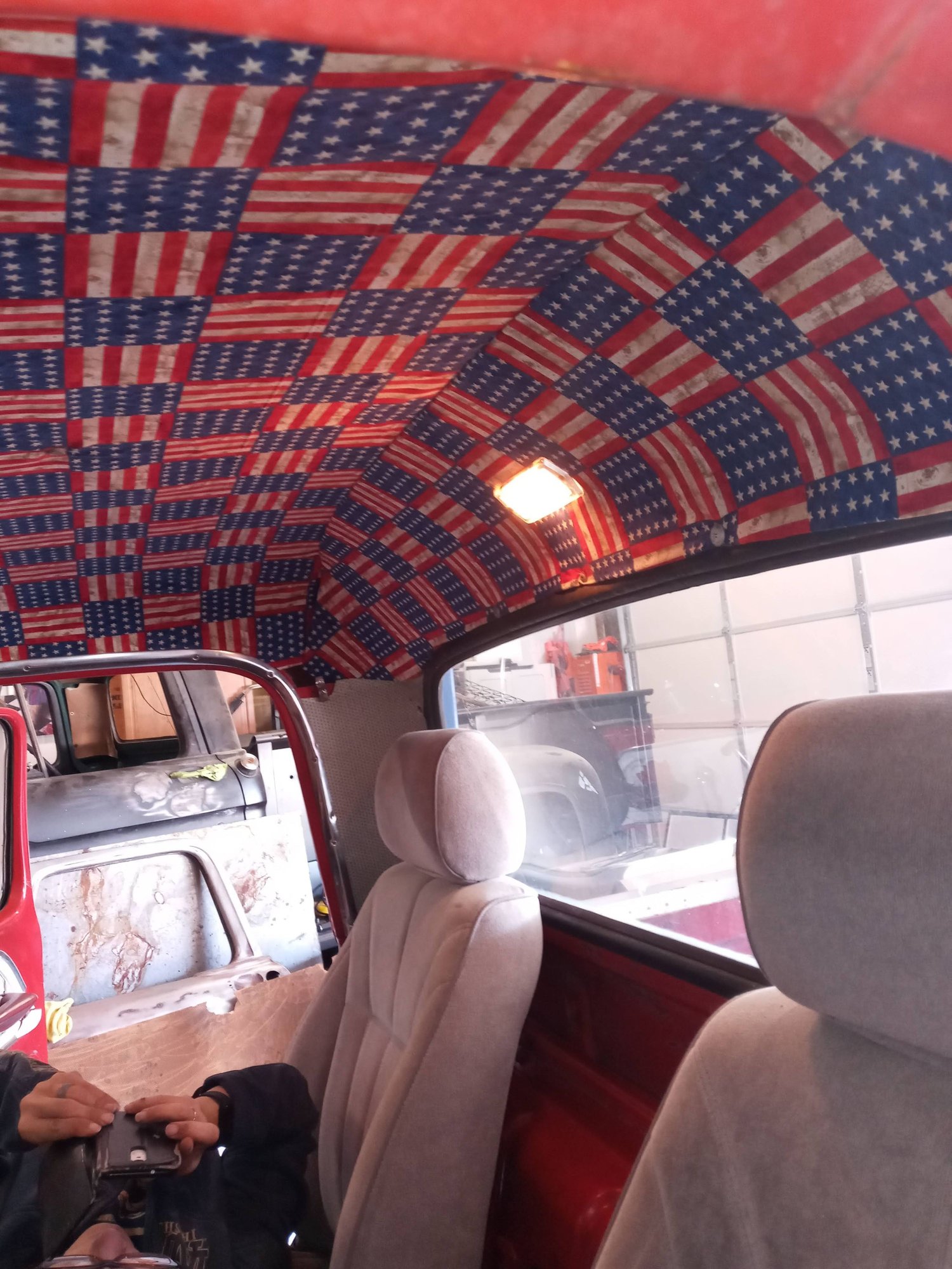

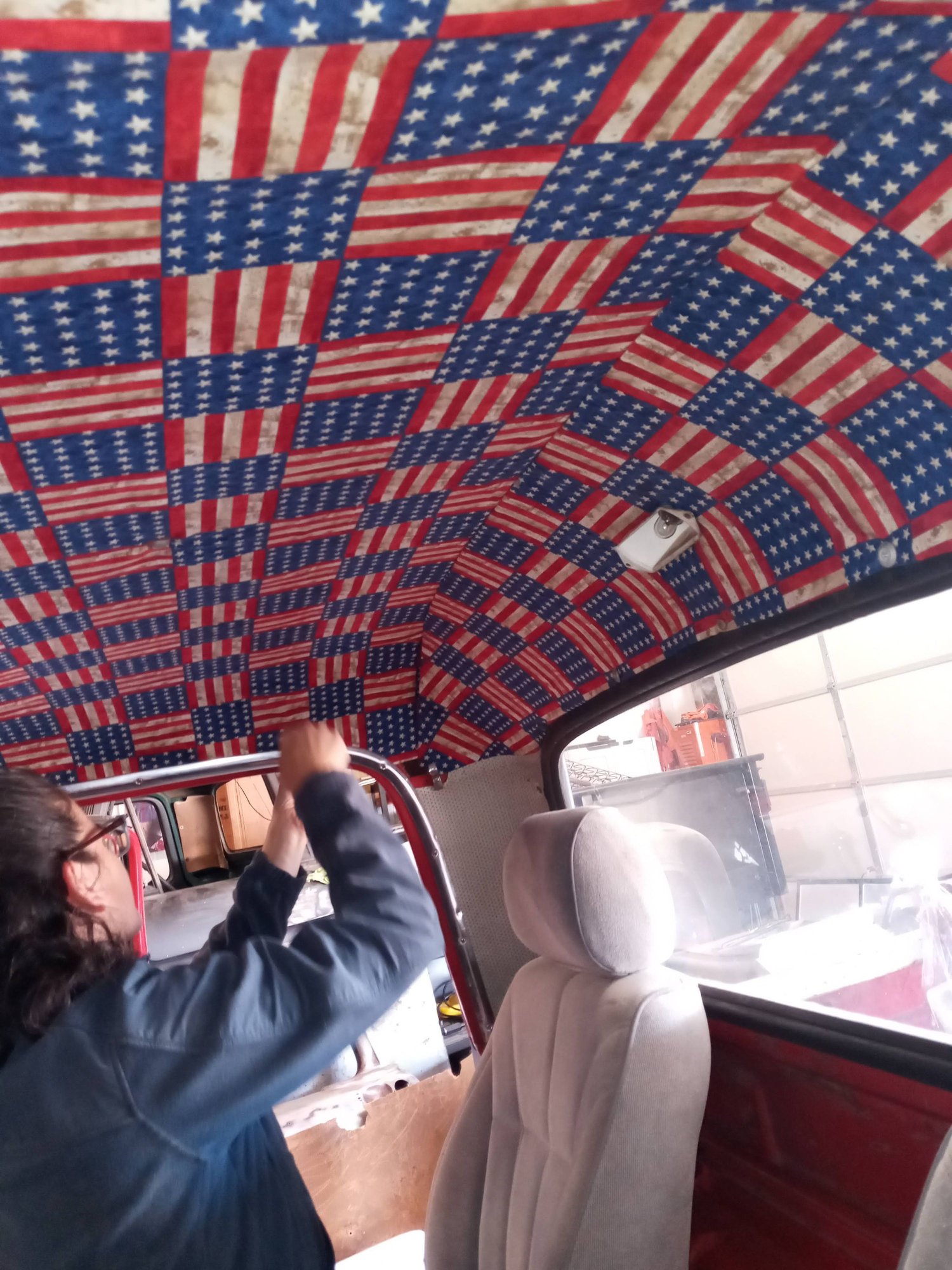

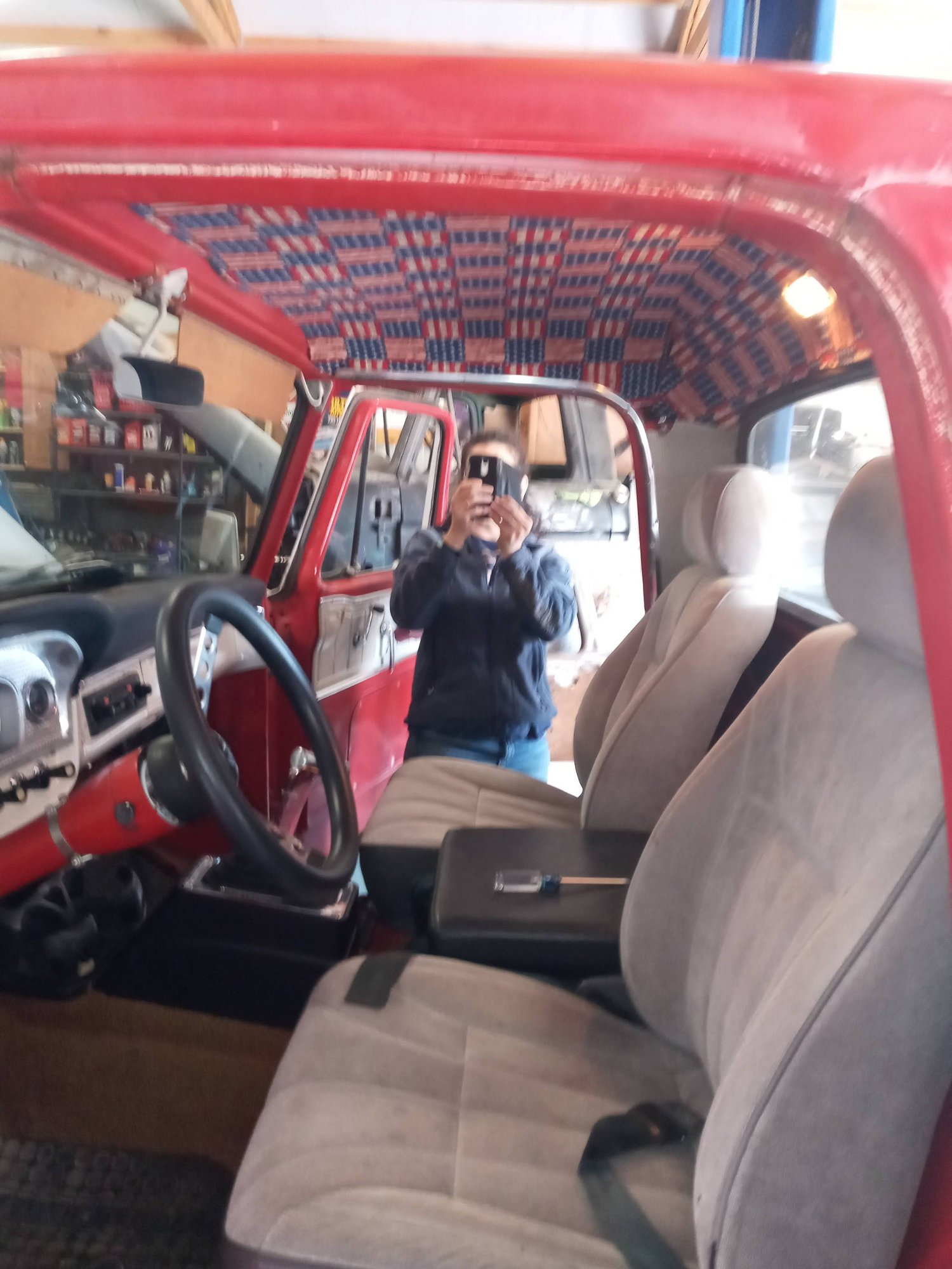

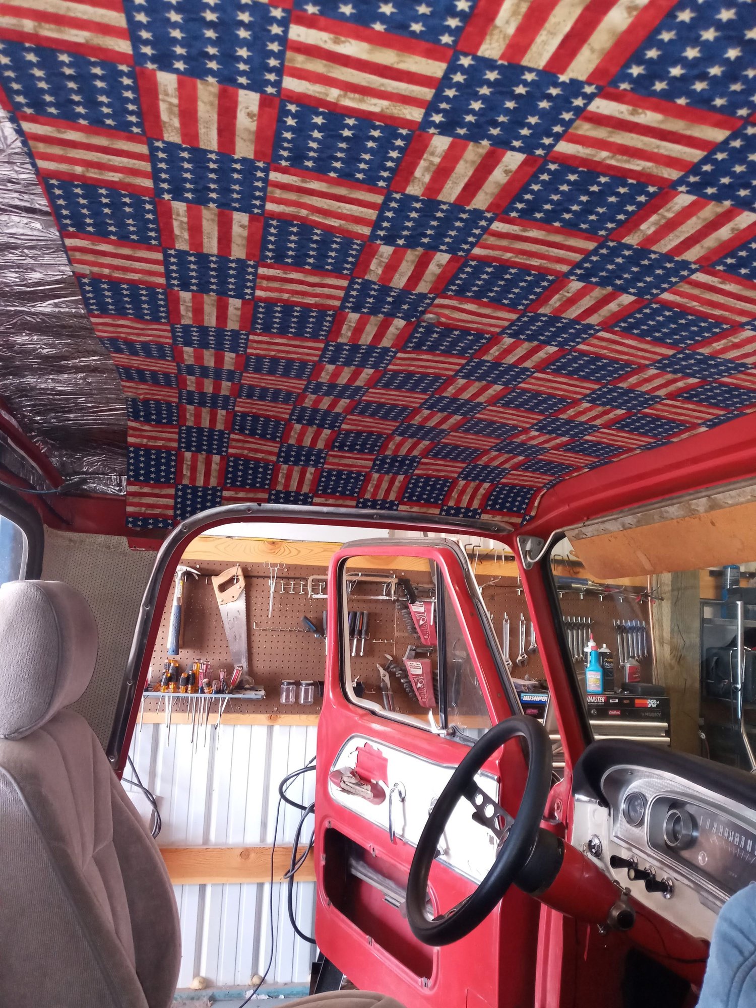

Made our own... Picture matting cut from original headliner as template then fabric of choice spray glued and tucked around edges. Used a peel and stick insulation from fleabay above the headliner first.
