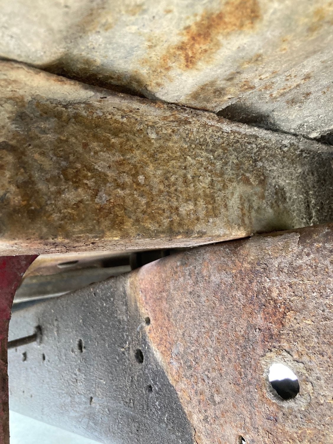

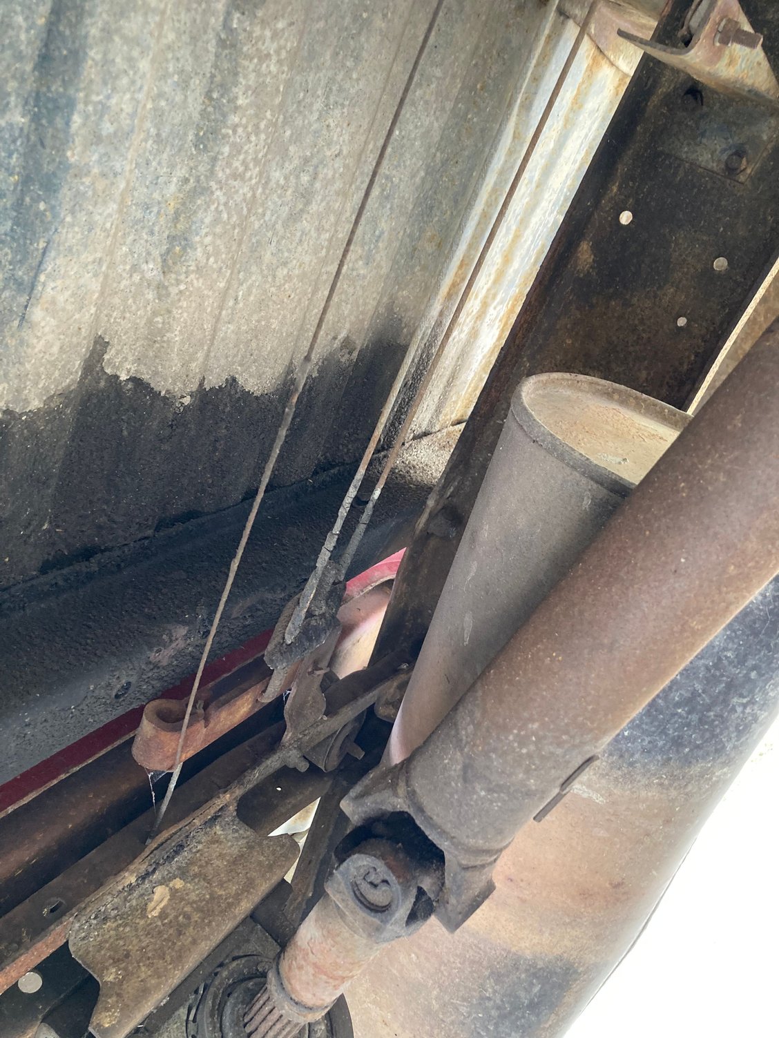

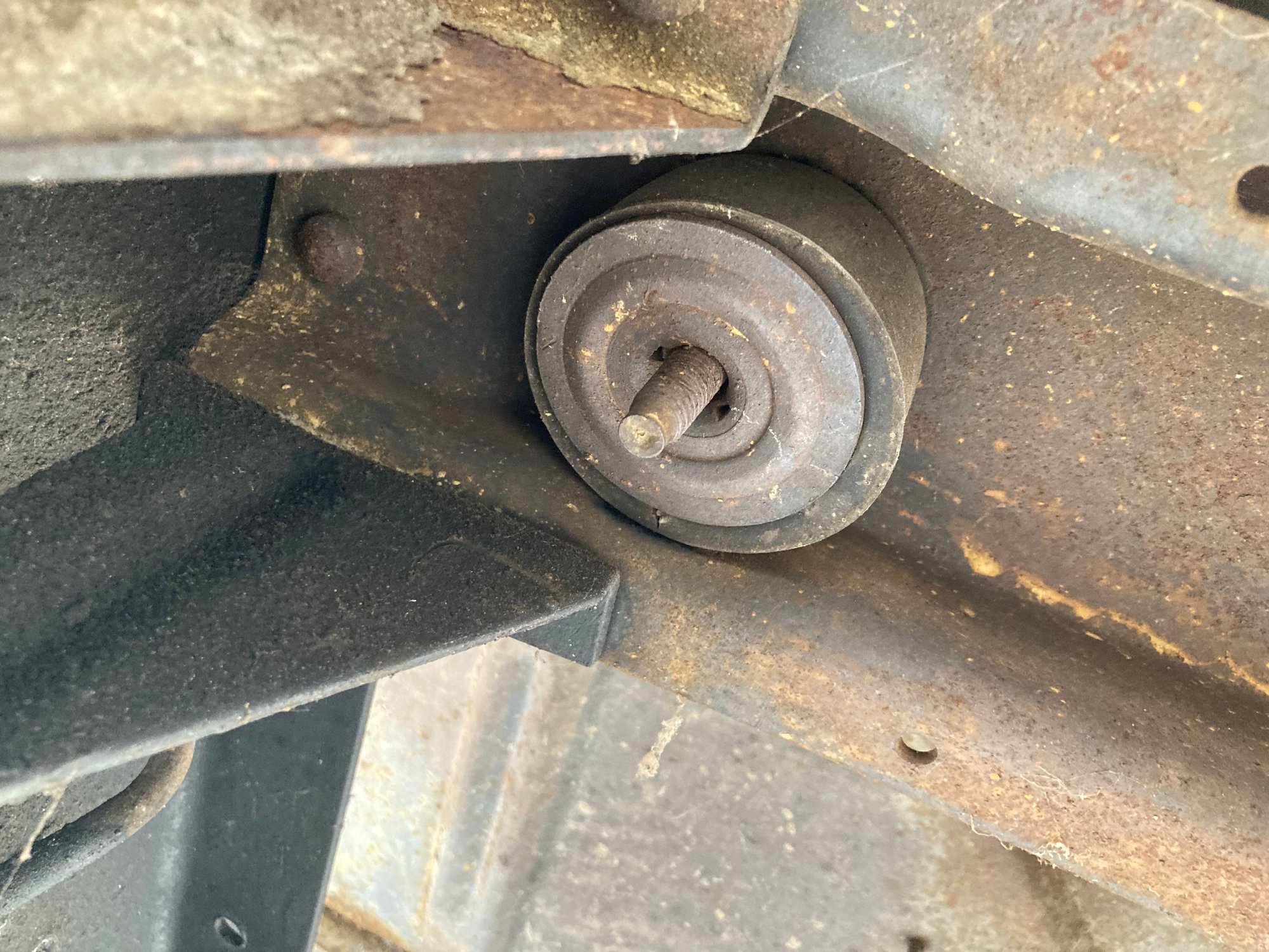

Here’s some pics
Look good to me. Not sure where the nut is for the cab mount.
Passenger side
Cab mount
Drivers side where gap issue is

Well I can tell you one thing, most guys on here wish their hardware looked half as good as yours. The rubber brakes down over time but the actual metal hardware on yours looks good. I would just take some frame measurements once you get the bed off.

Your body mounts don’t have a standard nut. That’s normal. The visible lower washer is the nut.
what you see as a recess where the threaded end of bolt comes through is actually kind of a reverse tower with threads.
There’s an upper half at the body and a lower half under the frame mount that mushroom together when the bolt is torqued, creating a clamshell around the two rubber insulators.
