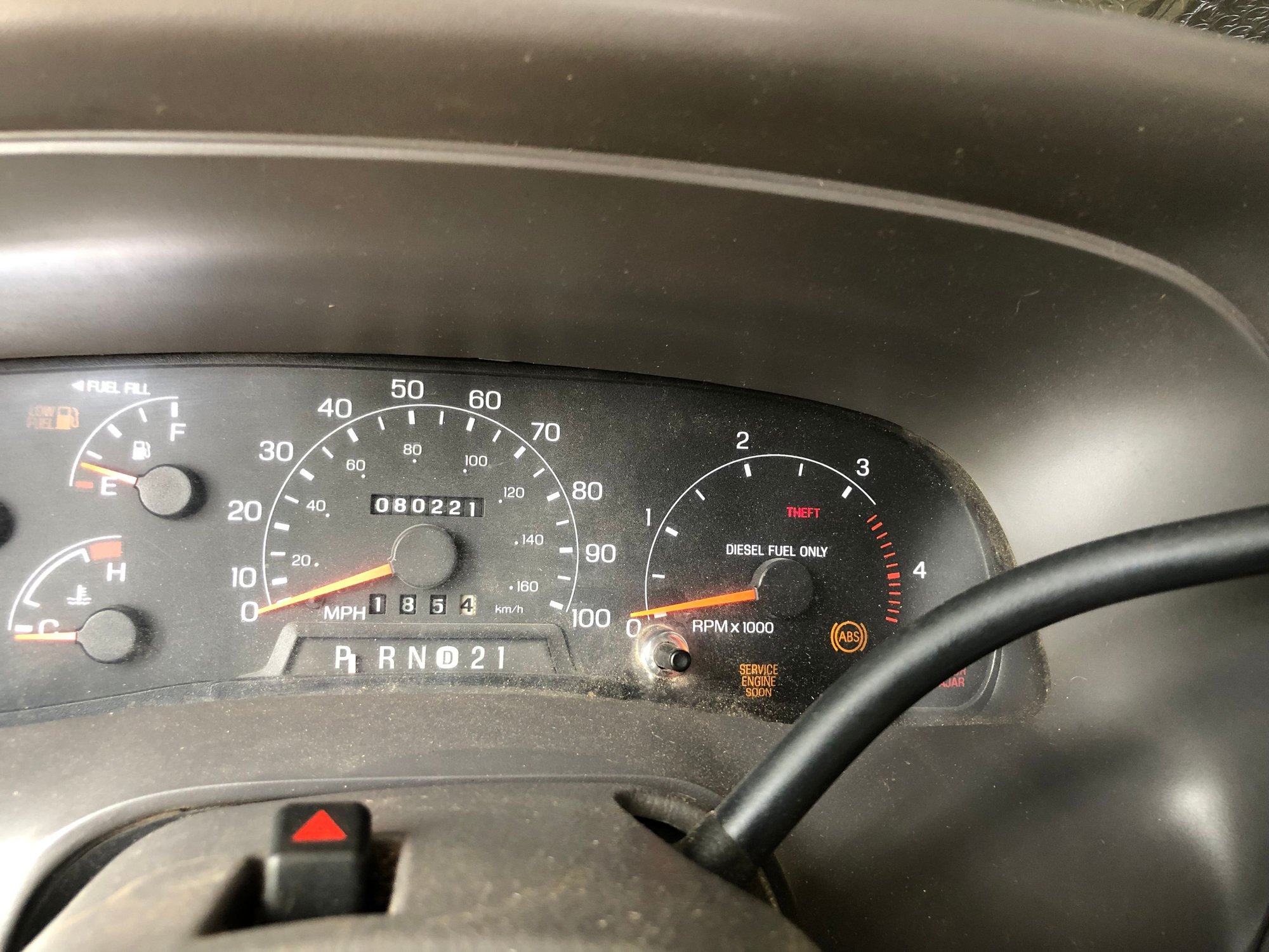

PATS won’t let me start my excursion. I have tried the wait until the theft light stops and remove key for 30 seconds reset option a dozen times on two different days. The key in driver door reset also. I have left it with batteries disconnected for 48 hours. I got the correct OBD dongle yesterday and show connection with the dongle but FORScan can’t communicate

A few weeks ago same issue with my main key which is a generic at the grocery store. My back up also a generic which my mechanic was only able to work 50% of the time- but it worked that time.
Now I am at my family’s ranch probably 30 miles from a dealer, and neither keys are recognized. And the phone internet is super slow
This time I believe there are more relays clicking in the dash and under the hood

Would a locksmith be able to reset the system? I was pretty angry when I couldn’t get FORScan to connect
With my present luck I am hesitant to pull the ecm and ship it anywhere. I suspect the ecm was replaced, my mechanics scanner showed California emissions on a truck delivered to a dealer in Freeport Texas. If I swapped in an ecm from a Superduty 7.3 f250/350 of similar vintage from the chart would it just ignore the PATS hardware? Present ECM is an
The light will not stop blinking...it will slow down on the flashing for the reset. You may have to insert the key for 10-15 minutes and then turn in the on position for another 2-3 minutes to learn and/or undo what you've done as described here: https://www.truckofmine.com/ford-pat...-how-to-guide/

Ignoring the blinking light, What did you do before the no start that leads you to believe it is a PATS issue ?
using a digital multi meter, disconnect the positive battery interconnect and check voltage of each battery separately.
my guess is you have 1 battery below 12.6v

i don’t know what triggers the PATs light to blink when the PATs isn’t actually activated but they can and do.
the low battery causes a crank no stark on the 7.3 because the starter doesn’t spin the motor fast enough to get the injectors to fire. Or if low enough voltage you just get a solenoid click like he mentions, that is what made me consider it.
It turns out the driver side was 11.@@ volts. Charged both up to 13 and started fine. Driver side was down to 10 again today
when I started trouble shooting last Tuesday both my cheap meters I leave here were dead. I put each battery separately on my charger and it immediately went to charge complete.

All the modules need 10.6 volts at least or a malfunction happens and lights go on
I agree unless both batteries go low pats should not squalk
