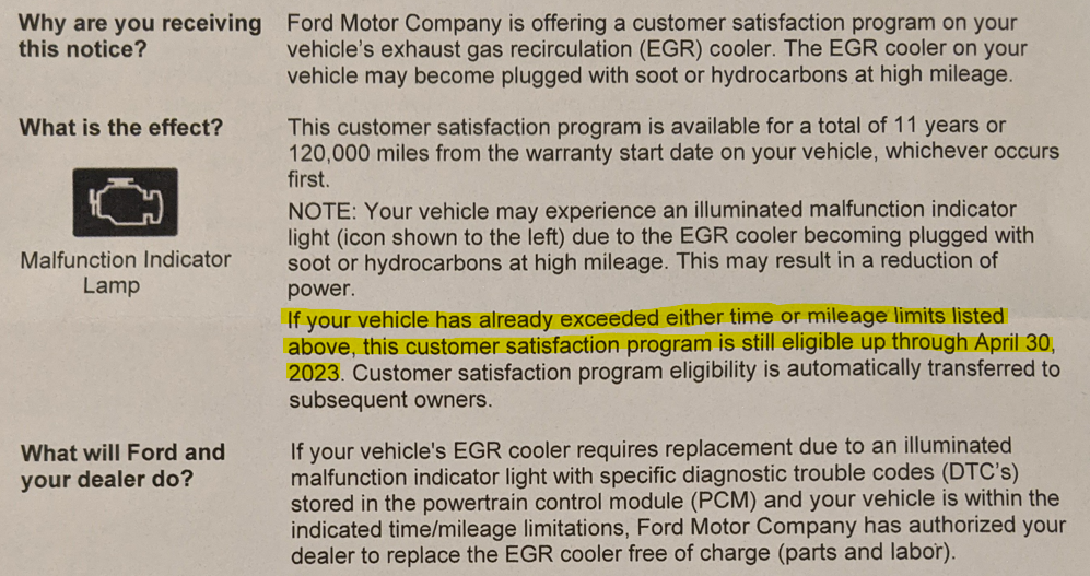

An active P0401 will likely qualify you to a free repair from Ford under CSP 21M04 as long as you get it repaired by end of March 2023 April 30, 2023.
I provided a URL in this post where you can confirm if your VIN is eligible if you don't have an active Ford Owner's profile, so that you have the information for your dealer if it becomes a debate.
https://www.ford-trucks.com/forums/1...l#post20389086
Here's another post where the OP provided a picture of the customer letter.
https://www.ford-trucks.com/forums/1...l#post20383258

Thanks, I do see that one under my 2011 6.7. Problem is I'm past the 11 years as I bought mine in December of 2010. Im at an out of town Ford Dealer
so Im not sure how I can handle it.
Ill try to contact the service manager to see what can be done.
You will qualify for the active exception which is valid to April 2023 where the 11 years or 120,000 miles restriction is bypassed.

Thanks for posting the letter with the info on the calculation. Sounds like something conceived by some mathy person and poorly translated to be only slightly less confusing. If makes me wonder if abnormal driving conditions could cause the calculation to be temporarily exceeded in a vehicle that otherwise wouldn't have an issue. I also couldn't tell if the equation adapted to a specific vehicle's typical use (I don't speak math).

Good news, they will replace the EGR Cooler under the warrenty
