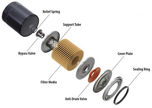

What brand of filter are you using? Most of your better brand filters will have an anti-drain back valve to prevent exactly what you're describing.

Goggle really is your friend, it just takes a lot of time. So what could be preventing the anti-drain back valve from working ? Cut that sucker apart?

Yes I have been google-ing and can't get a straight answer but with the old filter and new doing the same thing I assume the motorcraft does not have a anti drain feature

Motor-craft filters have a anti-drain back valve.
So if "something" was logged in the oil passages under pressure (crud / wrong lifters) and then after the pressure deceased allowed the oil to seep past and drain down?
If so maybe (low) compressed air blown through the oil galley in different directions might show a blockage?

What Motorcraft filter # are you using? As I recall, not all Motorcraft/Ford filters have the anti-drainback feature. An FL-1A does have it.

Installed FL1A
