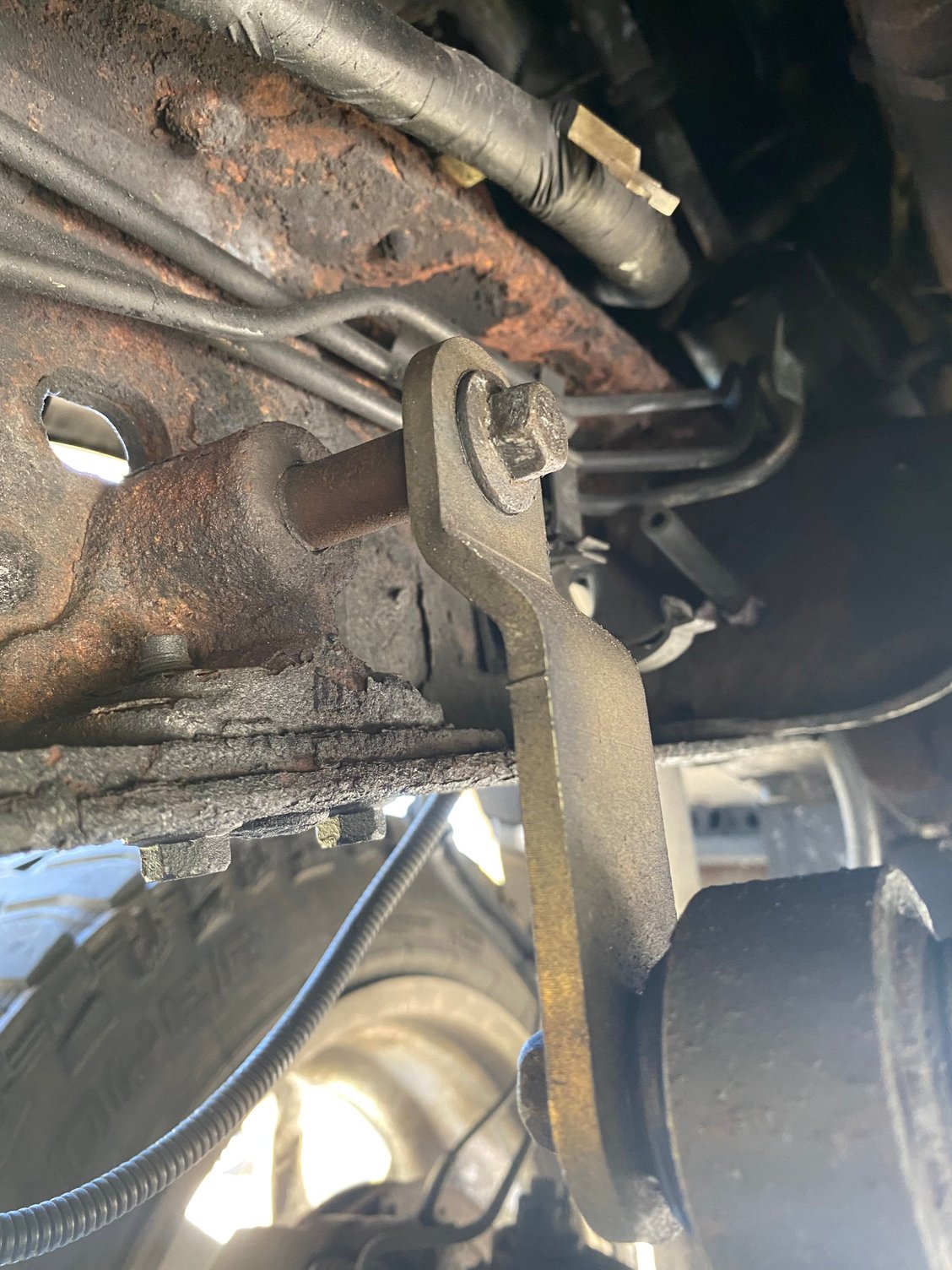

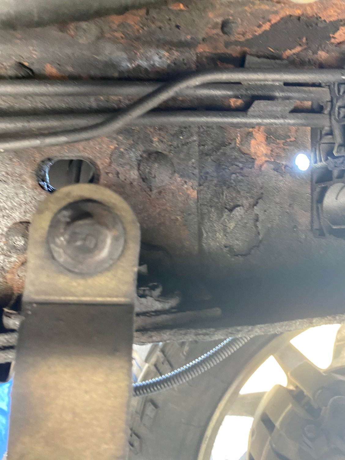

Passenger side bolt missing.
does anyone know what size, spacing and where to purchase?
Below pictures are from drivers side which I would like to replicate on passenger side.

I would get the proper size sway bars arms, how it it set up now it will just bend on compression defeating the purpose of the sway bar. To answer your question m12-1.75 x 110 mm is replacement size.
