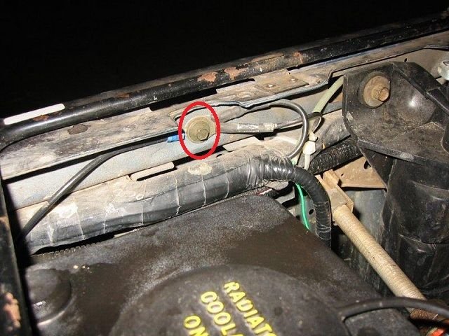

Excellent advice above. Make sure to also clean your headlight grounds. Both are located in front of the headlights and above them level with the top of the radiator..

Clean your grounds. It sounds stupid, but it fixes alot of stuff like this. Don't just like *look* at them, or spray them down with QD or Deoxit or something, disconnect the battery, and unhook the grounds at their grounding points, and take a wire brush, or sandpaper, or some such to them, and make sure you've got a good bare metal connection.
Will do. Thanks!

I removed and cleaned the ground at the driver's side front by the coolant overflow, the one from the batt neg to the passenger's side fender well towards the front, and also the one over by the ECC test port. It seemed to make no difference. I can consistently get it to stall/stutter around 3,000 RPM's with headlights on. With headlights off, it is not as consistent. In fact, it hardly does it all with headlights off. Windshield wiper motor seems to have no effect. Heater blower motor alone seems to have no effect unless used in conjunction with the wipers. However headlights alone will cause the stall/stutter.

Freshly cleaned stuff - Batt terminals and connectors, SPOUT jumper, grounds at: the passenger fender near battery, front top near radiator, driver fender near the EEC port, front bottom near connecting frame to radiator mount, and bottom passenger side connecting frame to cabin.

Look behind each kick panel, at floor lever. You should have a ground on each side. If not, you will have a ground below the fuse panel that is hard to see and get to. Just because it looks clean doesn't mean it is. Miner looked good, but had corrosion and slight rust when I took the screw out and looked at the terminal.
