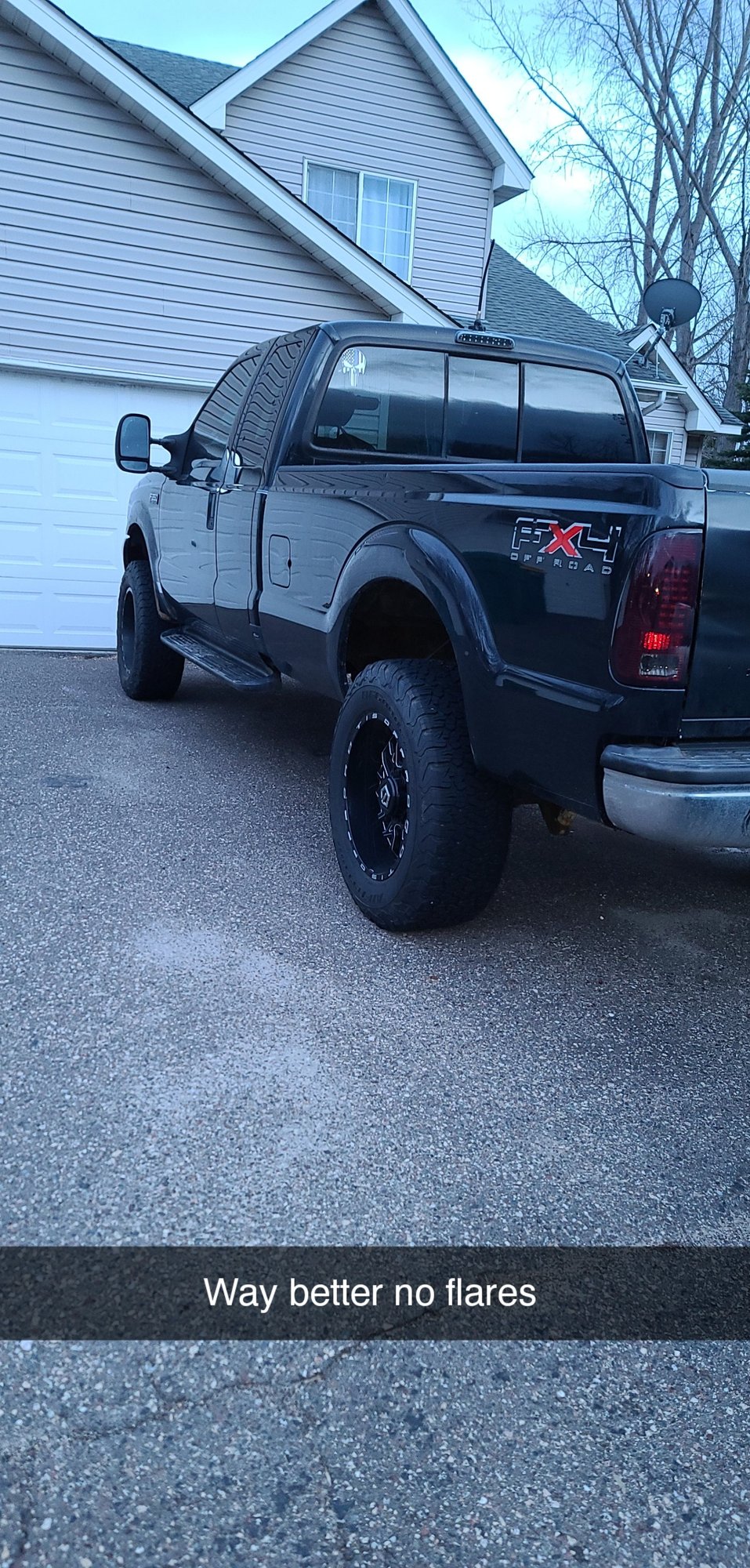

Need opinions on my 01 f350 7.3. I feel like it gets bad mpg. Average is 11-12. All my buddy's I talk to get 16-18 no problem. It has a hydra tuner, shift kit, 5 inch exhaust with downpipe and intake. Runs and drives great. Wish it would shift sooner is my only complaint but it's in tuning. Anything I should look at? Just confused for how good it runs.

A couple things working against the mpg...4x4 running gear, big tires/wheels, hot tunes. Driving habits can also contribute...

Insure the truck is running at peak efficiency. Good fuel and oil, maintenance at top notch level. Tires inflated to truck weight specifications, maybe a touch over will give lower rolling resistance but will impact wear.
Tunes are usually not good for milage as you will tend to drive for effect.
Low resistance highway tires are your friend but you likely are using chunky off road tires on the highway and it shows on the mileage.
Lifts well that is not helping.
