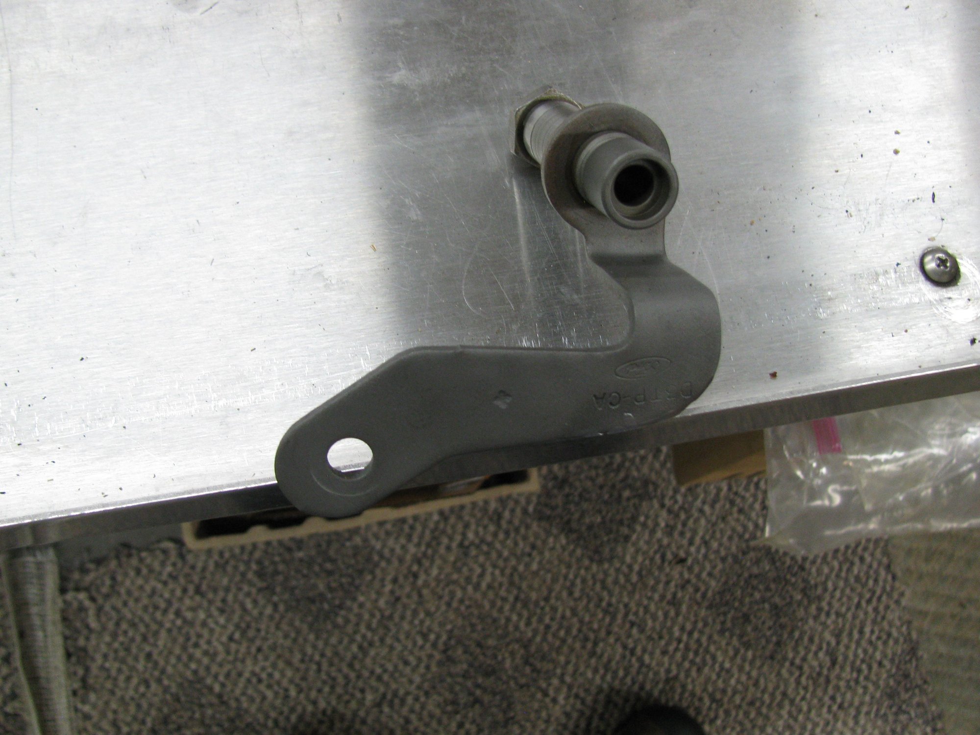

C6 manual lever
If you have a C6 and it's the original or from a truck the manual lever should look a lot like this one. I have never seen one that didn't have a bushing. That could be your problem.

Looked at my C6 manual valve lever, definitely different than the photo provided by Crop Duster.
Now looking to see if the transmission is original to the truck. I think the manual valve lever is longer from
the centerline of the shaft to the hole that the shift rod fits into. And is not parallel to
the trans pan when in Park.

The manual lever in the picture is around 3 3/8 inches from the center of the kickdown bolt to the center of the shift rod hole. If you have the wrong manual lever and need to change it. I have used E0TP-CA levers from 1980's trucks, they were also used in forklifts. They are still available new. But they have to be heated and bent up about 15 degrees to be parallel with the pan in order to work with the column shifters in our trucks.

Is the lever in your photo the correct one for our truck,part number wise?
I will go back and re measure using your location points. But ours is shaped differently and uses no bushing. Different C6 probably.

You have confirmed that it is definitely a C6 right? 17 bolt oil pan, integral bellhousing etc. That manual lever is from a 73 but it will work. Look at the servo cover on the right side of the trans and see if it still has a tag on it. If it does it will have a date code on it. This is a C6 from a 1988 F150. Yours may have a different tail housing.
