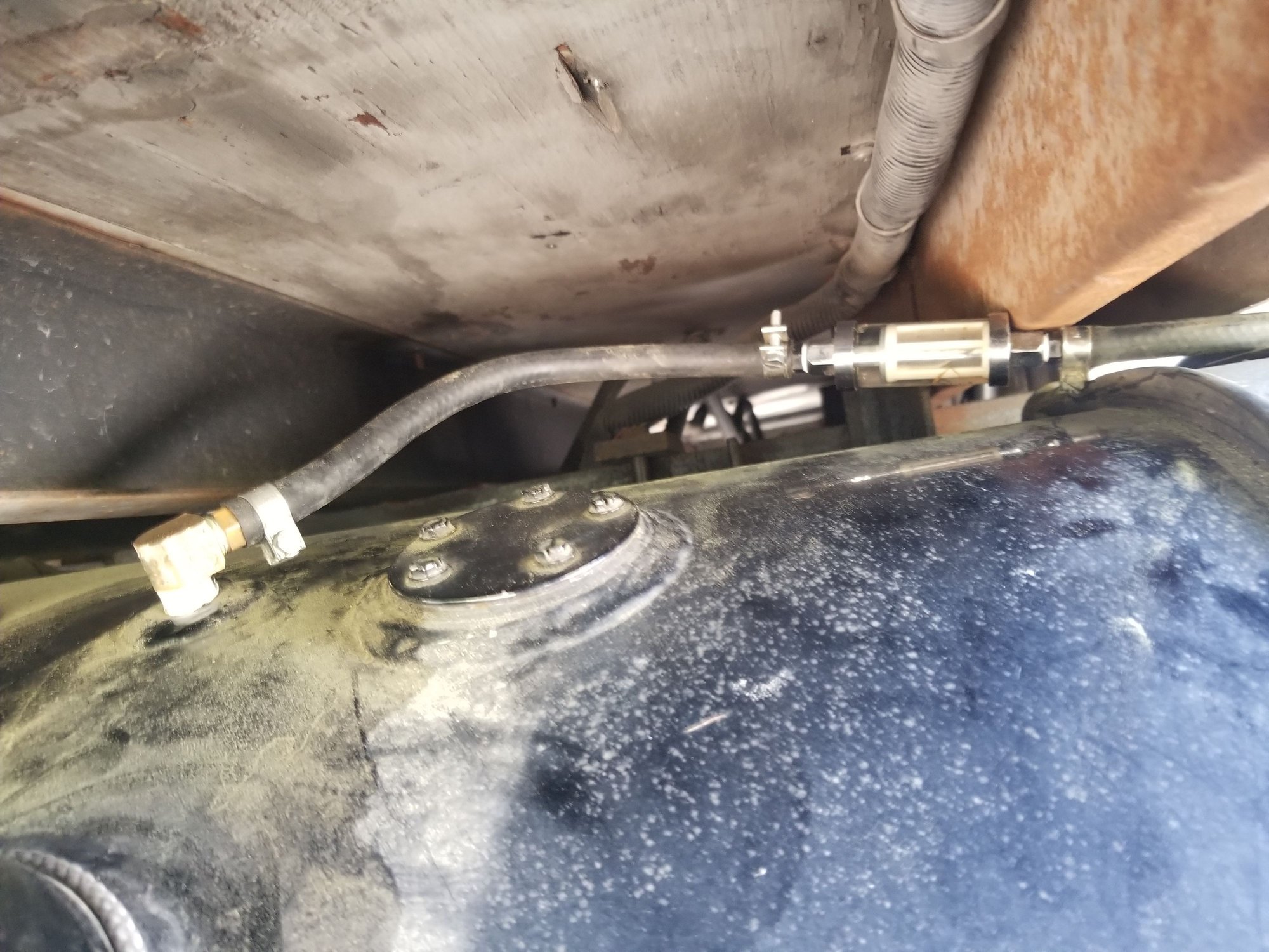

Yesterday I finally felt strong enough to deal with the weight and dexterity a jug of gas with 5 gallons in it requires. I used the shaker siphon hose and 3 minutes later the 5 gallons was moved from the big red jug to the gas tank. Still not too limber, I climbed up into the cab to start the truck. It fired up, then died. I cranked it again it sounded like it caught for a second, but no dice.
I could hear my year old electric fuel pump chattering there on the frame. Even so, there wasnt any gas present in the in line glass gas filter there at the fuel line outlet for the tank. I pulled the other end of the hose that leads from the fuel pump to the inlet side of my adjustable pressure regulator mounted on the inner passenger fender. With it removed from the regulator I found air puffing from the disconnected hose.. So something fuel pump wise was happening.
I removed the brass pipe threaded 90 degree fitting that the hose barb and exit hose all screws into that leads to the inline filter. This fitting has the gas tank downtube extending from it. With the down tube now in my hands, I blew on it while blocking the open end that would be immersed in gas....It did not leak.I put it all back together. My back felt tight and I did not want a relapse so I quit for the rest of the day.
Today was my 4th day of my return to my exercise program. I did an 8 lap swim in our condo's 50 foot pool followed by a nice dip in the 100 degree spa. When Im in shape I swim 30 laps 4 times a week until some distraction derails me then the cycle repeats
I went back to my ETTT not convinced there was not something wrong with the down tube, I removed the hose coming from that down tube fitting again to drop it into a 2 gallon gas jug to by pass the gas tank and down tube. While doing this I saw the hose leading to the in line filter actually turn.....The inline gas filter was loose, its ends where not tight against its glass center....I found my air leak. With that inline filter loose, the suction the down tube needs to draw up fuel there inside the tank was not going to happen .Im not sure why that filter assembly was loose. The truck ran before Mr Cretin was on the scene who knows he may have messed with the hose....
Ill climb back in ETTT tomorrow and move her to a different parking spot. It was too late in the day to get a space I would want and my battery was too low to get her started. Ill bring a jump starter tomorrow...
I should have a suitable safe place to park ETTT so she is off the street each night soon.....
the ends of inline gas filter were not screwed together tightly against its glass tube center. Looseness wasn't allowing an airtight condition

I had a filter like that on my hot rod and it was constantly in need of tightening or I could smell the gas that was dripping on my manifold . It's on the garbage now . Just for comparison roughly converted L/us gallon C$/US$ premium here is about $8.80/gal

Ill be watching that filter now for sure....I think where it is sitting on top of my gas tank is different than yours was being under the hood where there is engine heat and vibration...we shall see...What was leaking certainly had me scratching my head. My next step was to find the hole in the feed lines that would suck air...Im glad I found it fast.... having been dry for so long there was no sign of a leak etc.....
