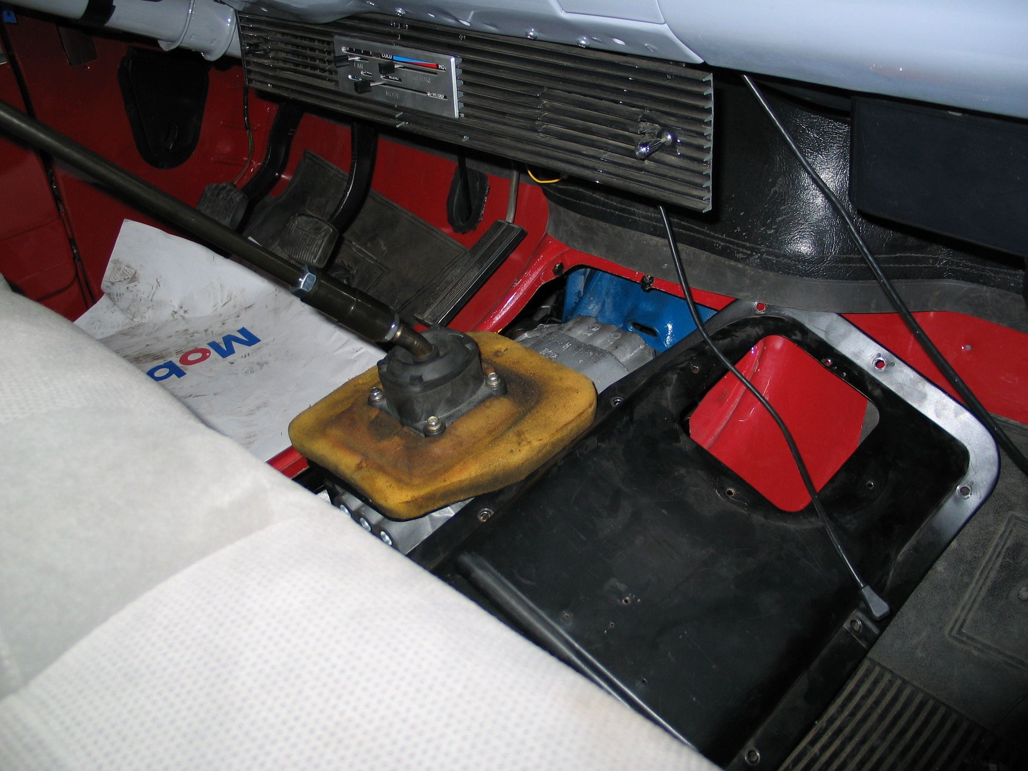

I did my NV4500 conversion in 2012. It got bolted up to an "improved" roller 390, now with FiTec TB EFI.
NV 4500 bits about to get a ride to their new F100 home.

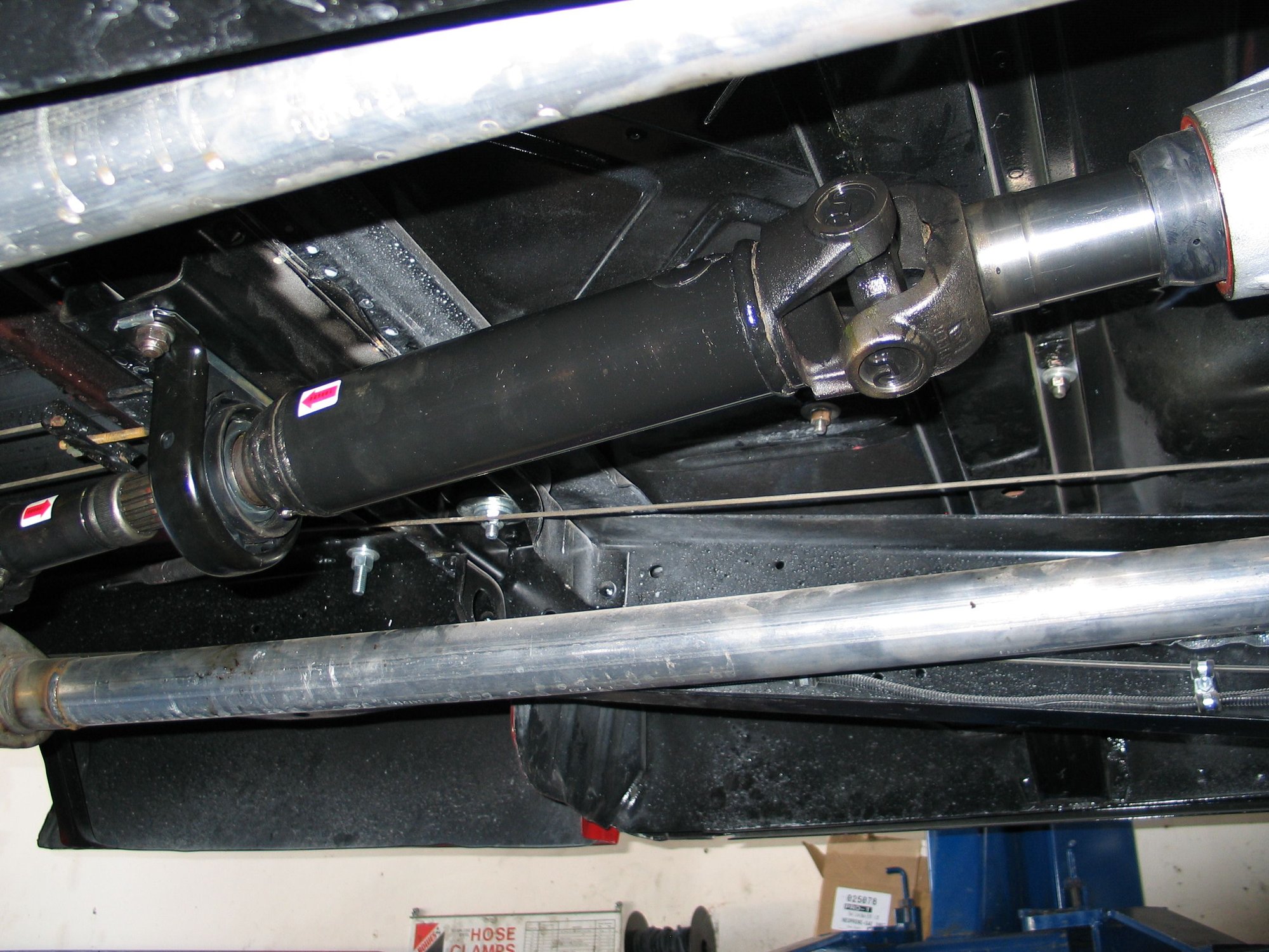

Bought most of the pieces in kit form from Advanced Adapters including the rebuilt ¾ ton Dodge transmission with old style cable speedometer tailshaft. Hopefully have a picture to show you what all was in the kit. Not sure if Advanced Adapters still offers the kit. Total parts cost @ $2700 in 2012 money, not including labor. Love the sweet shifting transmission. First gear is a granny, but you don't have to use it. Fifth gear overdrive knocks the revs right down for quiet, relaxed cruising (3.50 gears). You will need a driveshaft shortened and mine is a two piece and the short one got the surgery. Did have some irritation in having to cut up my newly installed exhaust system as the "H pipe" and trans both wanted the same piece of real estate. Good luck with whatever you choose.

Hopefully will attach three more pix showing parts of the NV4500 installation. One shows having to modify the exhaust system. One shows the shortened and rebalanced driveshafts. And one shows having to modify the floor to accomodate the shifter. I was lucky that the shifter does not interfere with the seat.
