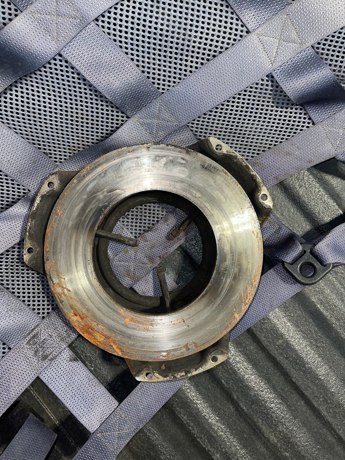

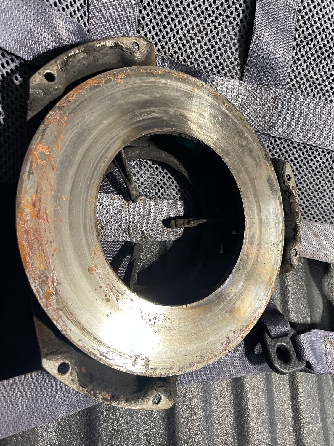

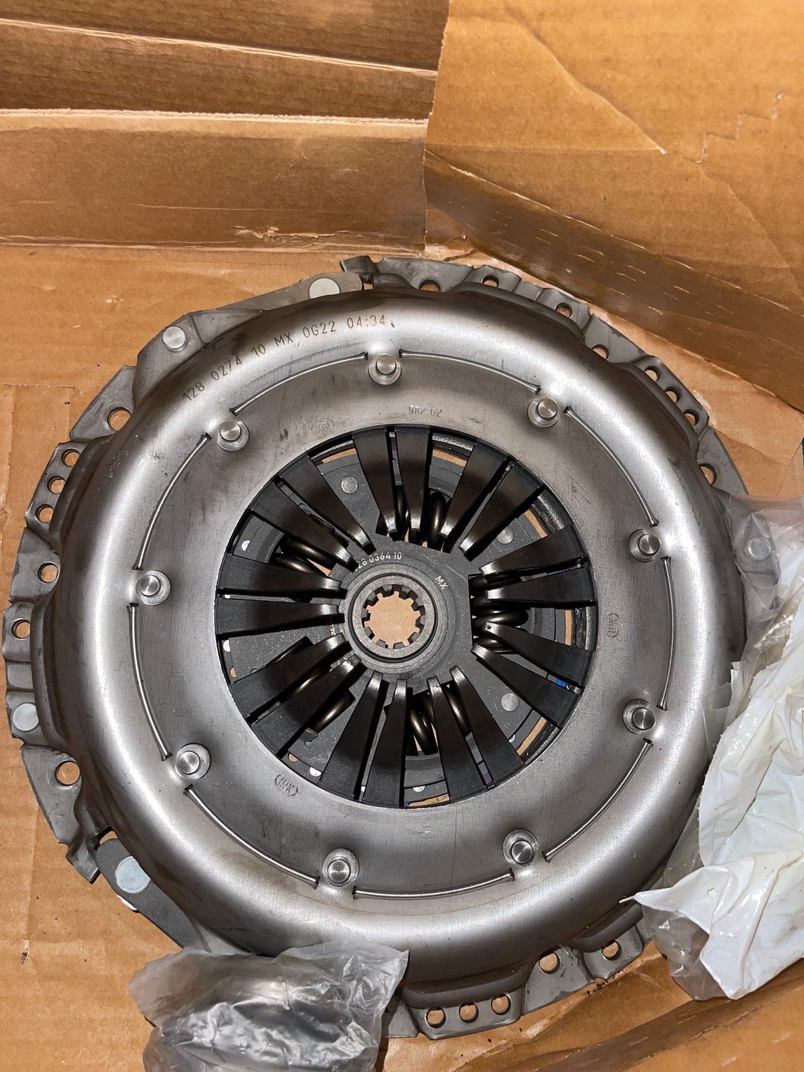

I have a F100 that had a 360 but is now a 390. Someone swapped it out, I went to NAPA to get a clutch but there must be two different ones.
the clean one has less diameter than the old one. Do you guys know was the old one out if a car maybe? The new one was for a truck with a 390 in it. Back to NAPA
The old clutch.
3 fingers on this one.
New truck one.

Ford never used a diaphragm style pressure plate in a FE powered truck or car, also a 360 and 390 use the same 11 inch clutches
The Luk diaphragm style clutch you have will work and normally has a lighter pedal pressure but may not have as much holding power as a lever style
That said most later model vehicles had diaphragm clutches
