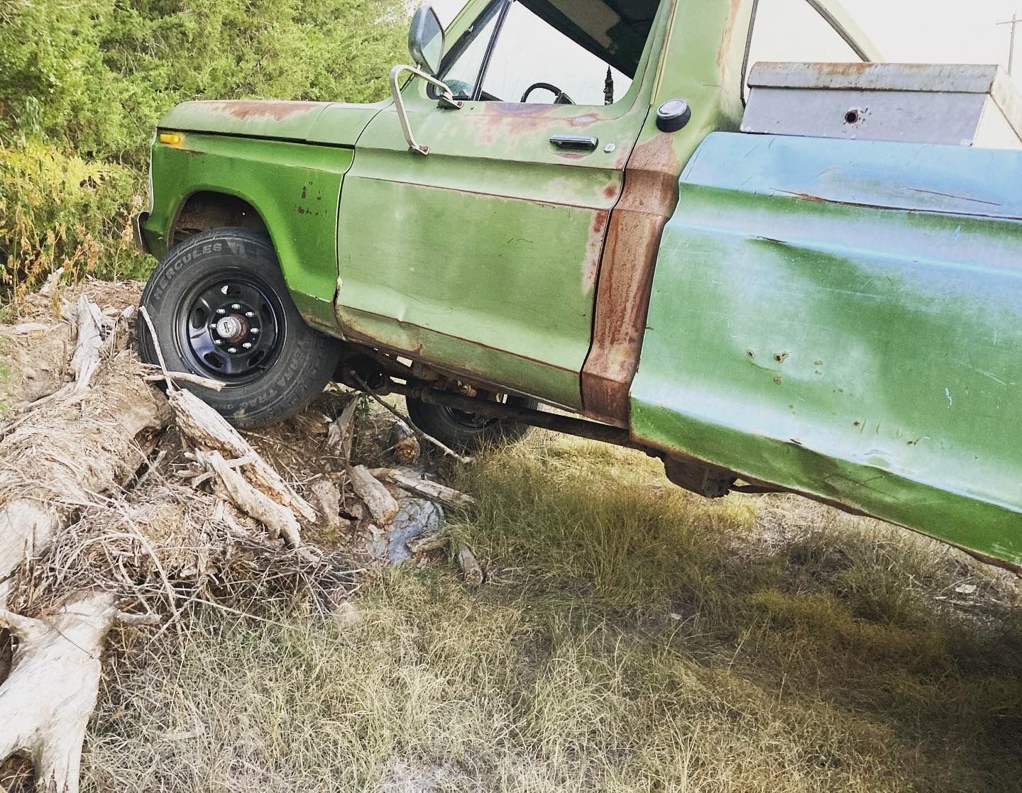

Certain amount of flex is definitely normal. Check out the body lines on my highboy in these pics Actually couldn't open passenger door when I parked there lol

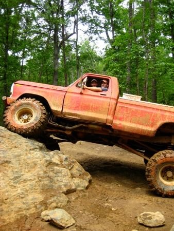

My 1979 F-250 had a lot of flex and I liked it.
Old Apr 5, 2022 | 06:41 PM
77&79F250's Avatar
77&79F250
Moderator & parts slinger
Posts: 50,247
Likes: 5,815
Yes frame flex is normal, the amount Rubiranch is flexing it NOT normal....but awesome. Flexing it to the point the bed hits the cab is going to happen when you over due it. As long as it goes back to normal after flexing it out, drive it. If it stays that way or start to drive crooked or dog legs done the road, time to start inspecting stuff.

Haha you guys put my truck to shame
I guess I need some real tires and find some tricky terrain

Funny, I don't like to even park and leave my trucks in even just a slight twist. I know they flex when the ground is uneven, I know its normal to a degree. I know that the frame does not flex just between bed front and cab back, it flexes the whole length, even where the bed is bolted solidly to it and between cab bushings and core support bushings.
Old Apr 6, 2022 | 01:08 PM
Rubiranch's Avatar
Rubiranch
Joined: Jun 2004
Posts: 4,805
Likes: 3,412
From: South Central Utah
I bought my 79 new in June 1979.
The very first night I had it the bed dented both corners of the cab climbing up a washed out stream.
I didn't know it was normal. 3 of my friends owned F-250 4-wd and none of their beds hit the cab.
I took it back to the dealer and they told me they loosened the bed and pushed it as far back at they could.
I don't think they did anything.
First snow storm I was up a canyon and there was another 79 F-250 stuck in the snow so we stopped to help.
I noticed his cab corners were dented by the bed too. What did his truck and my truck have in common??
They were both Camper Specials. What made them different from the others??
Front and rear SWAYBARS!! Mine came off the next day.
I put masking tape in the dents and hit the trails, no more hitting.
I took it back to the dealer and didn't tell them what I did but I wanted the dents in the cab fixed under warrantee.
They fixed the dents, painted the repairs and replaced the moldings.
After a while the bed hit the cab again. The flex in the frame and suspension was awesome.
Amazing articulation from a F-250. I never had an issue with the frame.
I bought that truck specifically to take off road.
