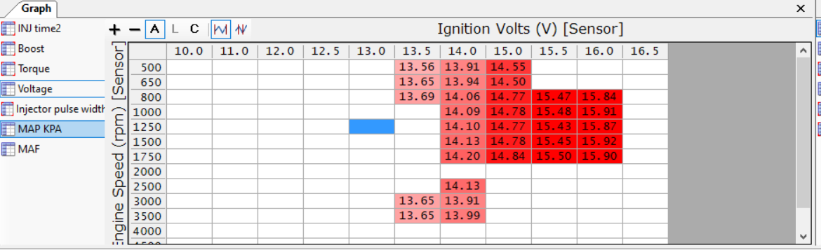

Here's a graph. The reference line is 650. So call it 600's. My buddies told me I'm not allowed to say 'datalog' anymore or they'll punch me. hahaha.
