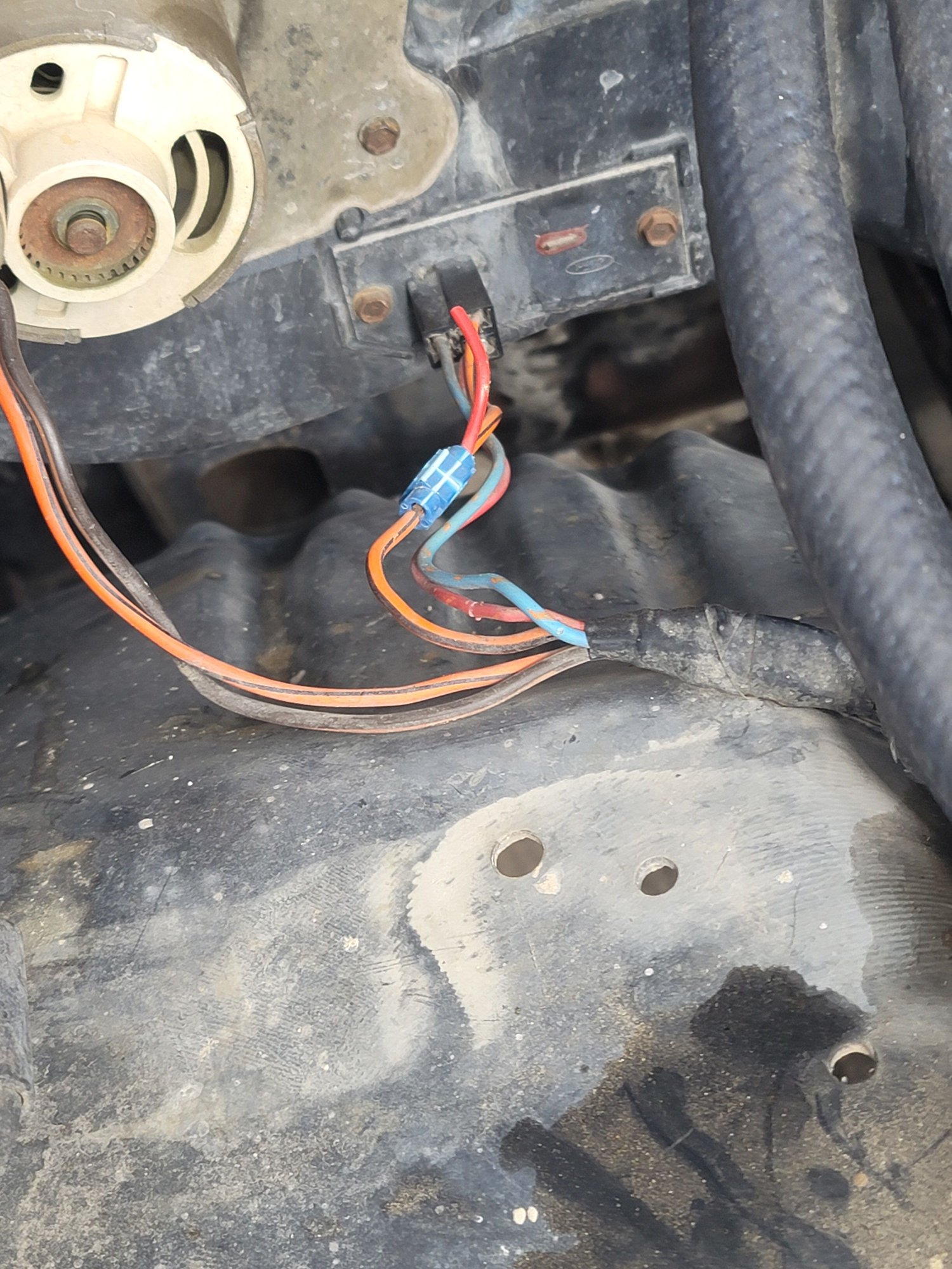

These are the wires/plugs in question this truck is very basic feature wise

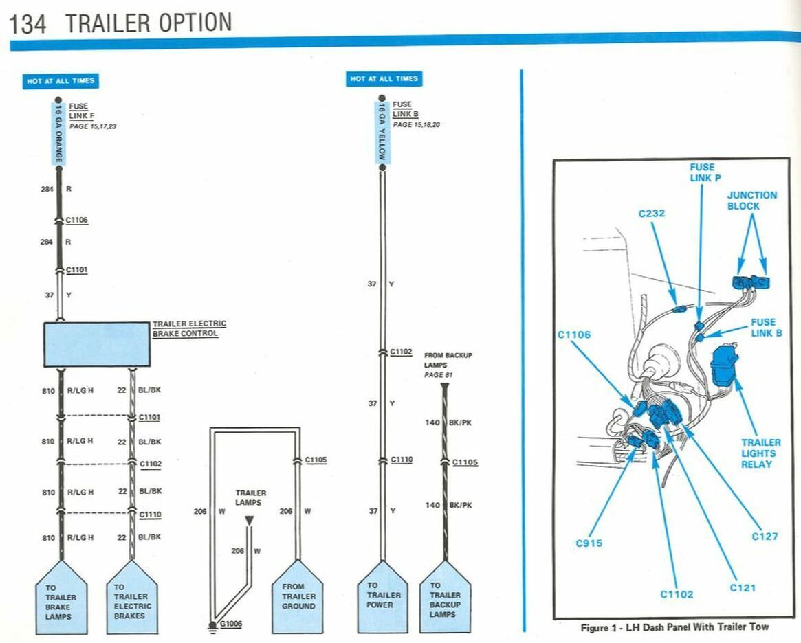

One of those relays looks like a trailer lights relay.

That is a aftermarket wire tap. Did this truck have add-on dealer A/C at one time?
There's no ac what so ever
