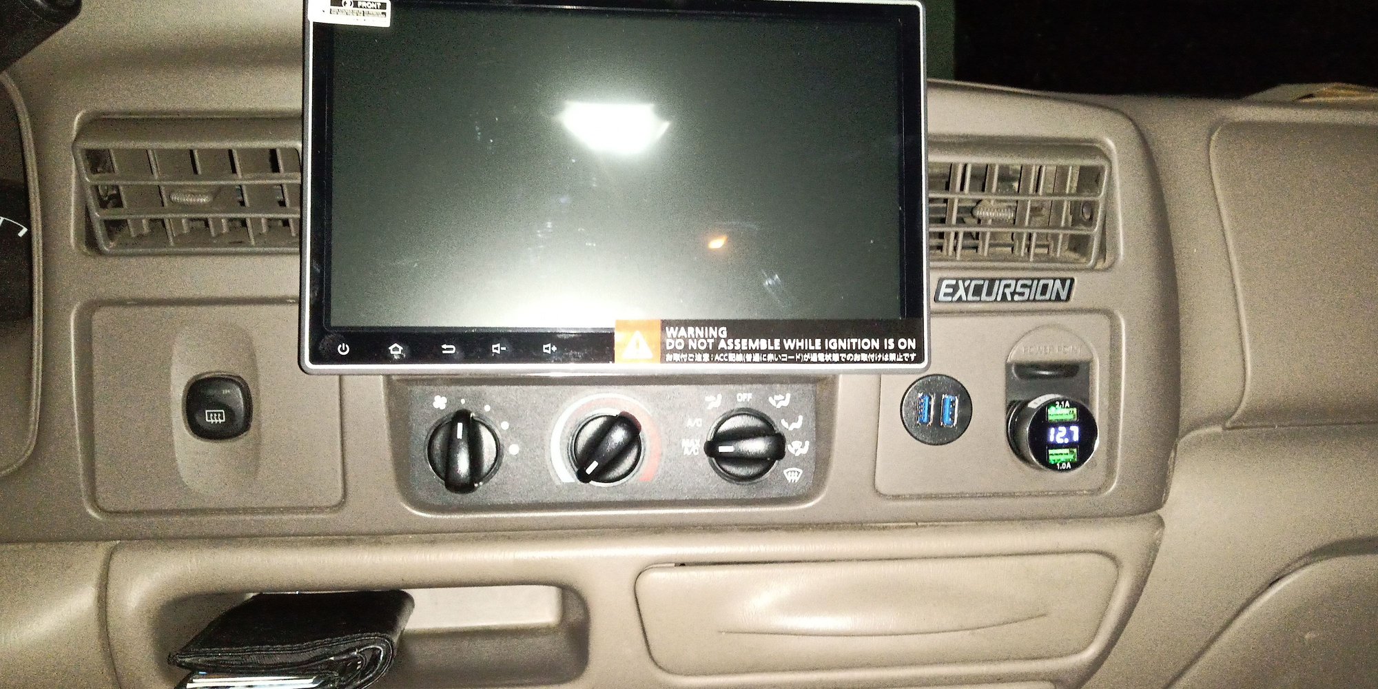

Has anyone put one of these in? (ok I know it's been done) What type and tricks did you use?

simple, The XTRONS 10 inch option fits the Computer portion in the double din slot, while the touchscreen sits out in front of it slightly, it fits perfectly in the excursion, almost like the radio was built for this kind of install, you do have to dremel the lip at the top of the radio opening of the dash bezel like a 1/4 or 1/8 of an inch to make it proper double din dimensions.
Does not block the A/C vents or controls, come right up to them almost like a glove. the 2 blue USB ports are connected to the back of it so i get 2 usable USB ports to plug in phones, flash drives, etc, to load media to the head unit, etc, the third rear usb is connected to my OBDLink EX for torque pro.
This is the new version of mine, it has a Octa core instead of a quad core, so a boost in CPU.
https://xtrons.com/universal-single-...gb-rom-tma105s
Oh and the screen flips down to reveal a DVD player, flip the screen down slightly, slide in a disk and flip it back up. It is android 10.

Another note, in the pics, mine is sitting closer to the driver because i did that on purpose, and angled it slightly towards the driver just out of personal preference.
You can actually push it back closer to the dash if you choose, Im a 6'5 guy though and sit with the seat all the way back to the track stops, so i brought it out a little bit towards me.
