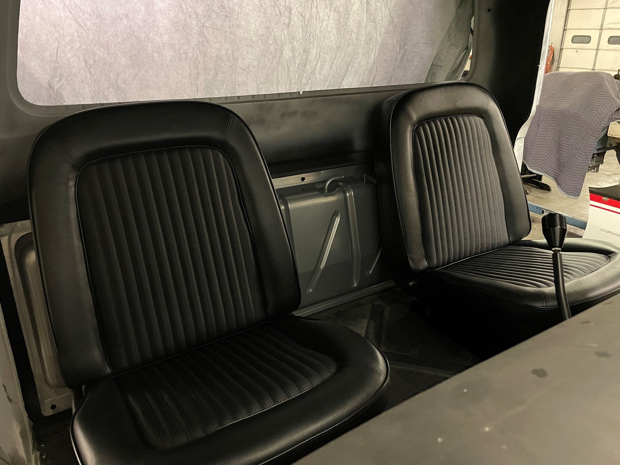

I reupholstered a set of buckets for my 68 F250 4x4.
Seat Foam, Listing Rods, Black Deluxe Covers, Burlap, Hog Rings, Pliers will cost you almost $800.00 without shipping. Stripping the seats, and paint, another $100.00 so you are at $900.00 before you take it to someone to do the work. I purchased everything from NPD. I did the reupholster work myself to save money but its not easy and takes hours of labor, especially if you had never done any of this work like me. I think turned out nice. Here are two shots when I test fit them back in the cab.

Those seats look nice. I have a set of those as well that I think I am going to use till I find a bench seat that I want.

Yes! Great job on the upholstering, was it a fun project?
I have done a few do-it-yourself jobs, not too difficult, right?

Thanks. No, not too difficult, read a few articles, watch a few videos and just take your time. Sunny days help as well to get a lot of the creases out. After I took them back out I set them in the sun for a few minutes to heat up the vinyl and you can work with the cover easier.

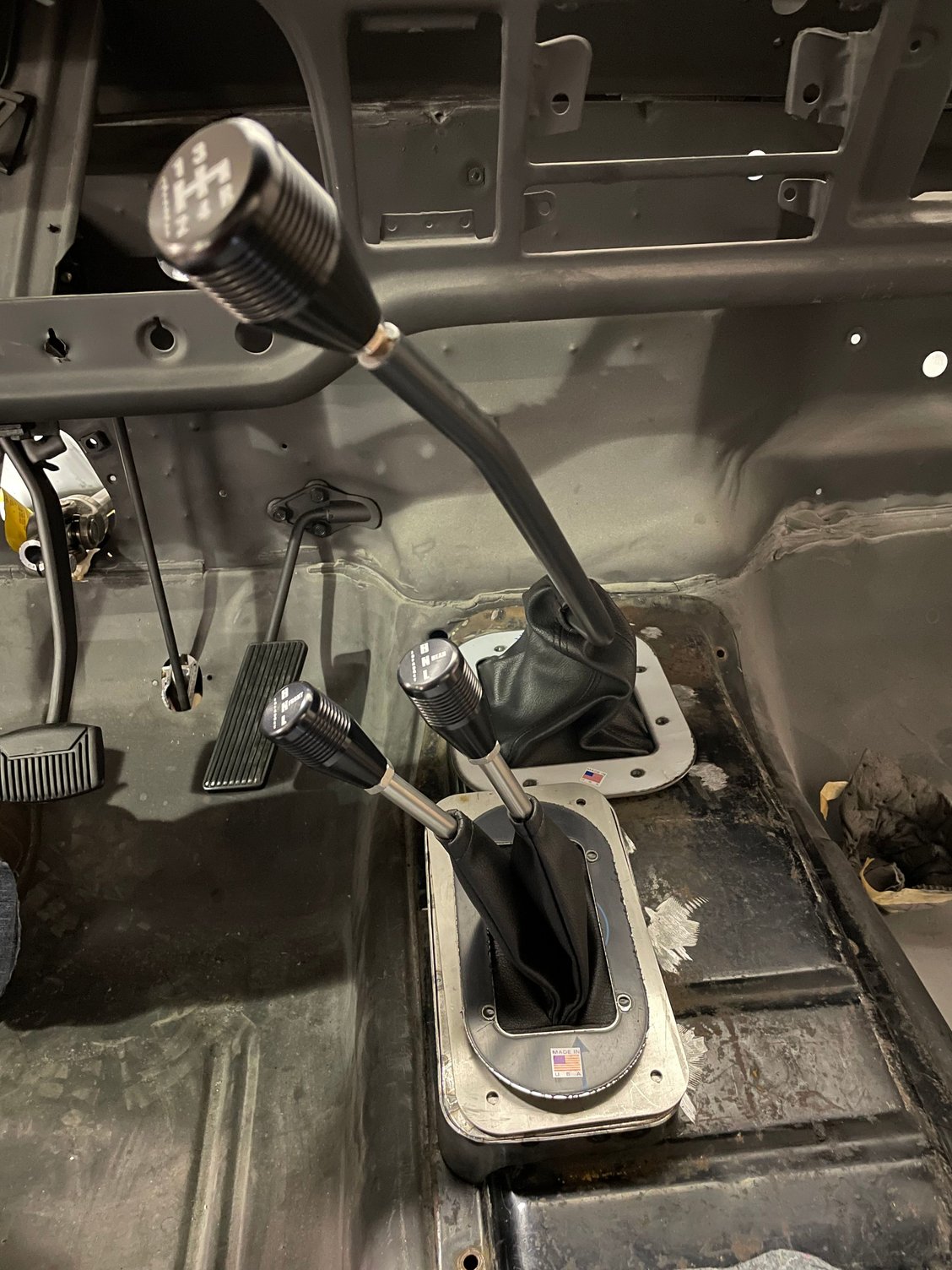

Your interior looks nice. What are those bezels/rubber boots on your transmission and t-case?

The shifter boots with stainless trim ring and vinyl covers are USA Made from JB Custom Fab as is the twin stick shifter sticks, shift housing and cables. One boot is for the NP435 and the other is for the twin stick set up that I added for my NP205. I did have to make a small perch to lift the twin shifter assembly, hidden under the tunnel cover, up to clear the transmission but it all fits up nice. I attached a some better pictures of the set up, but it still needs to be final welded fitted before paint, sound deadener and carpet. Everything is an easy reach doesn't bother your right leg sitting in the seat.
Link for shifter assembly.
https://jb-custom-fabrication.myshop...05-buggy-style
Link for Trans shifter boot.
https://jb-custom-fabrication.myshop...t-transmission
Link for Twin Stick Boot
https://jb-custom-fabrication.myshop...-stick-p-n-tsb
