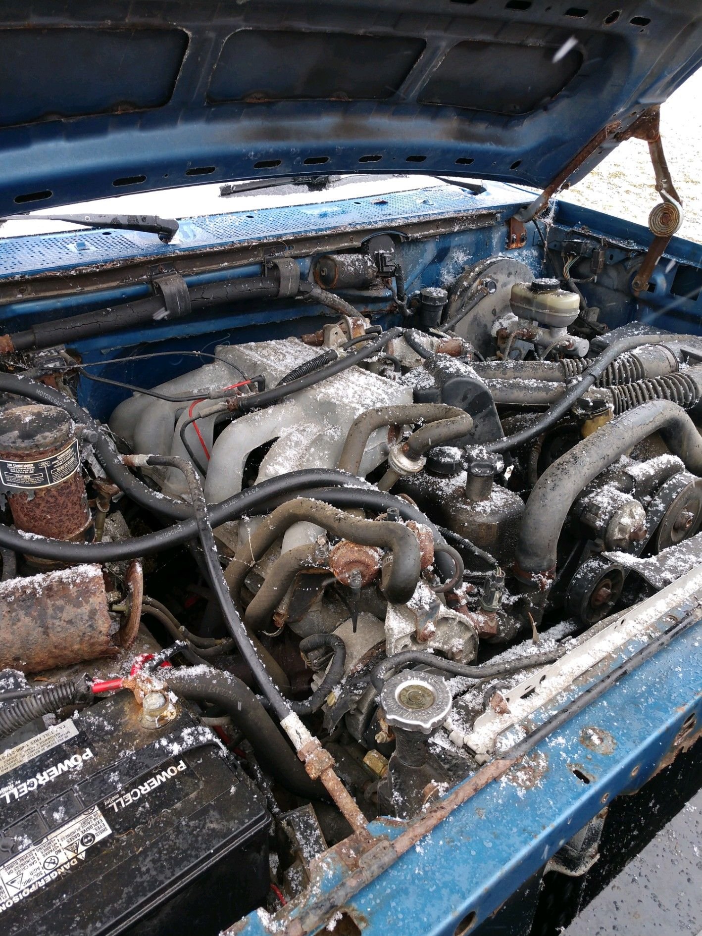

This is the animal in question. Looks like its set up slightly different than my 5.8 in my 96.

It is a 1995 or older F150. There are twin intake tubes therefore it is Speed Density that covers the 1995 and earlier models. I also see the OBD-I diagnostic test port by the driver side hood hinge. 1996 model year F150s would be OBD-II and MAF.
