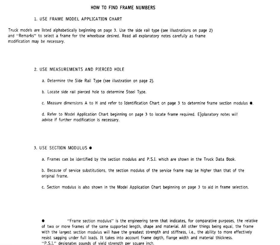

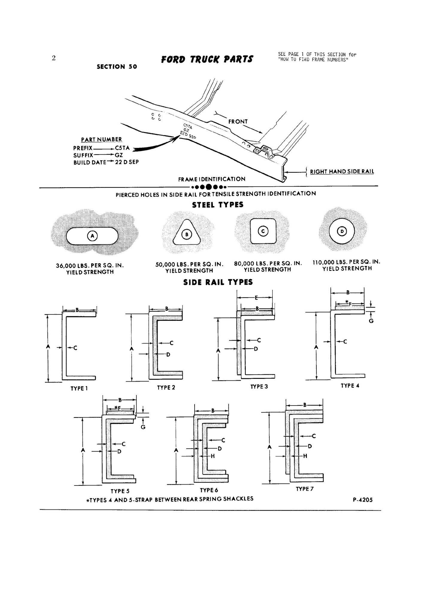

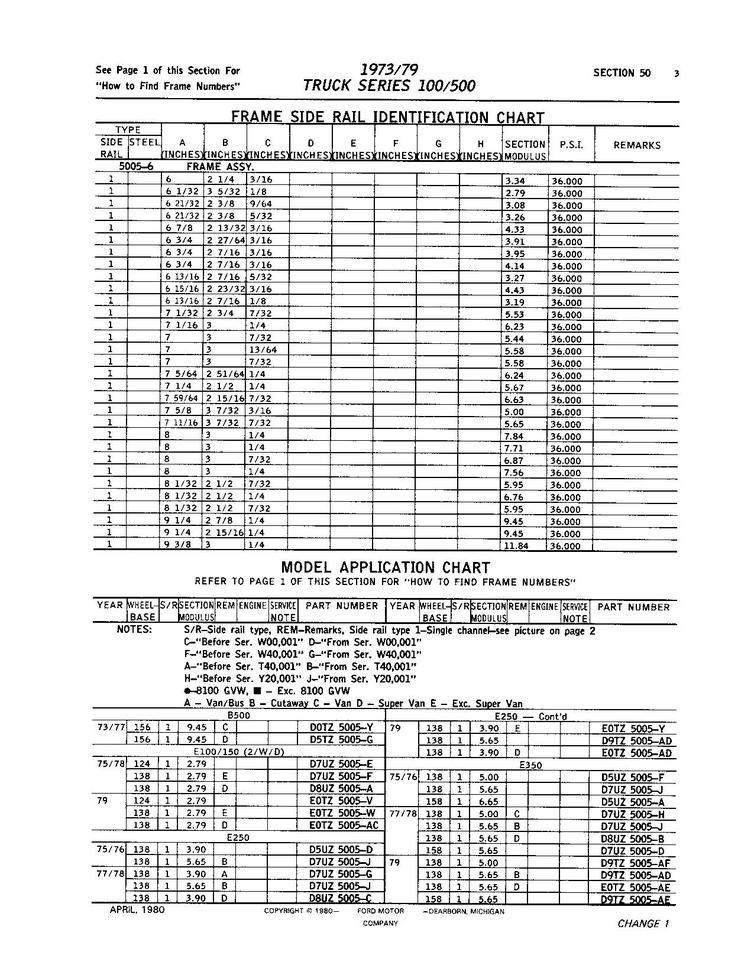

Frame specs
Thanks for that info but the post I was looking for was a spec sheet that showed all the measurements of the frames from 73 I think to at least 79. It was quite a long post with all the specs on frame sizes of different years.
