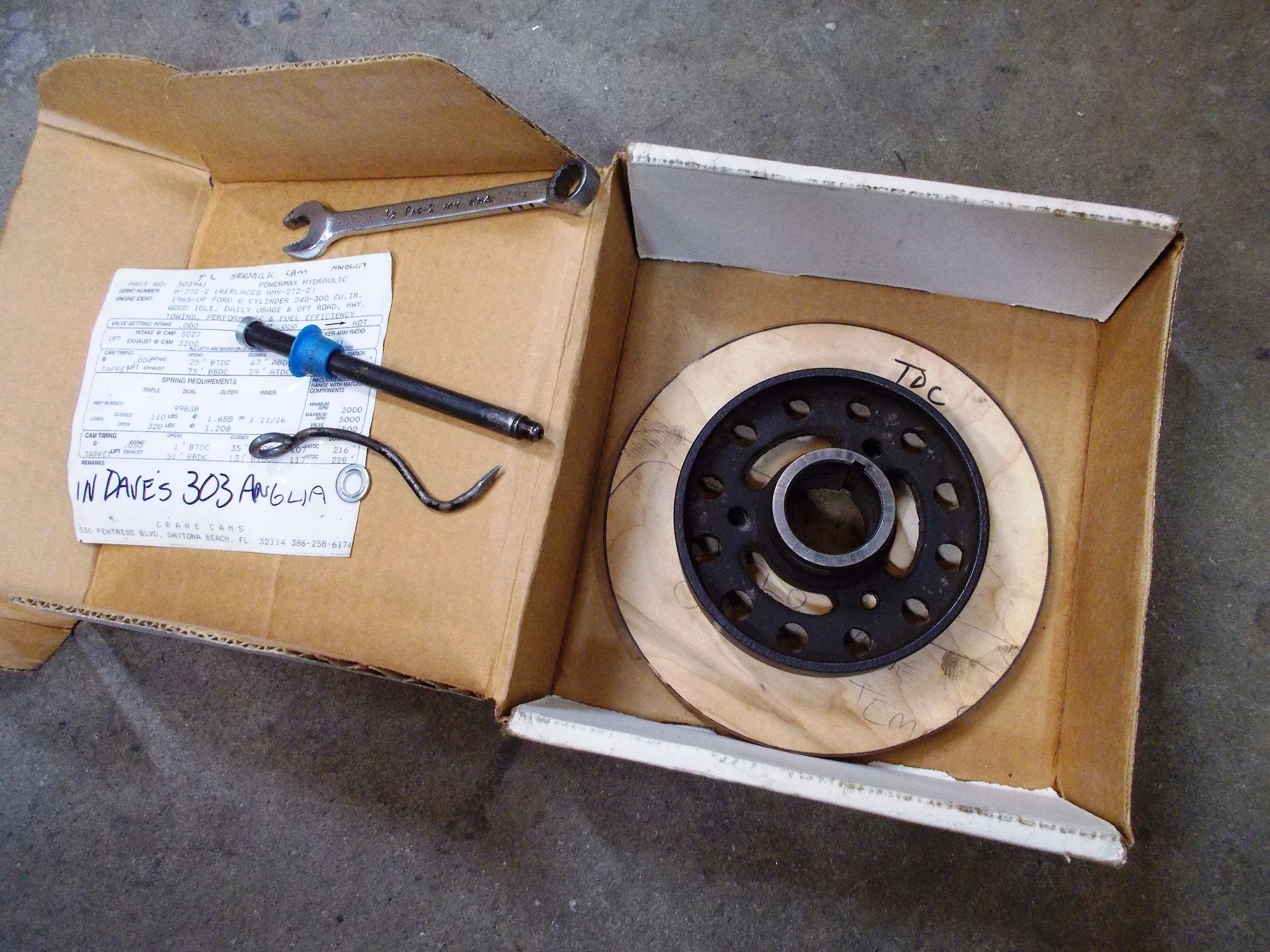

I don't think you will need a ring as big as 18". I use a smaller one fitted to the hub of an old damper. Works fine. Of equal importance is a securely mounted pointer that has a definite point on it and stays put.
Hi The Frenchtown Flyer,
I was wondering if the 18" mite be excessive but figured since I have a big block and 3 inline six engines if I found the best with the hubs connections for all It might pass as the only one needed in my tool box.
I thought the larger the more accurate it might be.
You are in my eyes aswell as a great many others a the inline six master so I will learn.
Why did you put wood behind it as pictured in the last photo? Just curious.

The degree wheel - Ford Engineering issued - is just a flat plate so I affixed it to a piece of 1/4 plywood to make it a little easier to mount precisely to a hub. They are used by engineering in several applications where precise measurement of an arc is important. I had to bore the center hole and drill the three mounting places.
By all means if you have several engines to work on a big professional wheel would make a nice tool addition to your tool box.
