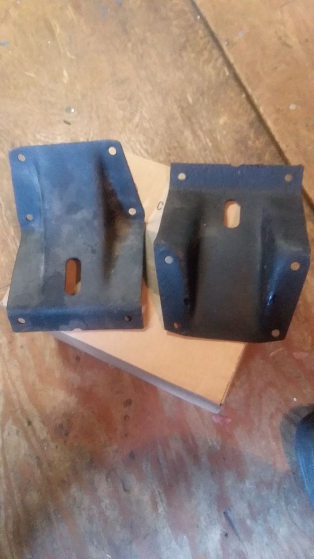

Got these with 1955 Ford F-100 in boxes where do they go, might be for a 1956 Ford F-100 ? ?--- Thanks

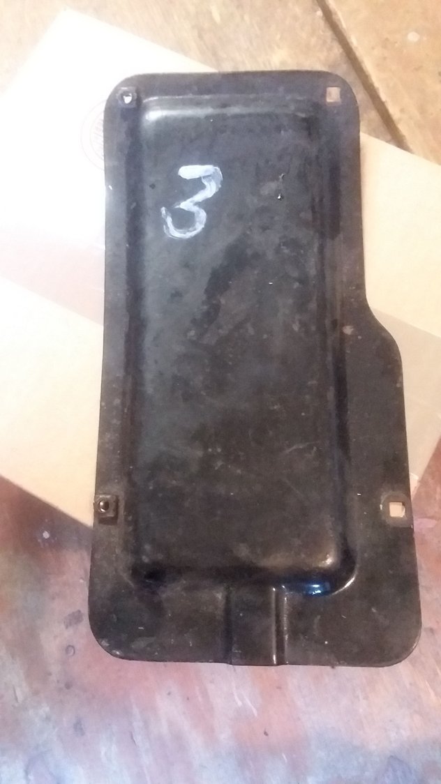

Pic 3: That covers the louvers from the inside on the passenger side cowl if you have no heater or the recirculating heater. There should be a gasket to help seal out air. I think reproduction seals are made.

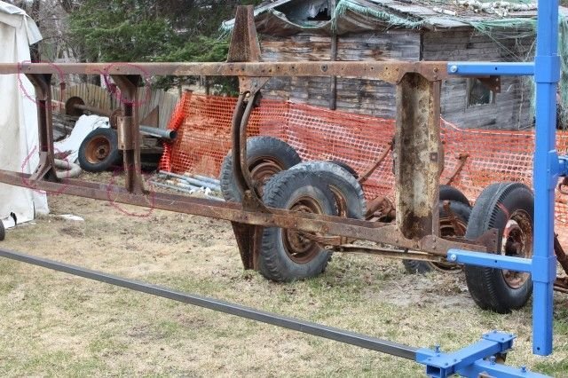

Top two are the under brackets of the frame cross member that is located at front leaf spring perches,

#3 as abe described above

Well done, John! I knew number two looked familiar. I've only seen pics of those on the internet.

This is my M350 frame but the red circled areas is where those brackets go ,
