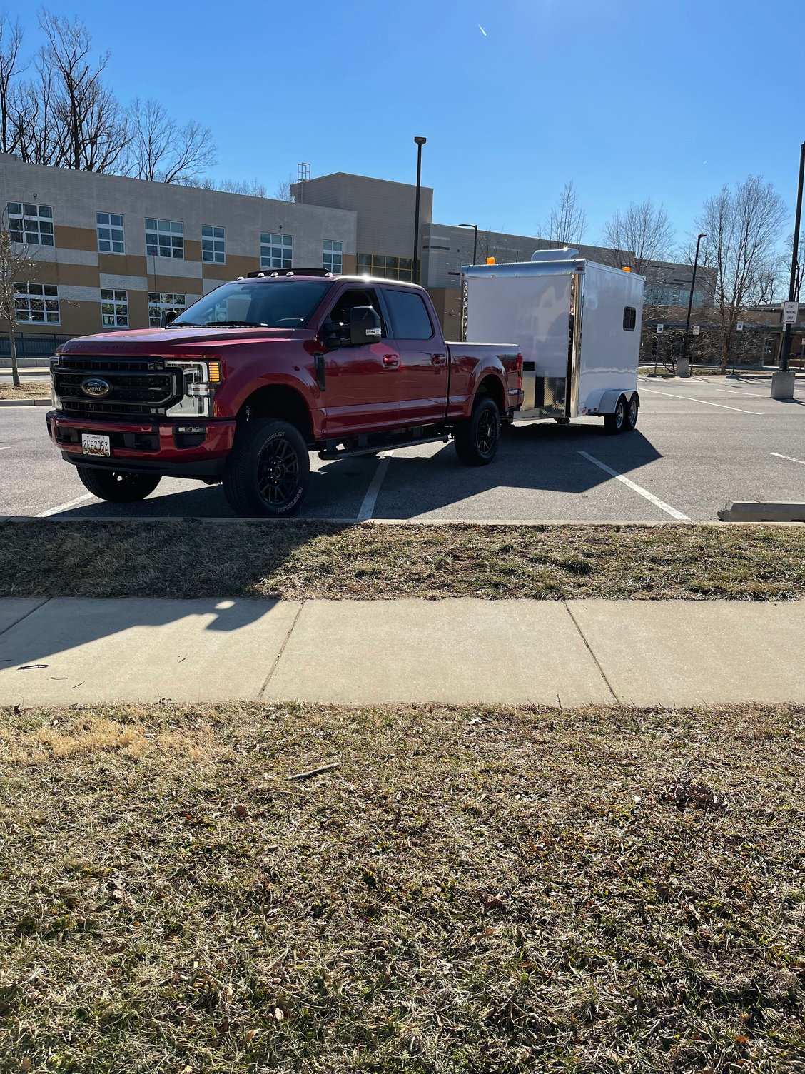

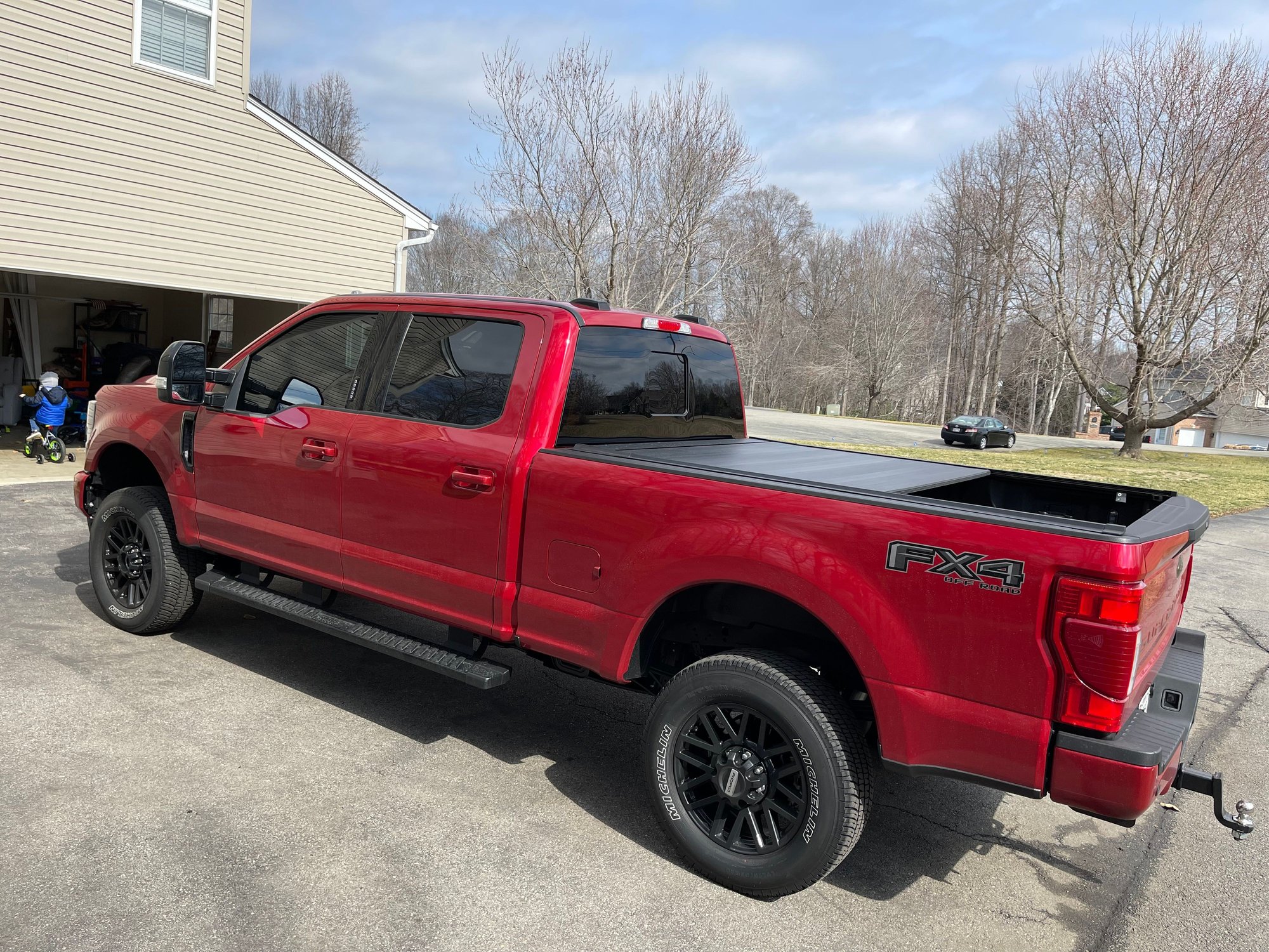

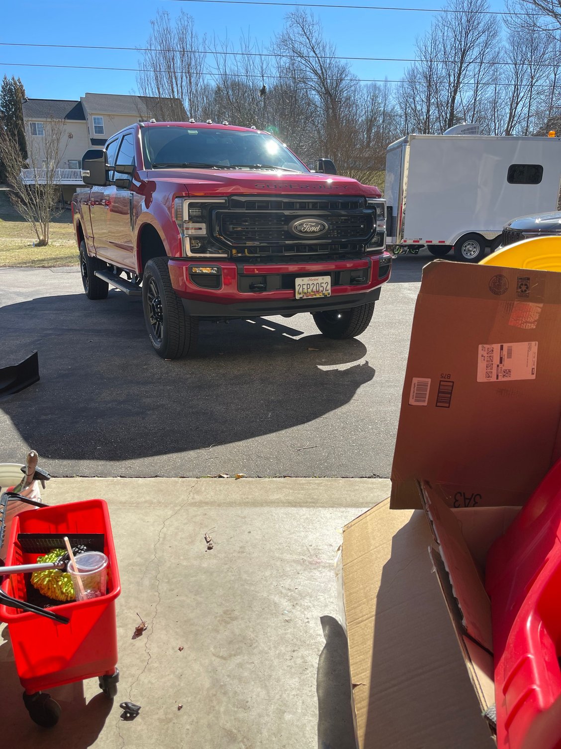

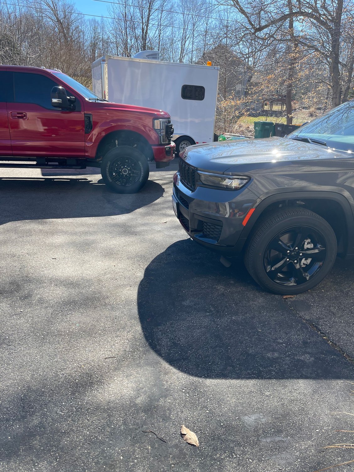

I leveled mine and tow every day with the truck. No complaints….and yes I leveled mine because I like the look.
BUT I didn’t totally level the truck. I did 2” up front and then raised the rear about 1” with a taller block since my ‘21 came lower than previous 17+ trucks from the start. So it took some of the rake out but not all of it and it sits a little higher like I prefer since the truck does some minor off road driving. Not rock crawling but the added clearance isn’t a bad thing for me.
the moral of the story is do what you want with your truck. It is yours after all and if you’re like me you get bored and like messing with things. It’s not as horrible as some of the above posts make it out to be and my truck does absolutely everything it was intended to do from the factory.
Just keep in mind if you go much higher than 2” you’ll definitely want a taller tires to fill those wheel wells. Which I think looks great. These trucks look awesome with around 3” of lift and 295 tires. Which will likely be what replaces my stock Michelins.
now if you are max towing frequently then I agree just leave it alone but most of us aren’t if we’re being honest.
