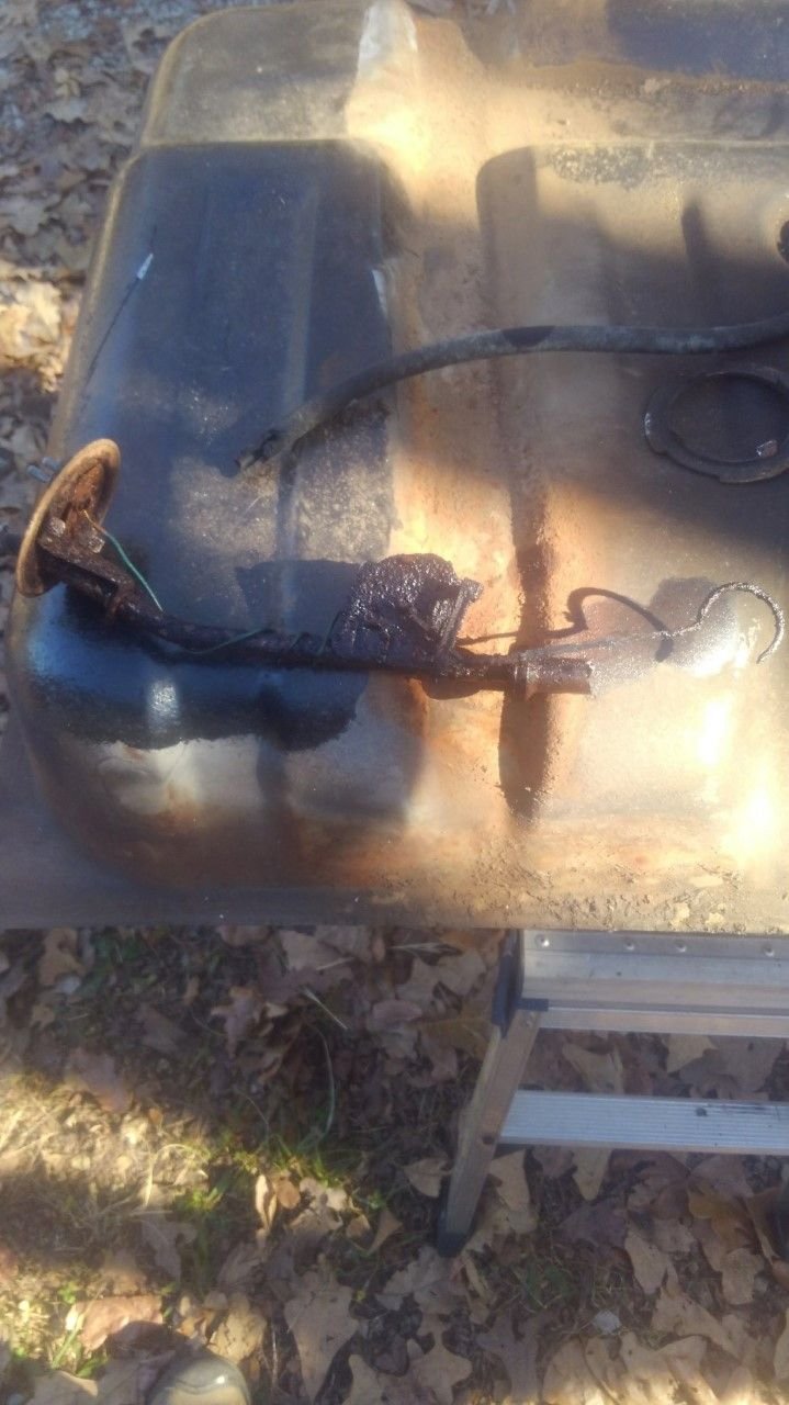

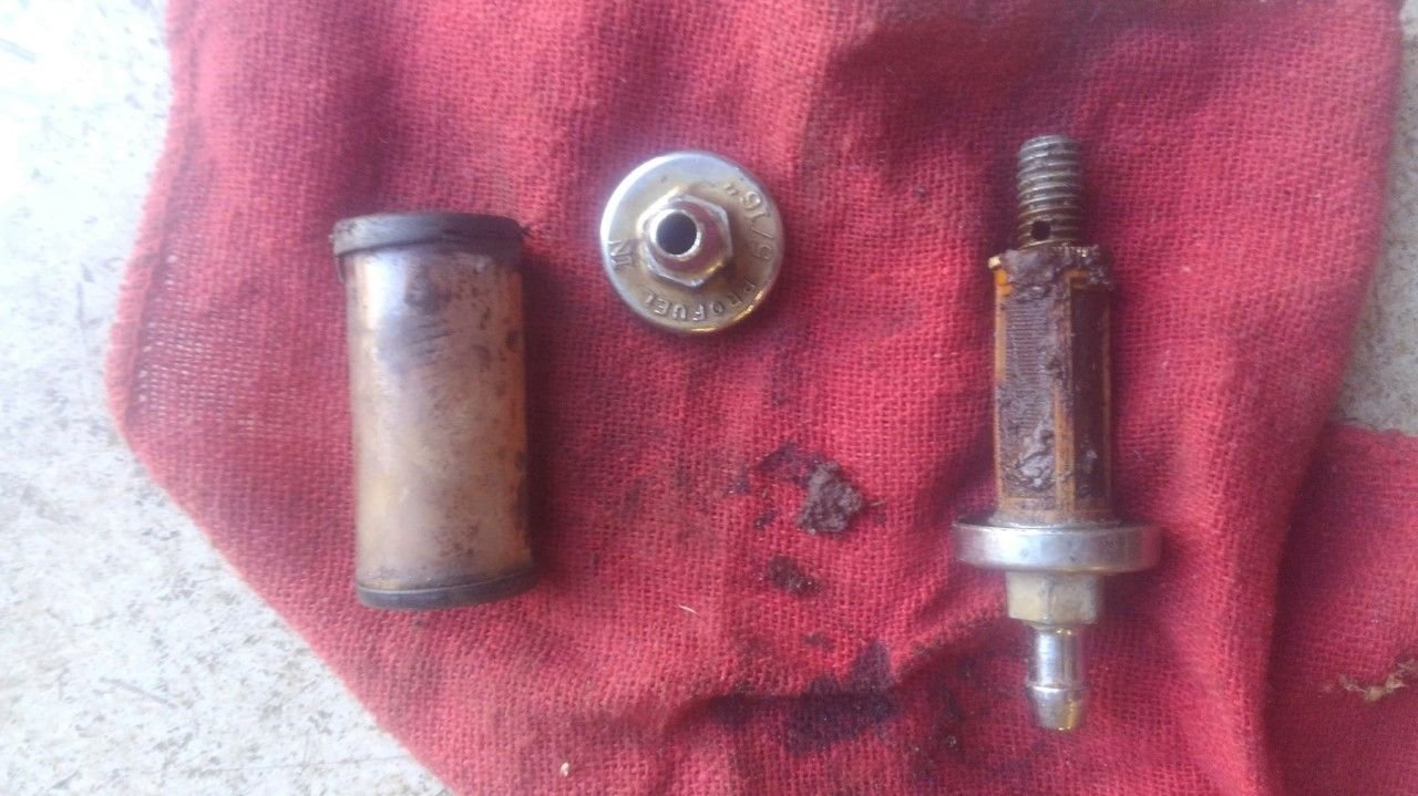

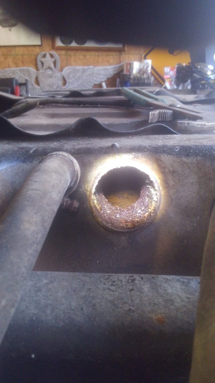

You mean bypass the tank and feed the fuel pump from new gas in a can? Or dump the new gas in tank as-is? Yes to former but No DO NOT do the latter. You are asking for trouble. Drain the tank by removing it and dumping/flushing. Blow the line out between tank and fuel pump. Install new filter then put fresh gas in it and hope carb is not gunked up. Highboys had a filter under the floor below tank. I'd also add an inline filter right before carb until you run it for awhile.
If it was me I'd open top of carb and see what it looks like. Sometimes they are clean and dry but other times they are plagued with nastiness.

If you want more to do alot more work, get new high grade headaches and learn how to do "carb rebuild 101" at least 3 or 4 times, then run that old gas. Other wise x2 drop the tank clean it out, air blow and fresh gas flush all the lines. What ever nasty is in the tank will go right in the carb jets.
