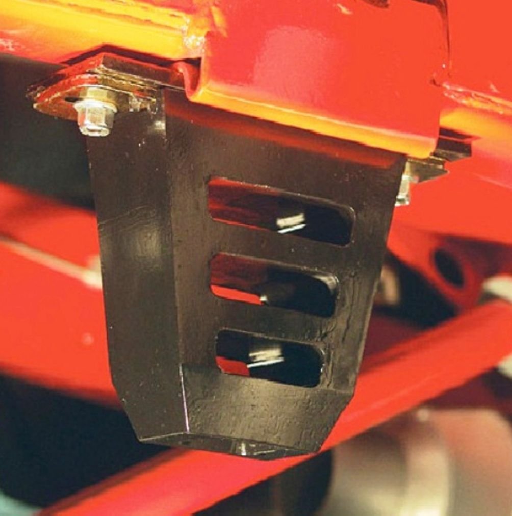

pirate4x4_camo's Avatar
pirate4x4_camo
Joined: Apr 2011
Posts: 8,259
Likes: 346
From: Northern California
Originally Posted by uwaidye
Ok thanks. I almost bought the Energy Suspension Rear bump stops for my Procomp 22415 springs with PMF top plate with tang. I'll look into the Doorman
you can use poly in the rear as long as they are this design not solid.
