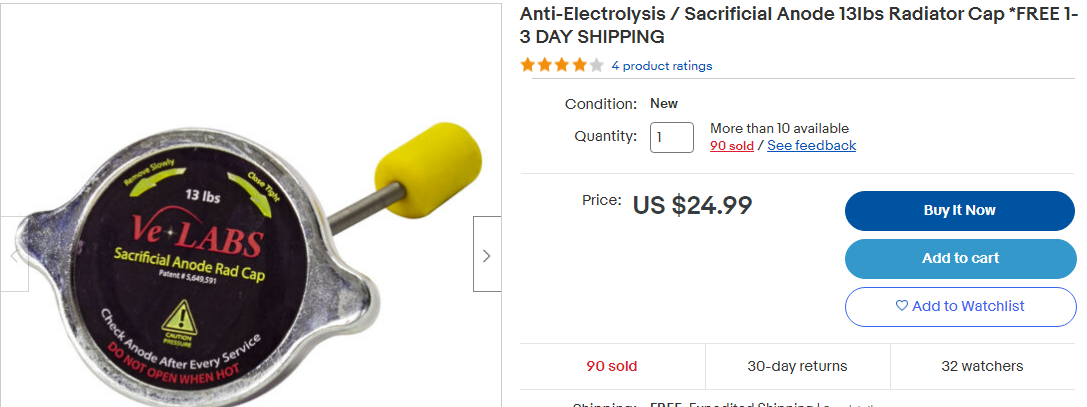

My friend had an electrolysis issue on his 95 4.9 that destroyed heater cores and radiators. The solution was an additive from Ford for 7.3 PSD.

Good to know, Scndsin posted the radiator cap that done that.
Originally Posted by jtab
Each radiator has come with a cap.
maybe caps are wrong pressure, is leak in same place/area each time.
