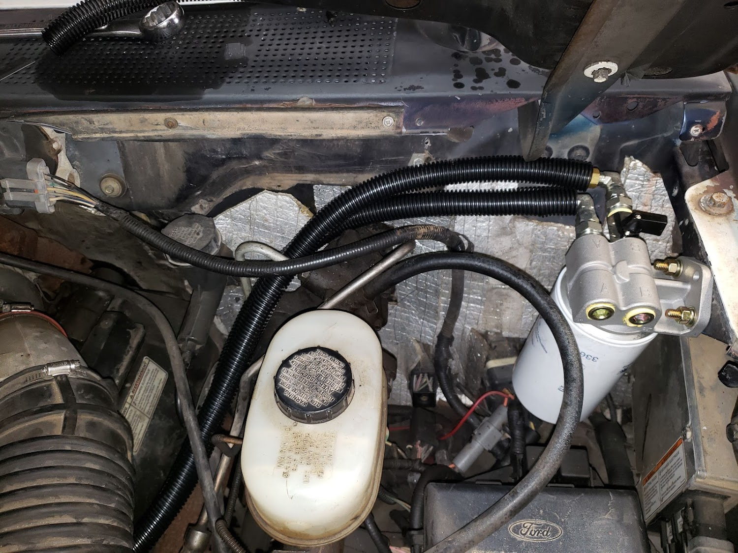

Is 62-63 alright at idle? I don't have a way right now to check under any other conditions. I expect it's enough but is it too much? I deleted the fuel bowl so I can adjust it. No tunes, stock injectors (for now )
EDIT: So the behavior is very different from cold to warmed up. The original question still stands but check out this difference in fuel pressure from cold to hot (video below). Cold the engine runs smooth and feels like it drives normally, hot it runs pretty rough and with fairly noticeable vibrations that you could call better or worse at different RPMs and a little unsettling to drive. Fuel level is above half way.

I changed it several months back because the fuel bowl was falling apart, and I prefer not having it clutter the valley. This is a standard regulated return configuration so it's measured on the pressure side.
I have replaced the injector orings and the high pressure hoses, but I haven't done the hpop.

Yes, it's a spin on canister style now since doing the fuel bowl delete July last year. There has been very little time on the filter since it was installed though, maybe 10 hours? Still trying got get the truck up and going.
