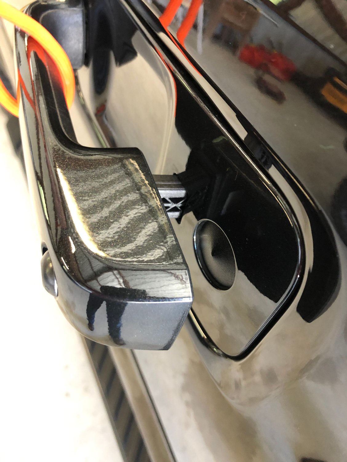

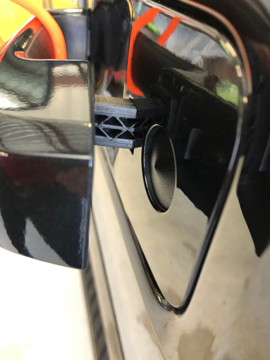

If you want to do this cheap, you will need a washer large enough to cover the lock cylinder opening, a bolt, nut and another washer for the backside. The Jimmy Jammer comes with a little black metal plug for the hole. and a smaller one for the lock hole on the handle itself. The small one is only for aesthetics. I put a black hex nut there for visual deterrence.

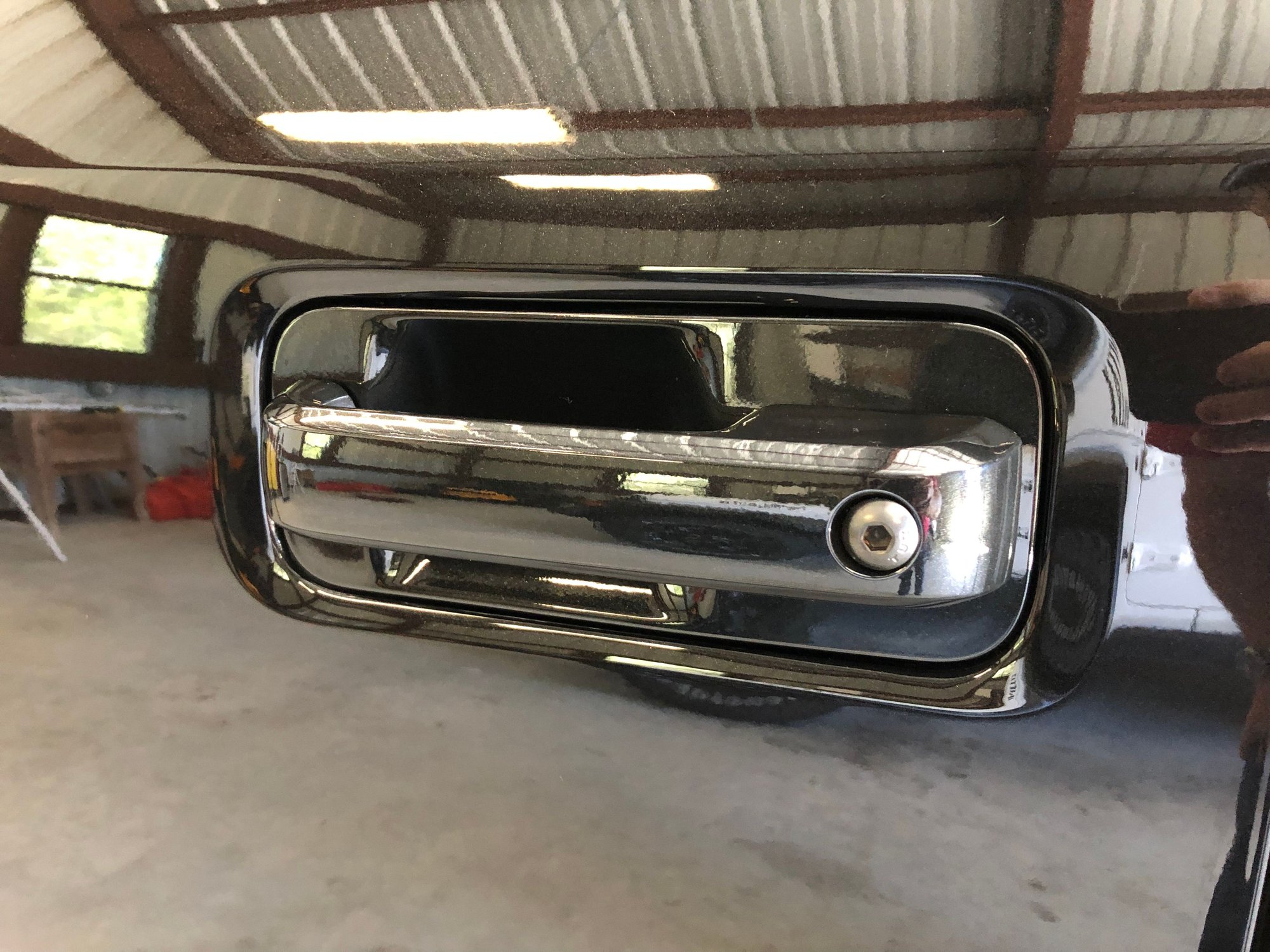

End results
removed items

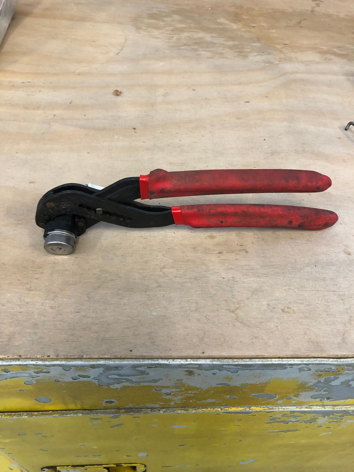

Just to show how easy it is to grab with pliers
